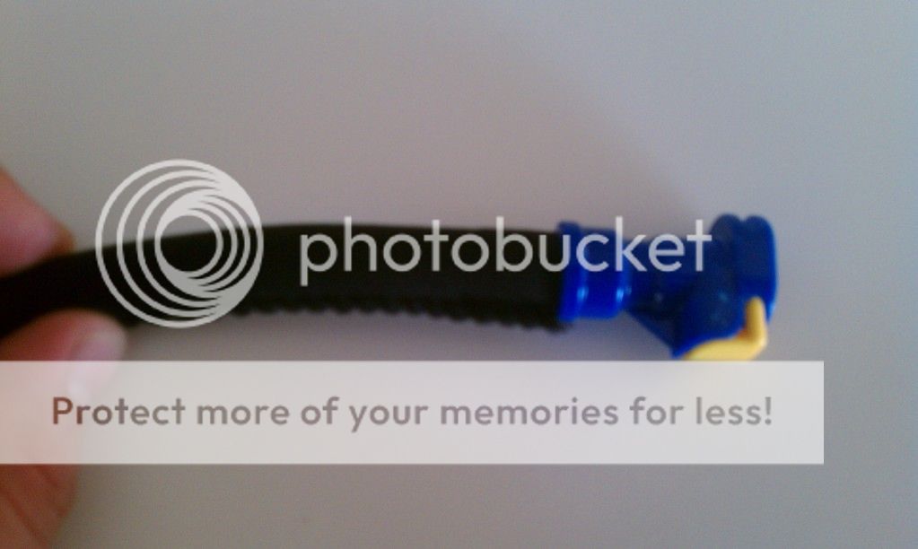

Do a little bit of research and find the Camelbak Quick Link Conversion Kit that make linking filters, adapters and other cool little gadgets a breeze. The wheels start turning and I get the idea of what I am going for.
The parts:
  1. Exo-1000 or similar helmet
  2. Camelbak, preferably with a 90 degree bite valve
  3. Camelbak quick link conversion kit($10-$13 at serious sporting goods stores)
  4. Hacksaw/dremel(optional)
  5. Awesomeness
The plan:
Measure and cut the length of hose I need for inside the helmet, use the quick link kit to connect the hose in the helmet to the hose coming from the camelbak and profit. It wasn't quite that easy, but without further adieu... the build.

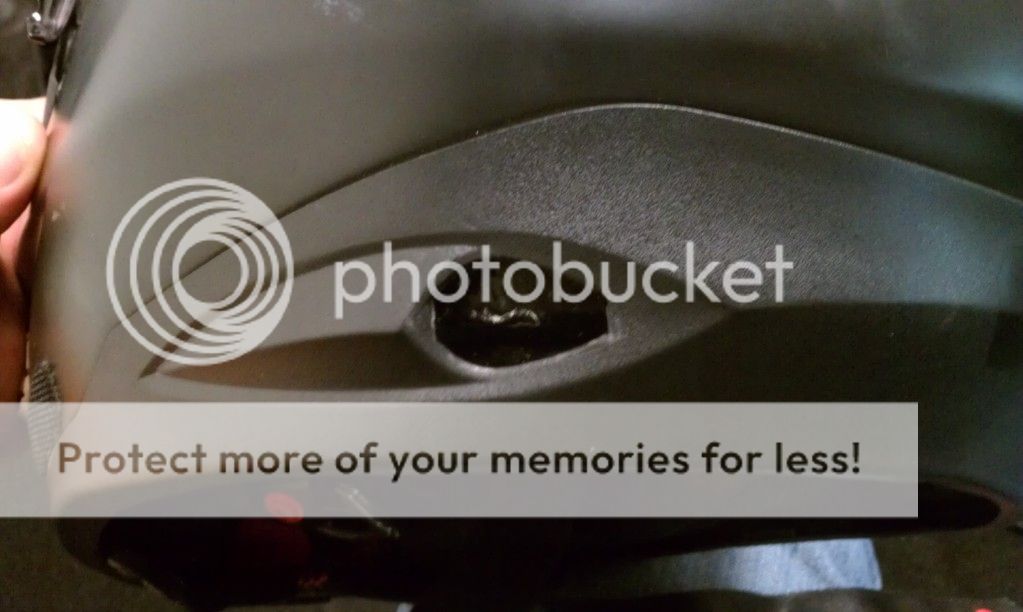

  2. Pop the Venturi vent (on whatever side you want, I went with left) out of the shell. It's not in there tight at all and that part of the shell is pretty flexible.

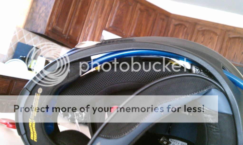

  3. Feed the hose through the vent opening, above where the roller will go but underneath the cheek pad.

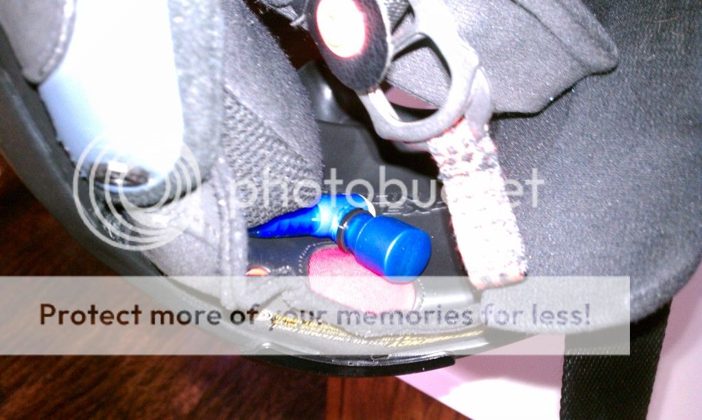

  4. Check the placement of the bite valve behind the chin bar. I did this several times. I was lucky and had two hoses, but I wanted to be certain my first one was a go. I also shortened the bite valve on the valve side of the 90 degree bend. Took off roughly 1/2" this way it hangs freely without digging into your chin.
  5. At this point, I marked where I thought the hose would be cut and pulled it through the viewing port until the end of the hose was near the rear vent opening. I put the male adapter from the conversion kit on the end of the hose and made sure I could use the adapter without issue(with and without gloves). Since I was certain I was good, I cut the hose where I had marked it off and added the male adapter and put all of the pads in nice and tight
    (dunno what happened to the pic, but you get the idea)
  6. With the helmet side done, I threw the female adapter from the conversion kit on the end of the hose coming from my Camelbak
  7. Threw the helmet, gloves and bag on and voila.

I had to drill out the hole about 30%. It's tricky too, too slow and you'll split the vent into two pieces.
