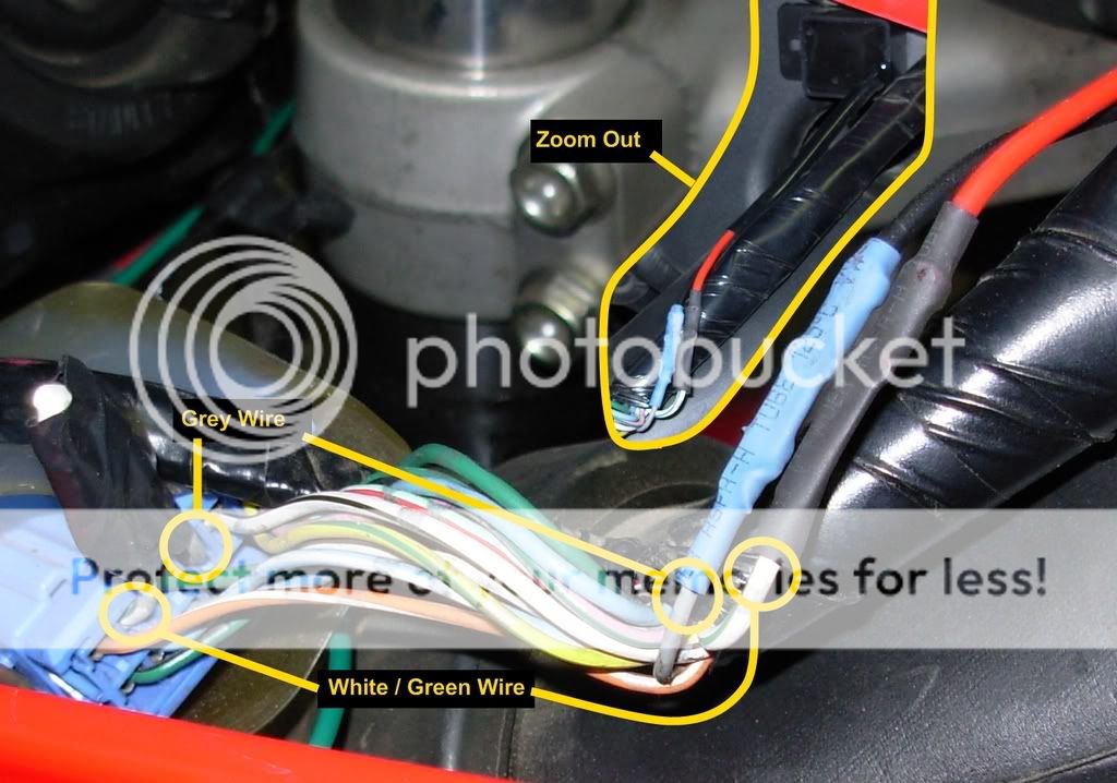

I ordered the LED Relay switch from customled.com($15~ish?) I noticed the wiring harness was pretty well bundled up and didn't want to crack it open and splice the wires so I pulled out the wires on the relay from the connector by pushing a small lock pin inside. Once out I Heat shrinked some of the exposed area just so it doesn't short w/ anything else exposed and then stuck them inside the wiring harness where the green/white wire and gray wires are. Then I taped each relay wire to the harness wire so it wouldn't move or pull out. At the time I only had my intergrated tail light turn signals and they blinked normally so i'm pretty sure fairing turn signals added to the rest of the circuit will work just fine as well. No wires spliced :)
Relay wire pulled from connector and heat shrinked
Relay wire inserted into wire harness connector(dont think it matters which one goes where)
Relay wires taped down w/ elec. tape with harness wires
doublesided tape or velcro down to frame under wire harness

For anybody having problems with this, here is a picture of how my '03 is wired with the customLED relay.
Sorry. Your picture is probably perfect to understand for normal people, but I can't quite understand what you are really doing right there. So you basically spliced the black and red wires from the relay to the white/green and grey? correct me if im wrong :P.
Basically, but for some reason to get it working on my bike I had to also cut the wires coming from the plug.

Ok, so today i got the relay to work. Basically what i did was splice the red and black wires to the two wires mentioned and it worked perfectly. Simple thing to do. Thanks for all the help.

Ordered the relay and going to do this I still don't understand how the green/white and gray wires can be cut and capped on the plug side without stopping the connection but I'm an electrical nube. Nice write up though.

The green/white and gray wires on the plug side go to the bikes relay by cutting them and splicing your replacing bikes relay with LED relay..
That would make sense to me if the LED relay was connected to the plug side wires but that cartoon diagram shows the LED relay connected to the side where the wires go into the bike. So how is the LED relay working if the original relay is going toward the plug side. Thanks for the help I a not so smart. Also were is the original relay.

ok guys. i figured it out. if your front ones stay on, you have to switch the wires from the relay around. the red wire must go to the white/green and the black to the gray wire. it will not work any other way.

I am pretty anil when it comes to cutting up my factory wiring, so I try my hardest to avoid it. "YOU DO NOT HAVE TO CUT ANY WIRES TO INSTALL THIS RELAY". It just takes a little more work to open the clip on the blue plug and you can pull the factory wires out of the plug. And as a bonus if you pull pins like ATControllerout mentions out of the relay connector they will insert right into the pins you pulled out of the factory connector. Put some heat shrink on before putting them together and it looks factory still.
