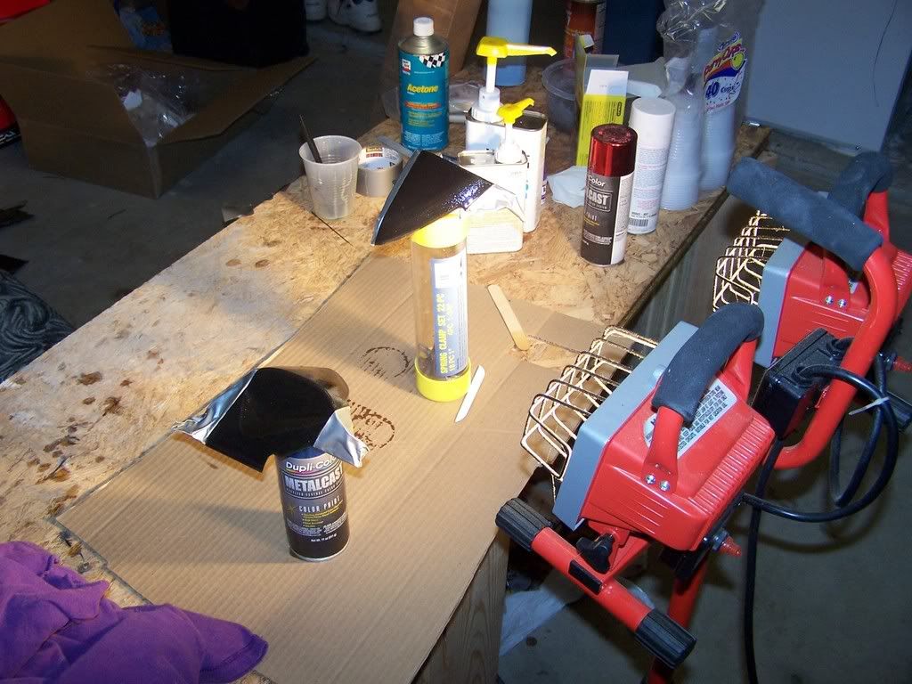

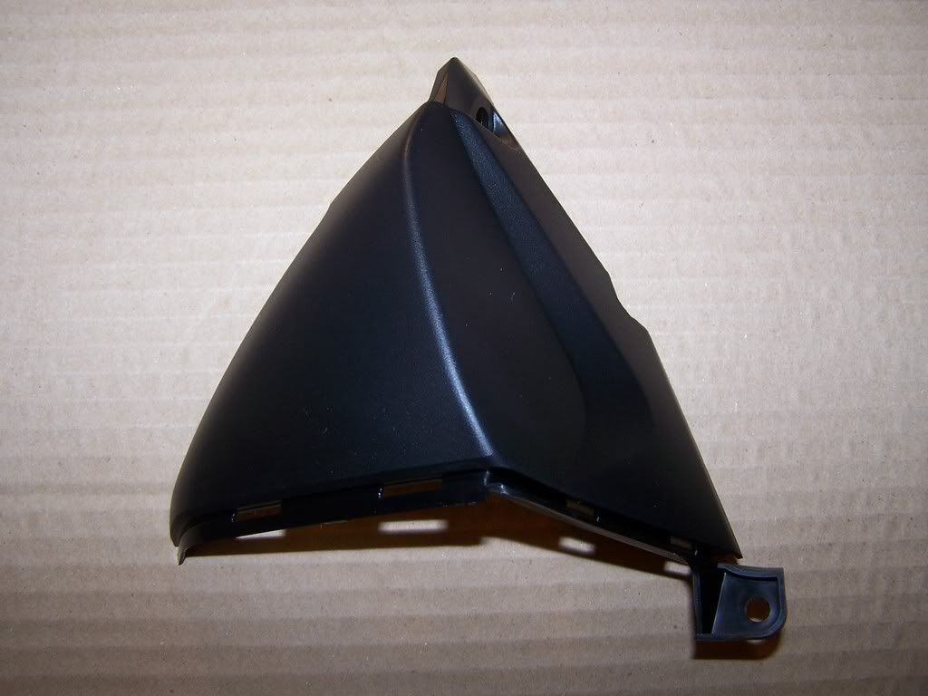

For this write up I will use the headlight covers from the 07-08 600RR.

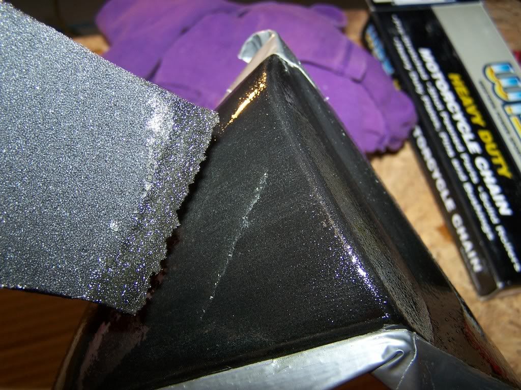

First scuff the part with 220 sandpaper so the resin will make a good bond. Don't worry about mounting points and parts of the piece that will not show. It is better to leave these unsanded so the carbon will trim off easeir later.
Next I like to tape off the part where mounts are so excess resin does not clog them up.
Now make a stand to mount the part on. A spray can works well. I take some duct tape, wad it up, and stick it to the can. Then you can stick the part to it on the backside.

Now it's time to mix the resin. I use West Systems with 207 hardner. It is a 30 minute hardner so it gives you plenty of working time. It comes with pumps to make the measuring ez. One pump of resin, one pump of hardner. Make sure to mix them real well. Do not mix them vigorously as this will only creat a million air bubbles.
Next take the duct tape and get several strips cut and ready to go.
Now take the resin and coat it on the part. You can use foam brushes or paint brushes. I like the foam. If you choose paint brushes get the ones with black bristles. The bristles can and will come off, the black ones will blend in better. Make it ez and just get the foam ones.
You do not need to pile it on, it will just run off. A thin even coat is what you want. Now you need to let the resin "kick." You want it to get where it is tacky, put will not come off on your finger. Also, don't let it over cure or the cf won't stick. It will usually take 10-15 mins (depends on temp and humidity). Just keep checking it by touching it. Once it won't come off on your finger, yet it is still tacky, your good. I like to use these work lights to speed up the process.

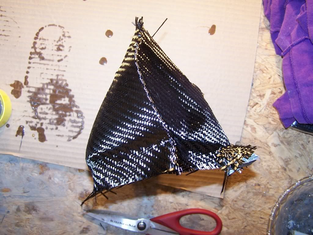

While the resin is kicking you can cut your carbon. I use the wifeys scissors(hope she doesn't read this, she's looked all over for them lol) Make sure to cut it plenty big. You don't want to lay it down only to find out it is to short. I try to leave about an 1 1/2 inch excess all the way around the part. Don't cut it too large, that's just wasting carbon. Keep in mind this chit frayes like there is no tomorrow.
Now it is time to lay the carbon. Like I said, it frayes if you just look at it hard enough. Treat it like a baby bird! Start at one end of the part and slowly lay it down and work your way across. Try not to handle the the carbon to much, just make sure it is laying down and making contact everywhere. Pay close attention to the edges and any sharp curves.
Once that is done I like to take the scissors and trim it down some(not too much.) Now you can take and wrap the cf onto the back and tape it down.
Now that is done and you are happy with the way it is laying it is time to apply the resin. Using the brush, gently spread it on making sure to cover it completly. Do it in a thin coat. I couldn't really get a pic of this, didn't want resin all over my camera. Oh, and this is where you definatley want to use the gloves!
Again, once the resin is on, don't hadle the carbon too much, it will only cause it to fray and put tiny strands all over the part.

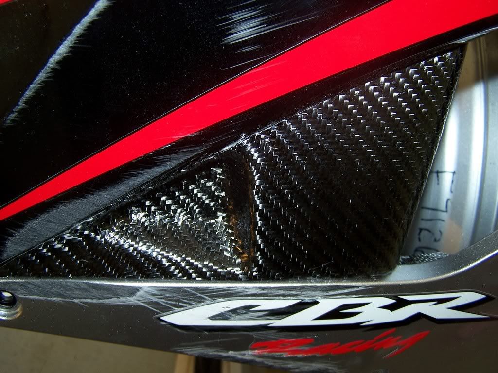

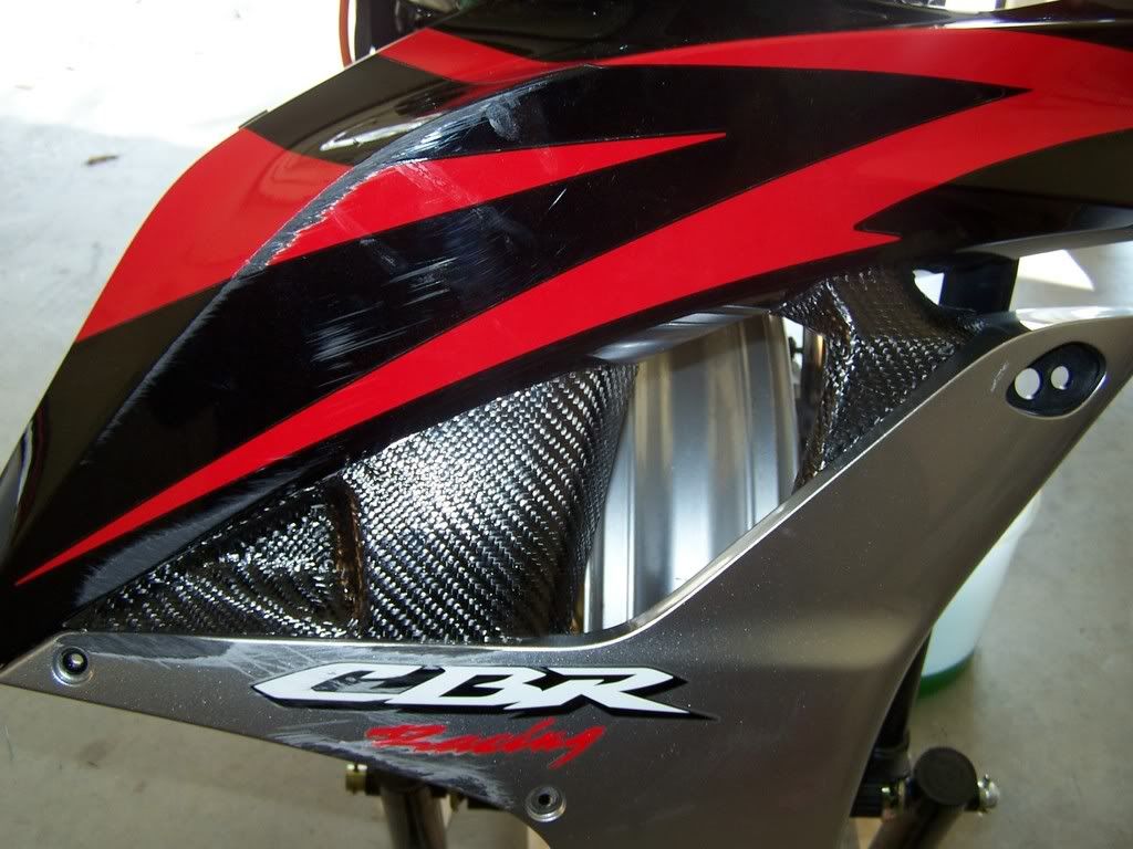

Now you have 2 options. You can continue to put layers of resin on and build it up smooth or you can do it with clearcoat later. I like the clearcoat. The more resin you use the more it will tend to brown out later down the road. One layer will harden up the cf and make a nice clear part.
If you decide to layer it with resin, it will take 3-4 coats. once that is cured it will require alot of block sanding to take out the wrinkles.
Now it is time to sit back and let the part cure. This will take a while. I usually wait untill the next day before I trim. If you try to soon, you will leave fingerprints in it, just like paint.

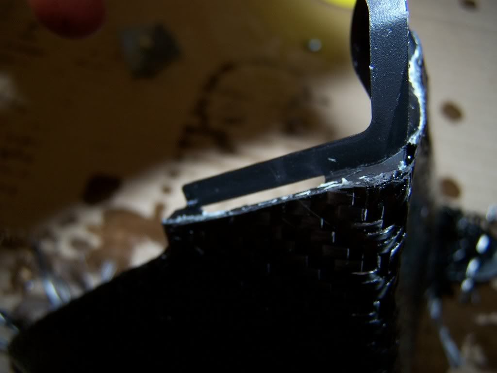

Now that it has cured it is time for the pain in the a$$ part, TRIMMING! I like to do as much as possible with a razor knife. Since you are just using on layer of cf it cuts pretty well. Take the part on the back side and follow the edges of the stock part with the kinfe
You can also use the rotoray tool but be very very carefull. Try just using the razor changing the blade often. Keep in mind all the mounting tabs, don't want to slip up and cut them off.
Take your time and be carefull, the cured carbon ends are like a row of needles. You will think you are trying to trim the claws on a porcupine. Don't forget to drill all the mounting holes you maay have covered. I like to wait untill I am done trimming all the parts I am doing and do them all at one time.
Once your done trimming it should look something like this.
Now I like to test fit the part to make sure all the trimming is up to snuff.

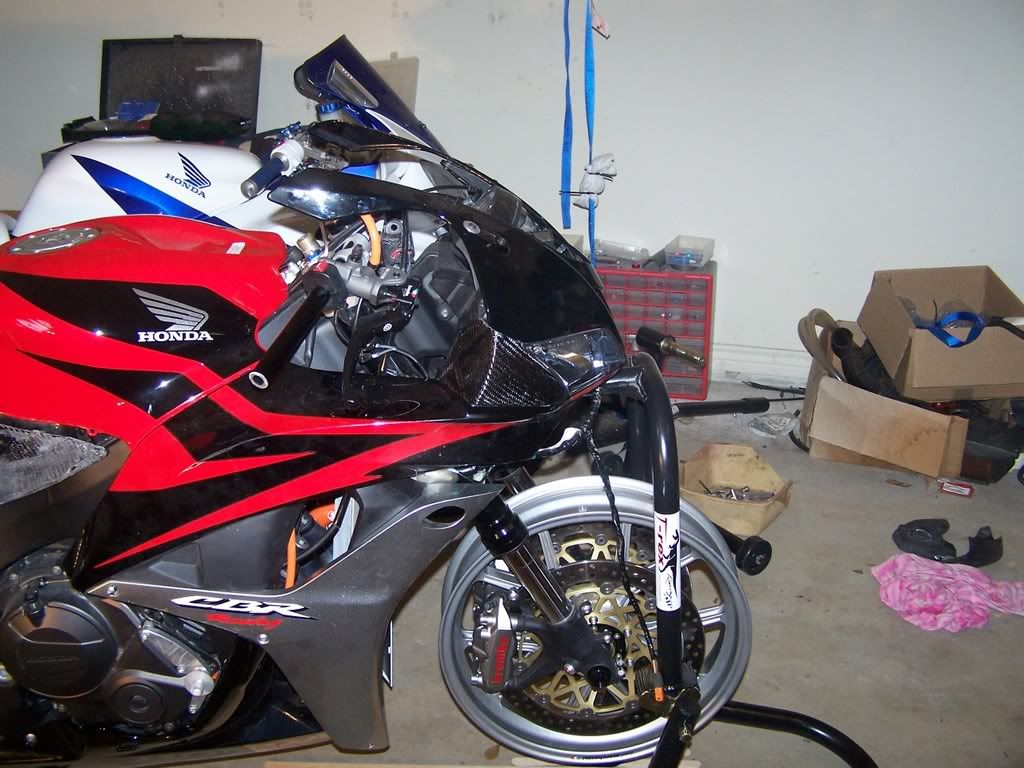

That's about it for now, I still need to clearcoat all my pieces. I like to wait and do all the parts at once. Here are some more parts I have done. Keep in mind they are not finished. They need to be cleared, blocked, and cleared again. These will give you an idea of what can be done.

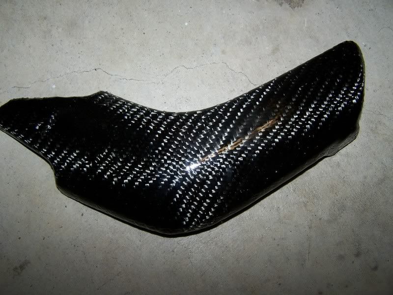

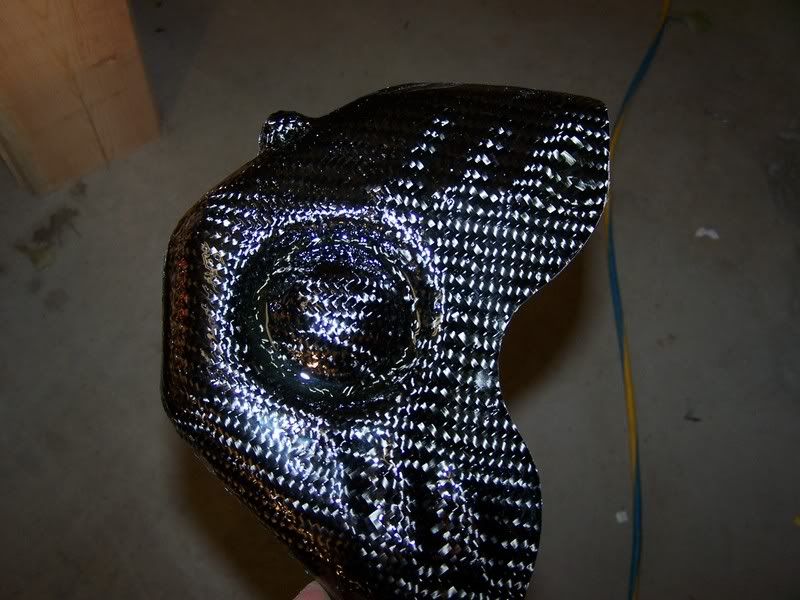

Here's a little trick that I'll add from when I'm overlaying parts, or for doing up some full carbon parts. If you have a food saver for your house, you can use the vacuum seal of the system to bag and aid in the curing of the parts which ensures everything sets up nice and tight. The nice thing about the bags as well is that you can reuse them quite a few times if you are doing a multi-layered part (assuming you don't hoze down the inside with resin  )
Here's a pic from my exhaust guard I did awhile back.
I bought my mom one of those a couple years ago and I was thinking about cough...cough... borrowing it. Just wasn't sure how it would work on the overlaying. Thought it might leave wrinkles in the resin. I'm still thinking about trying it just to see. When I was making all c/f parts with molds I used a vacuum setup and that is a whole nother write up in it's self.

I bought the bike wrecked for a new project. Here is the build thread. Check it out. http://www.600rr.net/vb/showthread.php?t=105028
