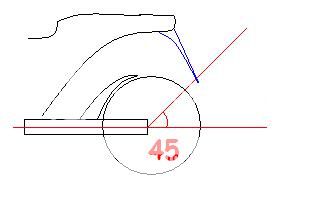

Oh, and you don't need the stock indicators, they just have to be a decent size with the appropriate globe in them, stockers are 21W. They also have to be mounted a minimum of 30cm apart. You should be able to find a fair number of second hand ones from ebay from various makes of bike.
With the fender, you don't need the stock one there either, you just need a fender that goes past a line drawn at 45 degrees like this (sorry about my lack of artistic skill):
