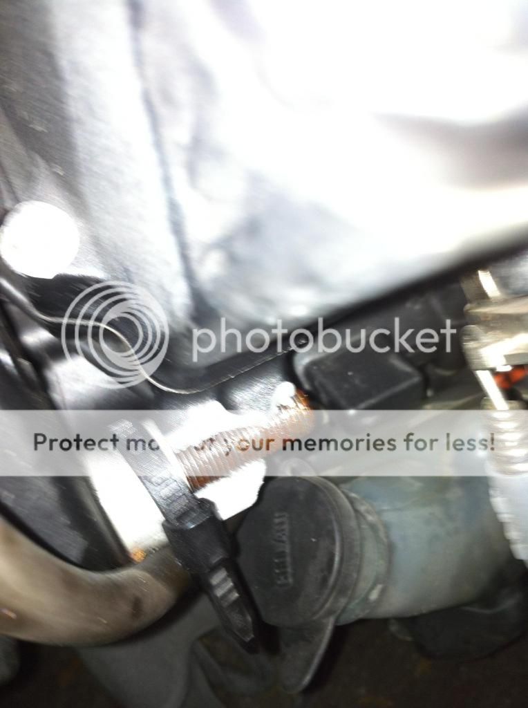

yea the bolt hole from the right frame bolt (as seated) snapped in half during an accident and well im wondering if its ok to just put jb weld on it and mold the missing piece back as in packing tons of jb weld to ressemble the missing piece..... only problem is im wondering if ill be able to remove the bolt in the future if needed it be.
picture link of damage http://i576.photobucket.com/albums/s...guez/photo.jpg

Take the bolt out. Brake clean the piss out of it. Use quick steel not jb weld. Retap it. Stronger then new. We use quick steel on intake mainfolds and crap when porting them out not problems at all. Guy w a rotary has fixed 4 blocks that I've seen with it no problems at al

use a dowel the size of the bolt shaft without the thread, quick steel as mentioned, carve it out with a dremel to bring it back to the original shape (exterior) then remove the rod and tap a new thread. quick steel is the bomb for engine cases, as long as it is not structural. It also fills engine case rash damage like superglue :-)
edit: and get a new bolt, yours has red hair, and thus no soul.

ok but how can i maintain the circumference of the hole when applying the quick steel since there wont be a bolt in there ?
can i just drill a hole? then retap?
nvm read the second reply. lol thanks! i feel alot better now.

how do i prevent the quick steel from fusing to the dowel? or is there a sertain material dowel i can use?

You can do a super light coat of liek grease or pertol jlly to it. But if yu get even slighly bit on case iwont stick there wiether.. if youkeep bolt in it maybe w wd40 on threads you could porbbly turn the bolt back out after and retap then

Don't use metal to plug hole. It will become a permanent fixture, dowel can easily be drilled if necessary

Weld and retap !
