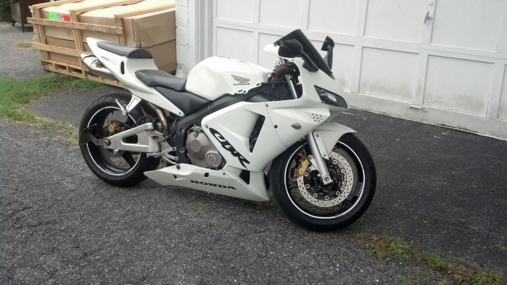

So here she is, the day i get her
Not bad looking right? Well, what you don't see is the bent rim, the bad cooling fan relay, the cracked fairings held together by zip ties, the horrible wiring done for the "head turning led's", the ghetto rigged resistors for the turn signals and brake light that worked when they wanted to, and the coolant leak among countless other little things. What you can see is the sh***y 08 muffler, the too long grips, and the wrong year/ebay mirrors. Ok, onward to fixing everything

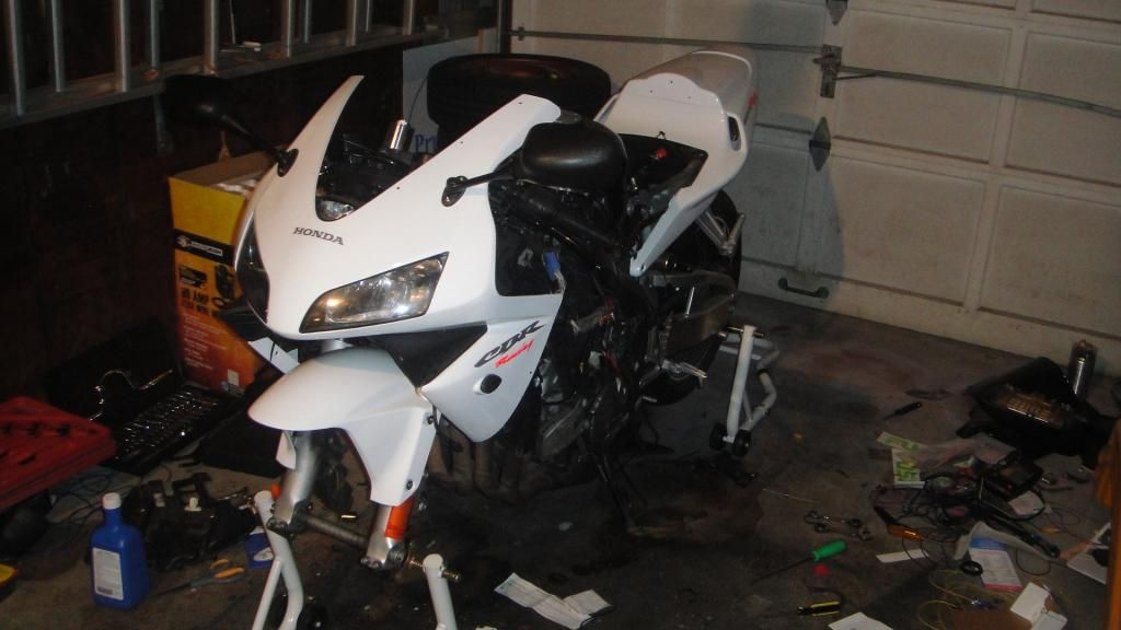

Well, finallly torn everything apart and starting getting to work.
First thing ordered, complete fairing kit. Looks damn good i might add. Total cost $415 with free shipping. And ABS plastic (i hate fiberglass fairing btw)

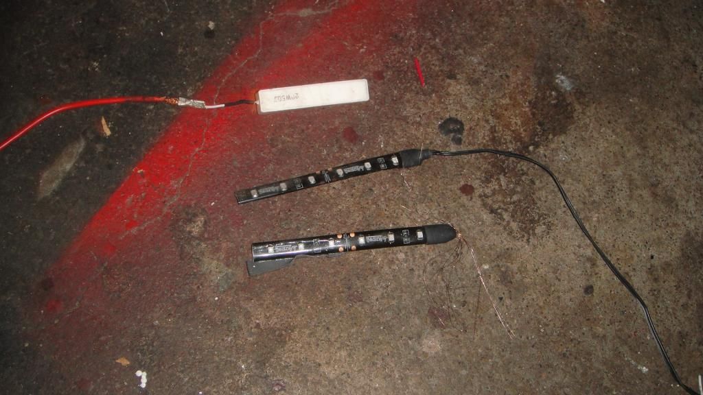

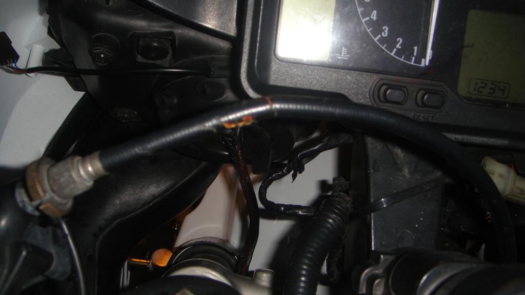

The resistors and "head turning led's" It was a wiring nightmare but finally got it all cleaned up.
$20 custom led resistor wired in (Thanks to the write up on this site). $20 for the resistor. All turn signals and brake lights work now.

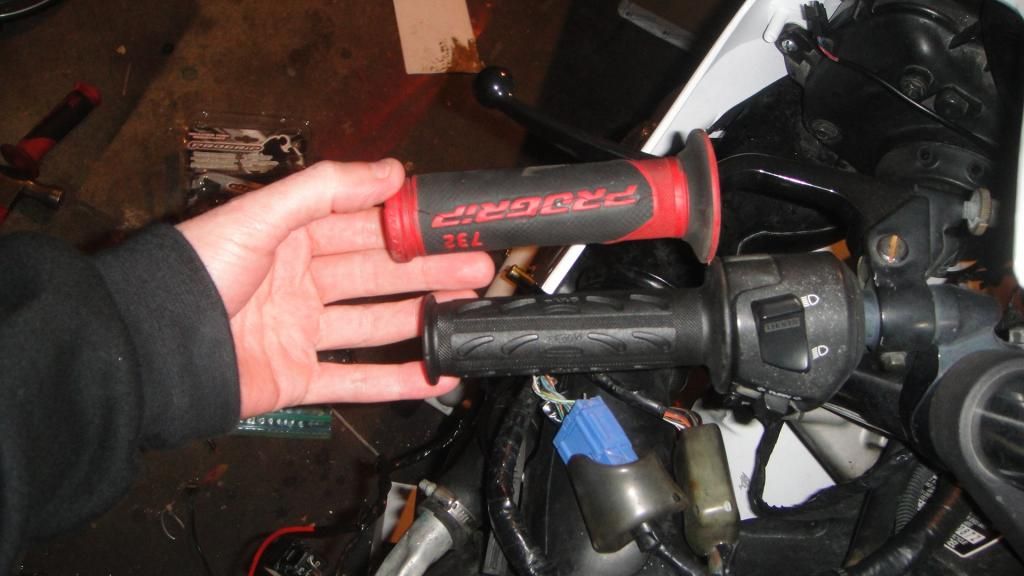

The red grips were the ones that were on the bike when i bought it. Too long and too think. Ordered new progrip black grips. Took this pic to show the difference. $20 for grips.

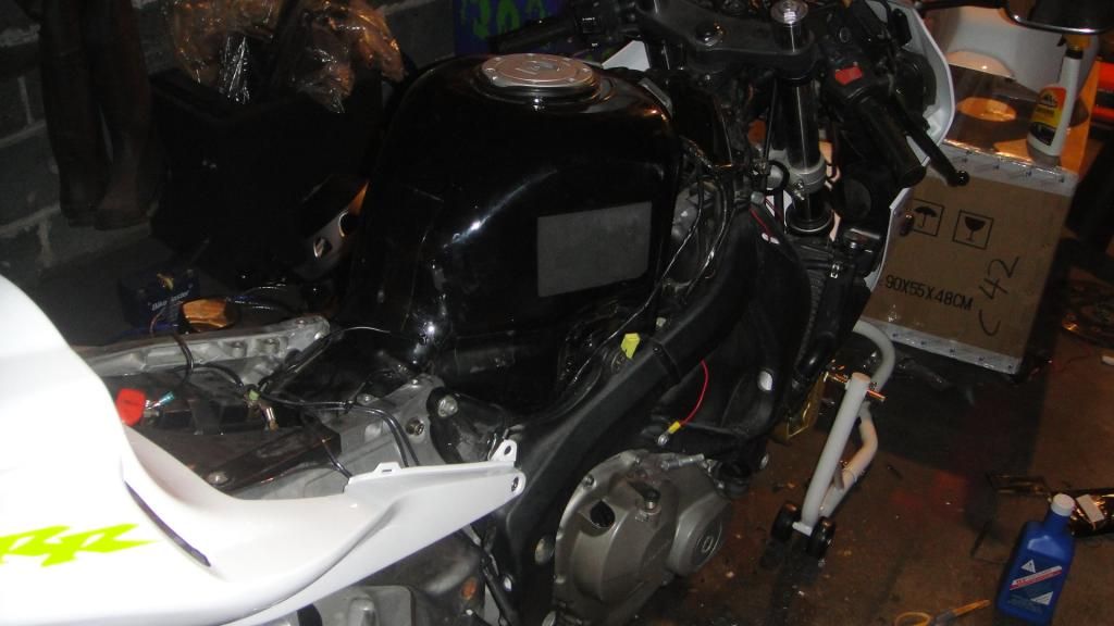

Got most of the wiring cleaned up. Still a bit to go but a hell of a lot better than it was.

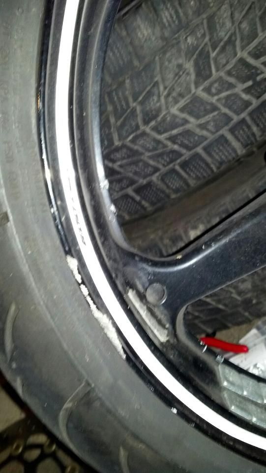

Here's the rim. As you can see has a chunk out of it. At the local rim repair shop right now. They think the spoke may also be bent. $180 to fix the rim. Good thing the kid balanced it huh?

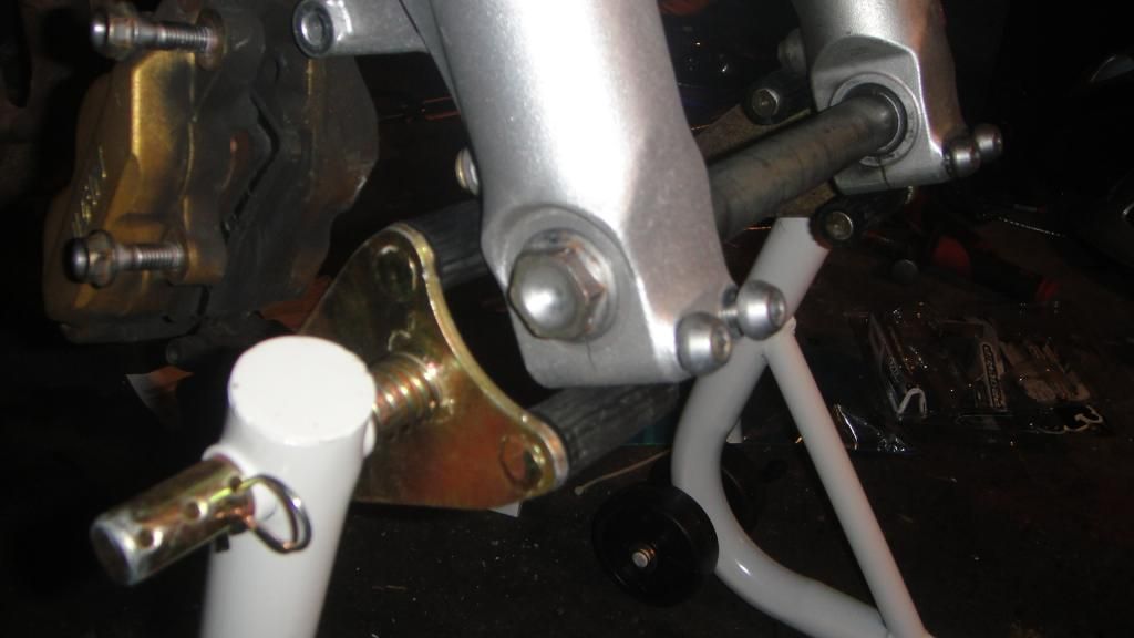

So when we went to take the rim off THE AXLE NUT WAS F***ING HAND TIGHT!!!! ARE YOU KIDDING ME! Thank god i bought this and not some other kid at this point.

So this is where i'm at now. Waiting for the ect sensor and clutch cable so i can start getting more back together. But she's coming back alive slowly but surely.

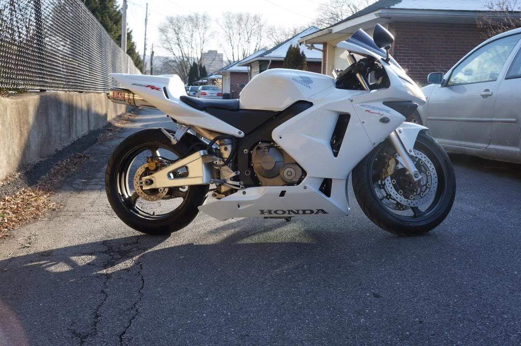

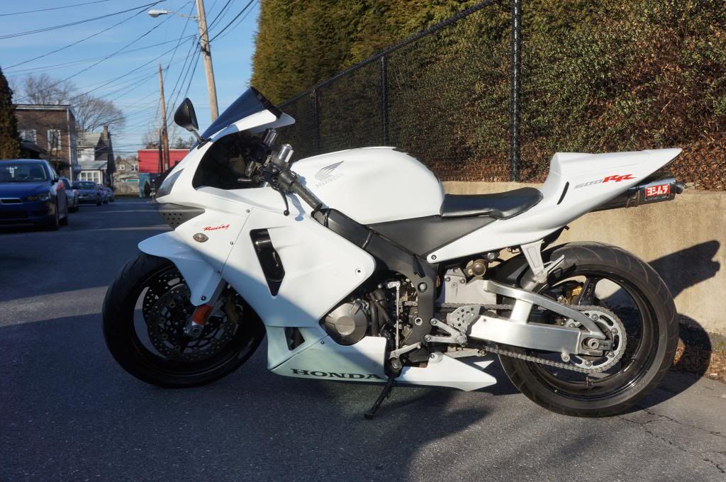

And here she is! Finally after 4 months of hard work and fixing all the crap that was wrong with her, she is finally done!
