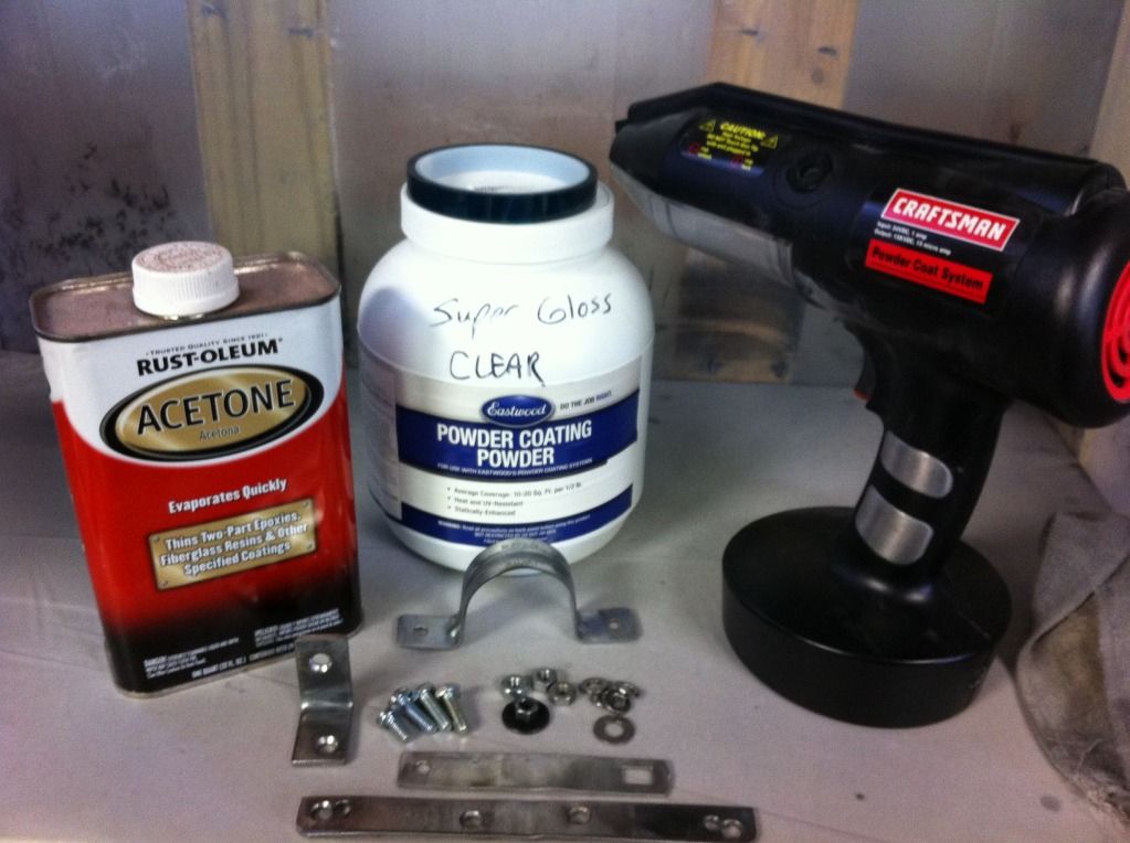

First Step:
This photo just gives you the idea of things needed. (some pieces have been straighten and cut in this photo.

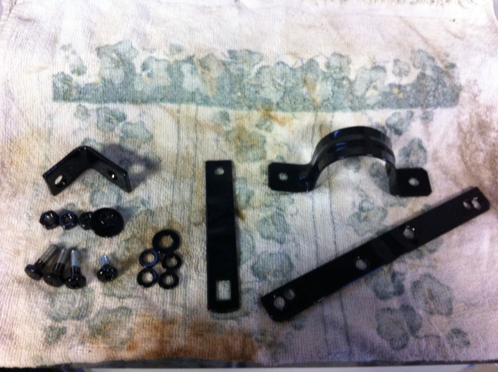

Third Step:
You'r pieces should look something like this.

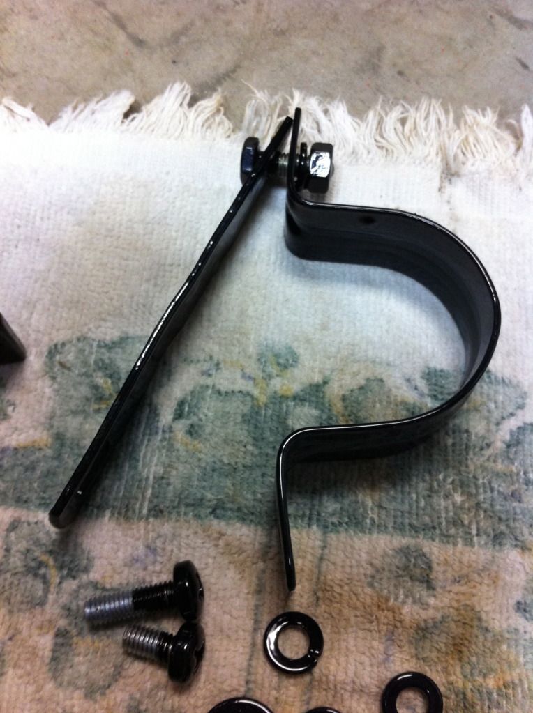

Step Four:
Using those pieces and the nuts and bolts place the pieces together to look like this.

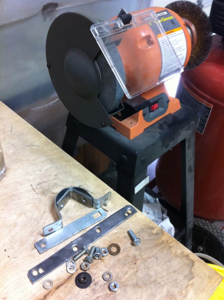

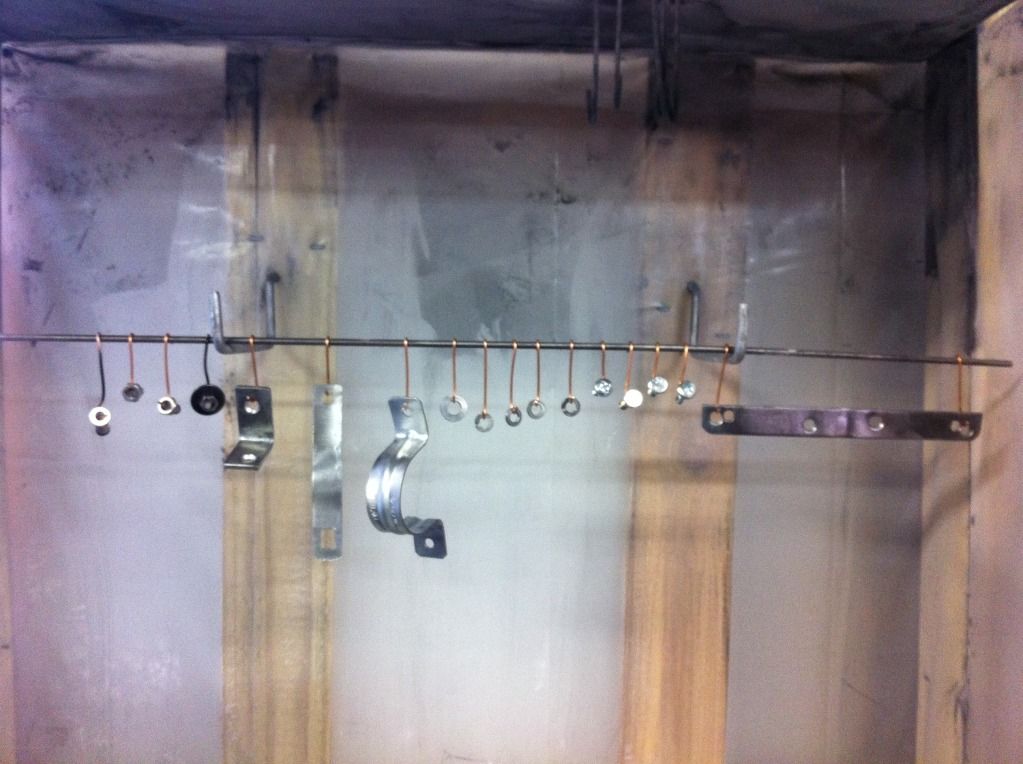

Step Six:
Take the pieces and go over to the wire wheel (sand Blasting cabnet if you have one), and clean the parts very good.

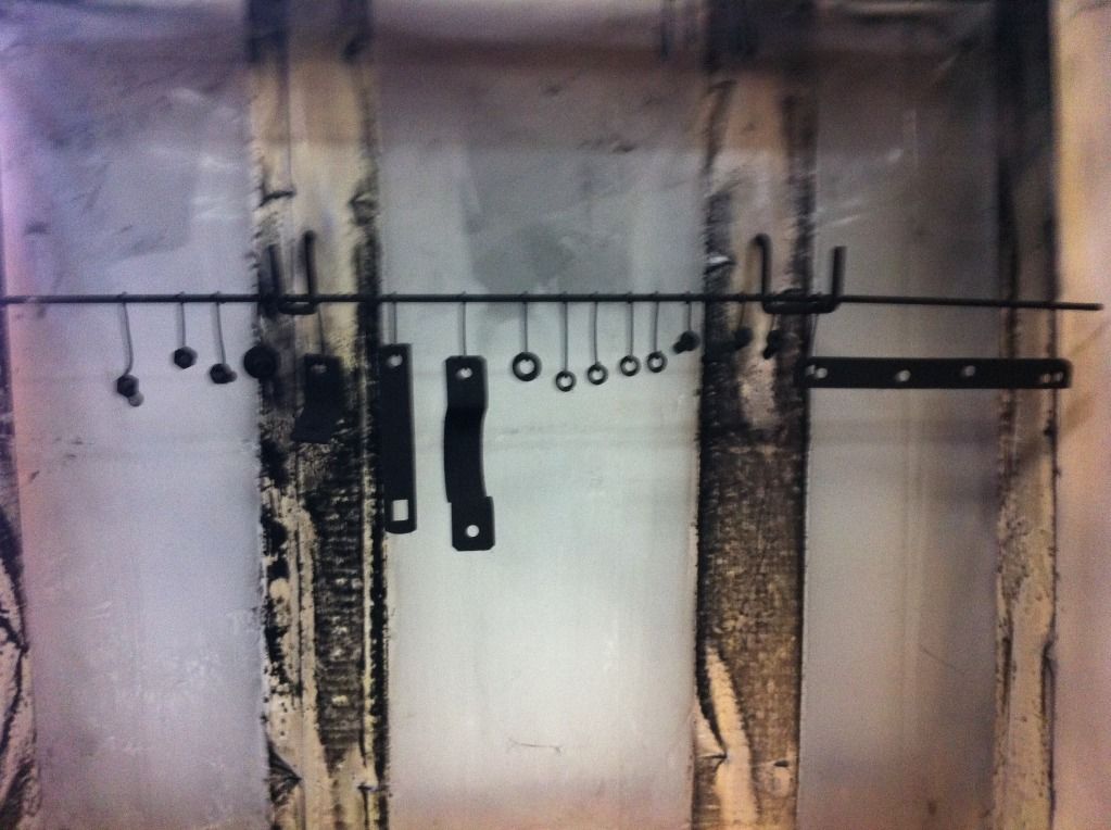

Step Seven:

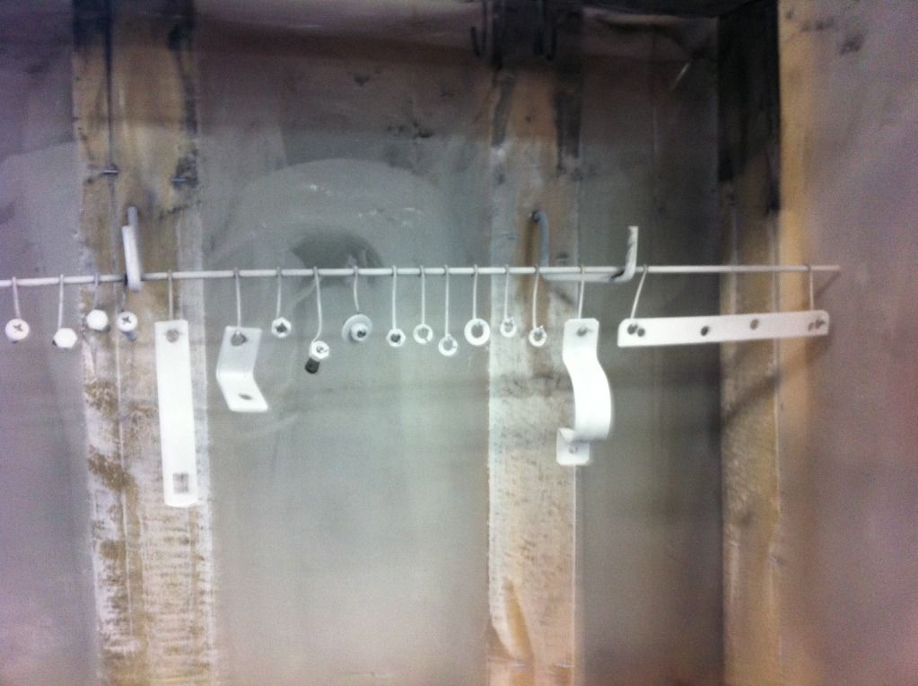

Now that you cleaned the parts it's time to powder coat (or paint) them. I have a cheaper powder coater system (craftsman) that I got off ebay and as well as two pounds of High Gloss Black for about 50 bucks. I bought the super gloss clear coat powder from eastwood. Acetone was bought at local Hardware store. Now clean the parts while wearing gloves with the acetone. If you paint skip ahead a few.
Step Eight:

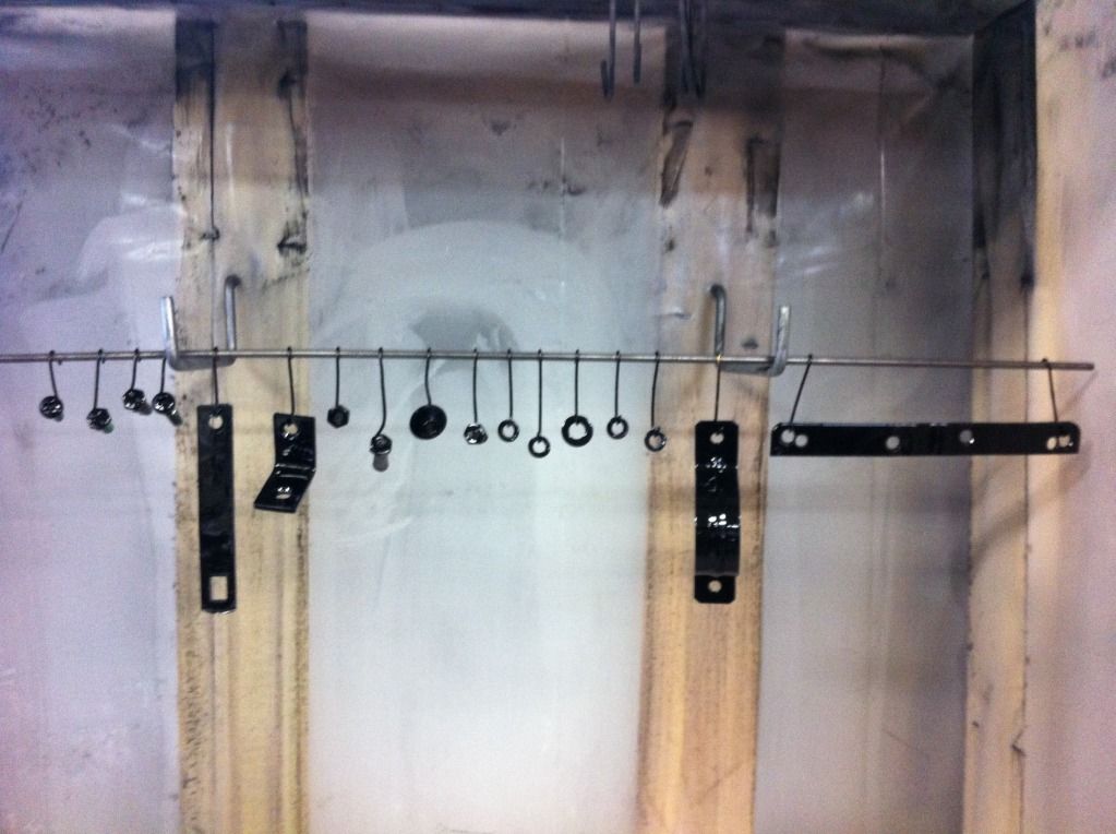

Using copper wire I hung the pieces and taped and plugged the threads on the nuts and bolts.
Step Nine:
All the parts were powder with the high gloss black powder, cooked, clear powder applied, cooked and was left for a few to cool down. ( I did let the pieces cool down before powdering was done.
Step Ten:

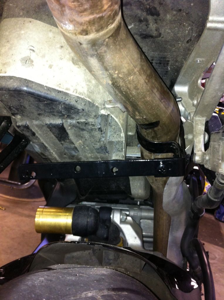

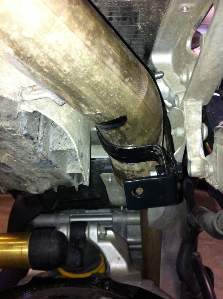

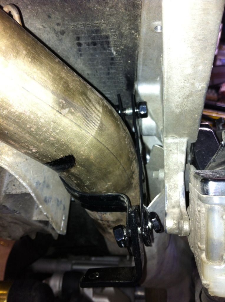

Step 11:
This is a photo of before I started putting it back together.

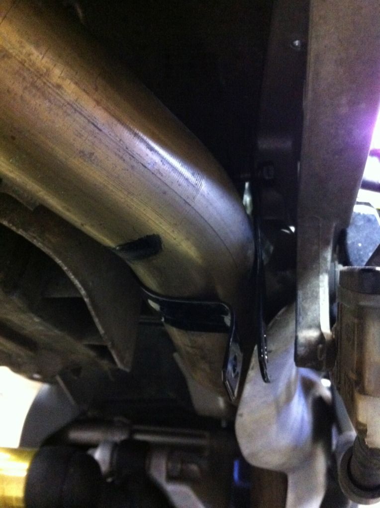

Step 12:
Coming from the lower side of the exhaust (next to motor) slide the above wire fence parts around the exhaust and up to about where shown in photo. its about the straightest part of the exhaust at this point.
Step 13:
Now take the cut down L bracket and place it into the left open hole of the Wire fence bracket's and start tighten it down to almost tight. Now tighten the top wire fence bracket down (the one towards the seat). Down test align the straighten L bracket with license plate to get proper placement you want and tighten it down. ( Make sure to use the lock washer's).

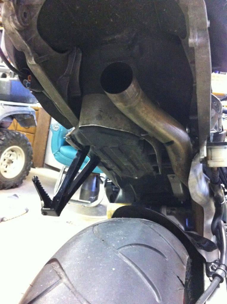

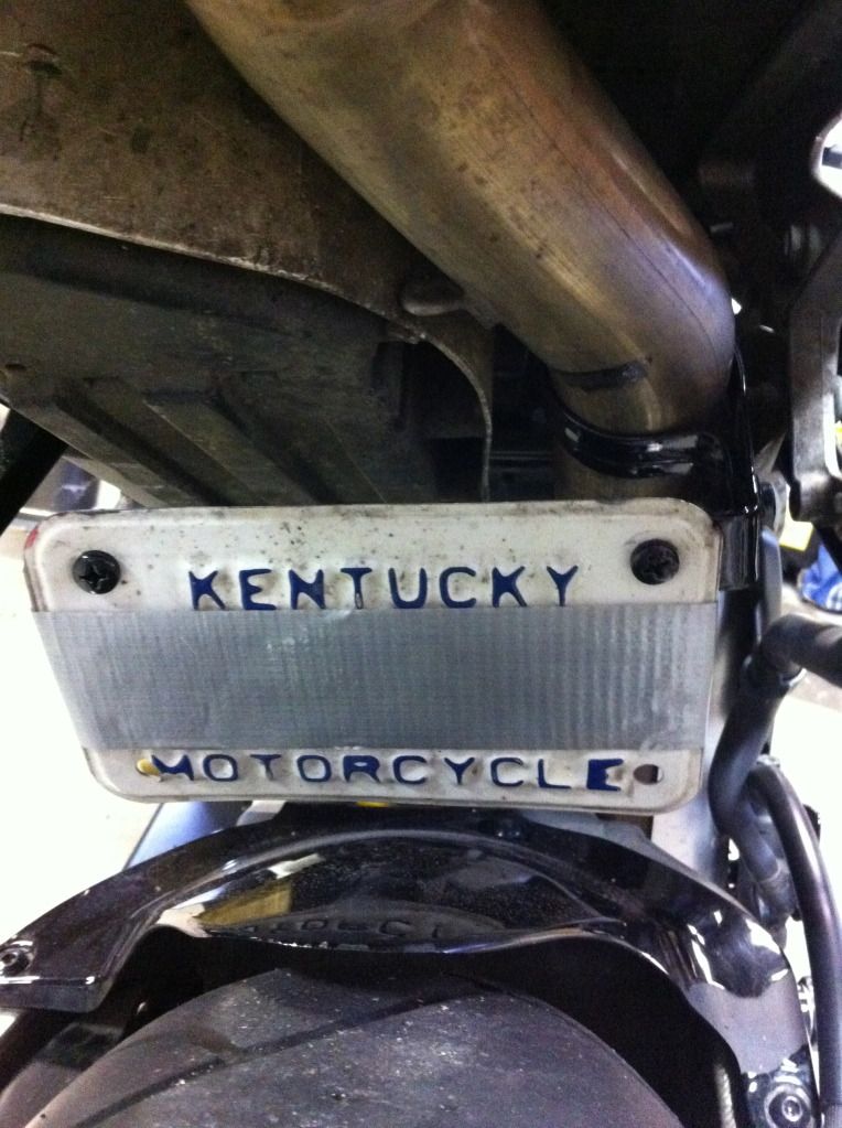

Finished Now:
Congrat's you have done it! This cost me nothing but time since I had the pieces, but if I had to buy the parts I might be around ten bucks. It took several hours but I think it was mainly because of the drinking lol. This was on a 2005 CBR 600rr.

Hopefully that doesn't destroy your tire hugger or license plate, not much clearance there at all.

Just change the angel, tilt and tighten bolt. Problem solved!

This is how mine turned following your parts list basically the same way other than I still have the paper plate Click image for larger version
Name:	ImageUploadedByMO Free1364085845.171440.jpg
ID:	48473Click image for larger version
Name:	ImageUploadedByMO Free1364085855.153935.jpg
ID:	48481Click image for larger version
Name:	ImageUploadedByMO Free1364085863.171131.jpg
ID:	48489Click image for larger version
Name:	ImageUploadedByMO Free1364085871.191219.jpg

Looks great from what I can see of it. Glad this write up helped.

Yep thanks for the help. Gave me what I wanted for a total of 30 dollars for parts from lowes and the lights from my towns motorcycle shop.
