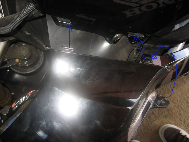

Two up front: Pic 1

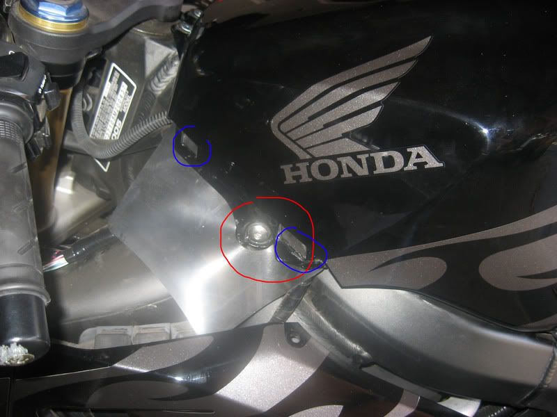

Under Seat: Pic 2
In order to take seat off you must remove the 2 screws where the blue arrows are pointing. Just sorta bend the foam to get to them.

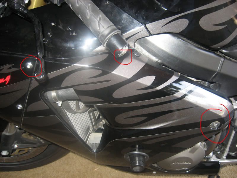

Under Ram Air Cover: Pic 3

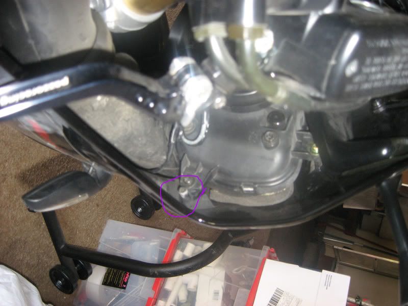

You will need to remove the air ram cover in order to get that 1 on each side. I recommend taking these 3 screws off: Pic 4

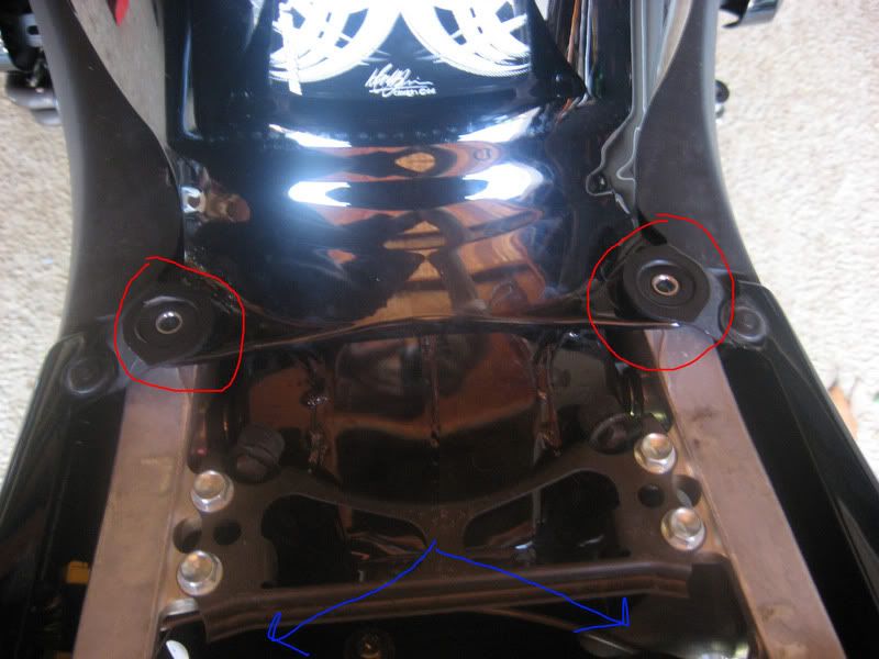

First observe how it works: Pic 5
There are 2 tabs that snap into holes on the tank. The ram air cover itself is pretty flexible so you will need to bend it around a little.

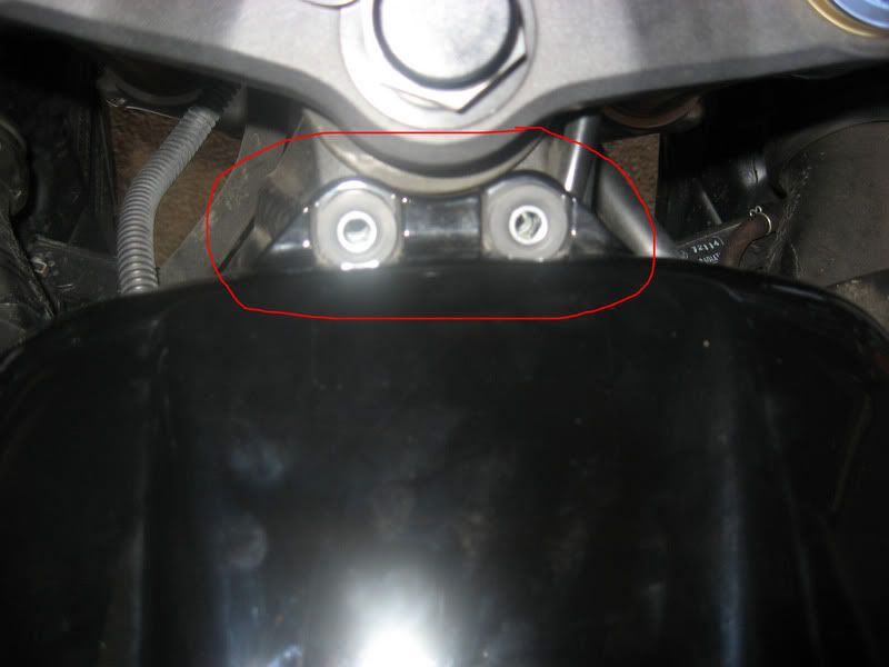

On the opposite side there is a little round tab that goes into a hole on the other side of the ram air cover. Pic 6

Two up front: Pic 1
Under Seat: Pic 2
