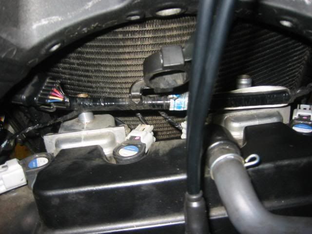

Did the PAIR system removal this morning. Thanks to Nemessis for getting me the Kyle racing block off plates. So here's a few pics of the job:-

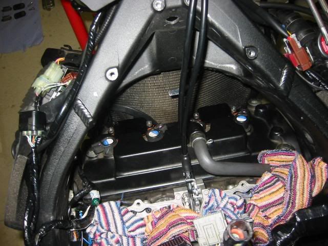

I already had the airbox removed to fit new throttle cables so this is where I started:-

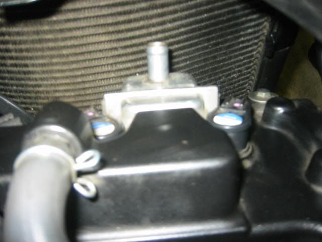

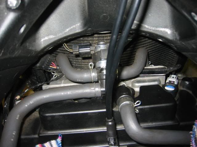

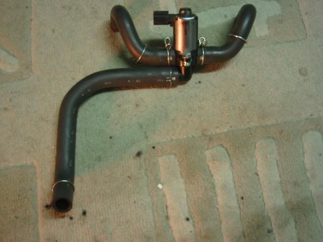

First unplug the cables and hoses and remove this item:-
I then removed the coil loom to get more room to work:-

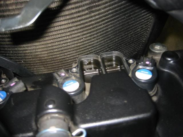

Remove the caps:-
Then you should see the reed valves:-

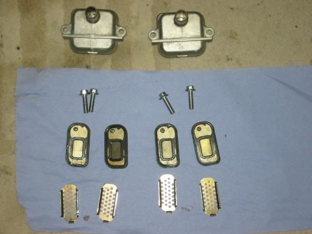

Remove the reed valves which are quite tricky you have to prize out with a screw driver. Also remove the baffles below. Here's the items you should remove:-

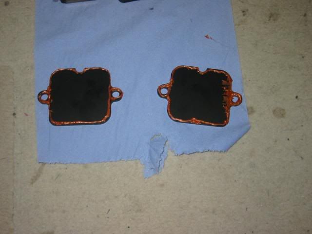

Use some silicone RTV on the block off plates:-
And bolt in place:-

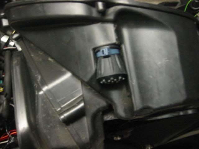

Then block off the outlet on the airbox:-
