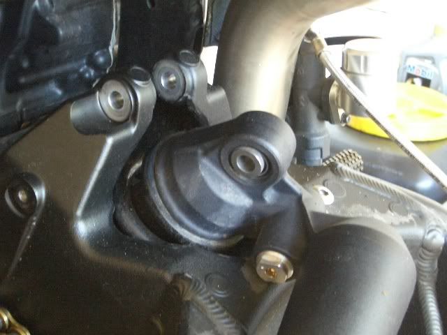

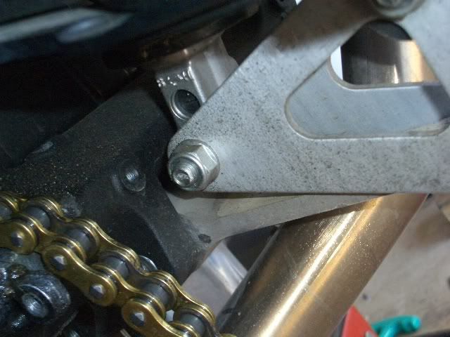

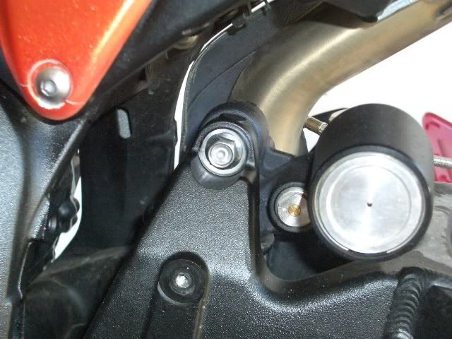

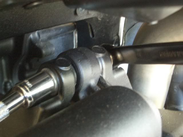

these are the two bolts we are looking for.
top
and bottom
3,672 Posts

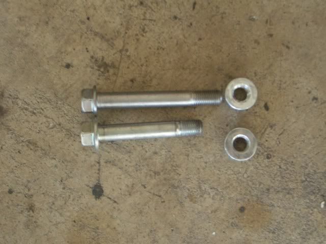

both bolts use a 14mm hex head with a 17mm nut.
it is a tight fit on the top so i suggest a 17mm open end with a 14mm socket up top.
an extension on a breaker bar will help since these are torqued pretty good.
3,672 Posts
the bottom bolt comes out just like the top. same size wrenches needed.
the interesting bit is that they were installed opposite.
the 17mm nut was on the right (riders perspective) on top and the left on bottom.
sometimes they dont want to come straight out.
just wiggle the swingarm and the bolts will pull easily
in case you forget the longer bolt is the top

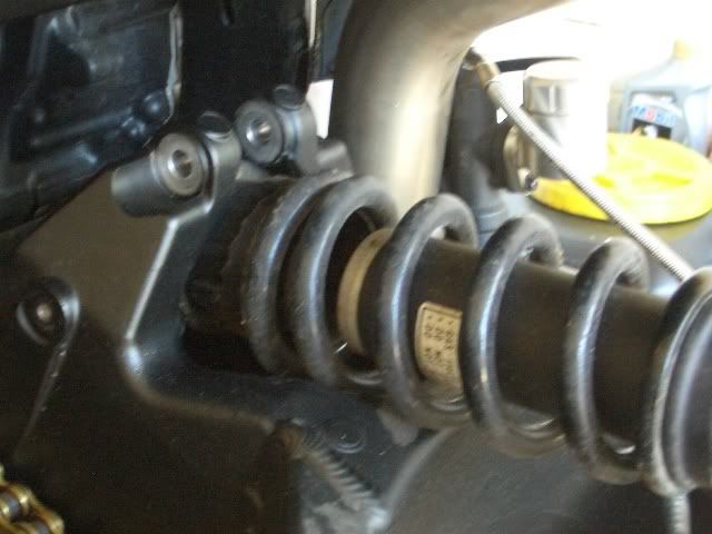

next pull the top of the shock to the rear and then pull back
it will come right out

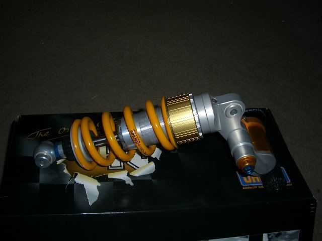

ok lets finish this
here it is in all of its swedish radiance
i went with the PRXLS because i have one on my 1000rr and am more familiar with it than the TTX.
also i know the general consensus around here is that if you dont need the 3 way then dont get it.
after talking to brad at superbike supply, i was convinced that a hydraulic preload was necessary due to the ease of adjustment.
ok so what did that leave us. there is the elka 2 way with hydraulic preload for right at 1K dollars from sportbiketrackgear.com. for the price of that and a tank of gas Brad got the ohlins to my door. i think i made the right decision.
i was also looking at the penske triple but again no hydraulic preload and i didnt want to have to deal with finding a place to mount the remote reservoir.

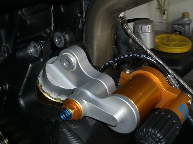

just like removal,
with the bike up on jack stands and the swingarm all the way extended line the shock body up and slide it in

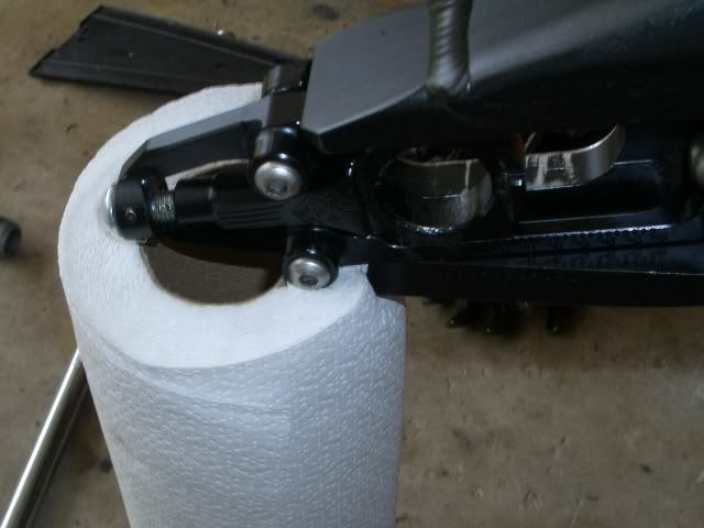

put something under the swingarm to hold it up.
this will raise the linkage to allow you to line the lower bolts up (remember which one it is right)
without having to hold the swingarm and bolt and shock
a roll of paper towels puts the swingarm perfectly into position
3,672 Posts

this is the issue with the hugger. the stock shock clears easily.
if you dont put the hugger on before you tighten up the ohlins it will block the middle hole for the hugger bolt
3,672 Posts
i just worked around it. just loosen the remote preload bracket and it will give you a little working room.
lot easier if you do the hugger first.

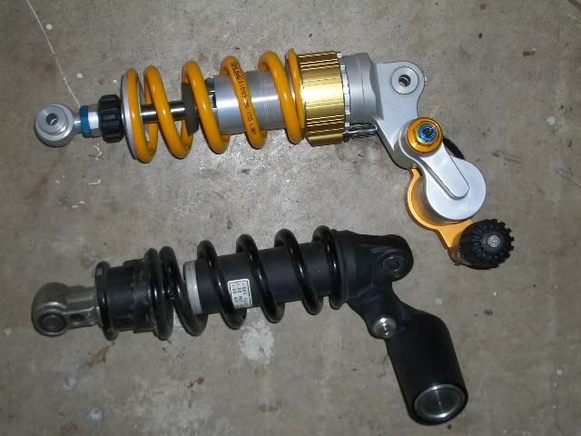

9,216 Posts
here is the ohlins compared to stock.
it is just so well made it makes the stock shock look like it came off of a BMX bike from walmart.
i know what u mean, when i did mine, i pulled the stock one off thinking it would be similar in quality to my MX showa units in the past, and i laughed at how cheap it felt and looked.
u can tell its one place they definitely cut costs.
