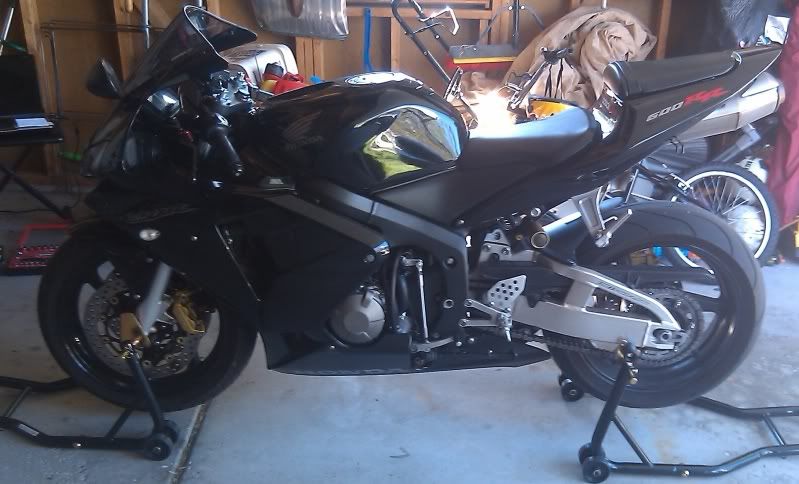

I'm about to start the first steps in streetfighting my bike. I'm going to take as many pictures as I can and really keep up with the project.
BEFORE: (bone stock, except flushmount front blinkers and FE)
AND CURRENT (UPDATED REGUKARLY):

I had my right mid-fairing get blown off on I-94, which took with it the ram cover and a chunk of the front cowl. Perfect excuse to streetfight, right?
Here's what's first on my list:
-Painting midpipe and headers high-temp flat black
-Switching from 2 H7 HID's to one high/low H4 beam in an 8" round vintage housing
-Moving ignition position
-Relocating ECM onto triple tree
-Relocating killswitches
-Bar-end mirrors
-Maybe some tail work...
I'll update with pictures and status whenever I make progress!
Here goes...

How was the '08 front end conversion? Going to do this myself ('09 front end, but it's the same) over the next couple of weeks. Any tips/advice or is it a pretty straightforward bolt on?
It SEEMS straight-forward, but there were some hitches...
The bearings were a bitch. Tough to get out, tough to get in. Used a race press from AutoZone, and it ended up working.
Also, the bolt lock on the forks doesn't work after the conversion. As far as I know, there is no way around this.
The last thing was contact on movement. It hits the ram cover fairings as well as the gauge cluster. Removing a little bit of material took care of it.
All in all, GREAT mod... well worth the pain. Good luck!

Hmmmm, knew the conversion seemed too good to be true!
By bolt lock on the forks, do you mean the steering lock that's activated from the ignition barrel? I never really use that anyway so it won't be a huge loss.
Is it the forks themselves that rub the clocks or is it the brake lever/master cylinder? I've already modded an '09 master cylinder on to my current forks and have worked around that slightly so it doesn't foul the clocks. If it's the same problem as I've already had then that shouldn't be too bad.
I've seen some other threads and was aware that the thicker forks might rub the air intake cover. Might need to do a spot of DIY on that one!
I'm looking forward to getting stuck into the conversion but, at the same time, I know it'll be a pain in the ass!
Thanks for the heads up!
Yep, same here. Didn't even notice it was broken until I found out that feature had ever existed, which was a while after I did the mod anyways! Not a big loss.
It's the forks, but it's real easy to do some trimming.
