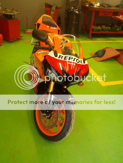

Let’s start from the dealer:

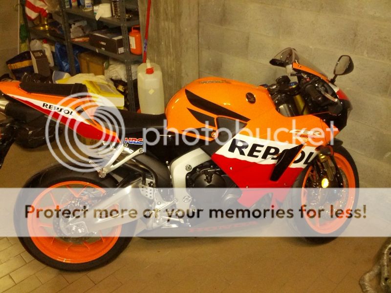

In the garage
Labels on the tank … removed

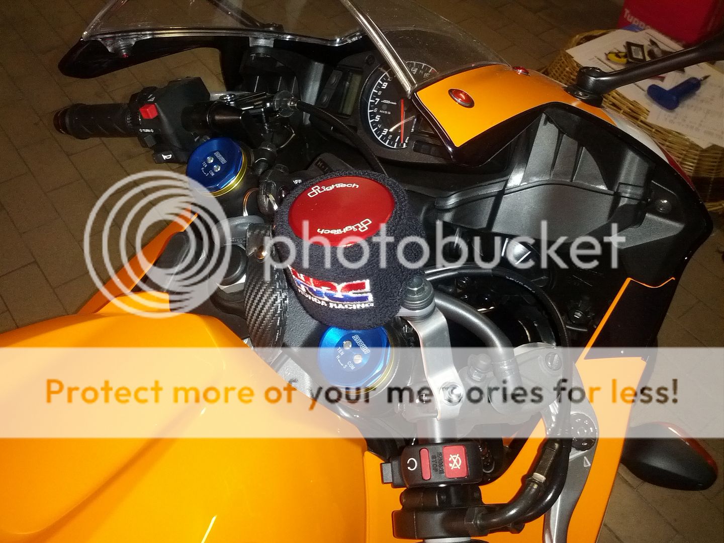

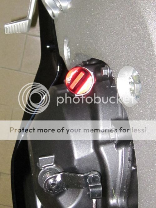

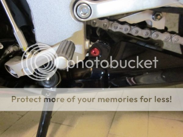

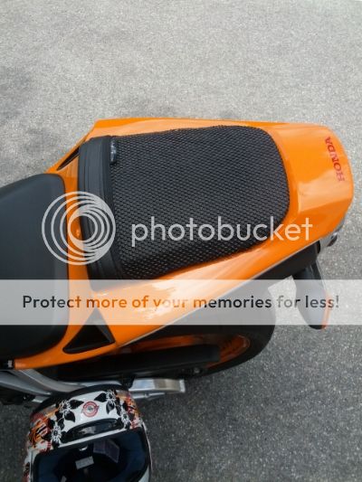

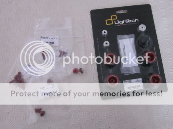

Reservoir socks arrived and Swing arm spools (yes I am an LighTech addicted ;))

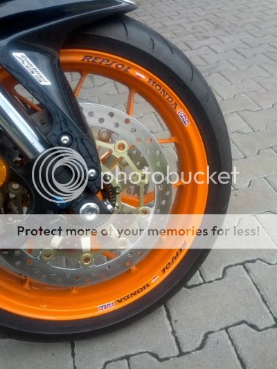

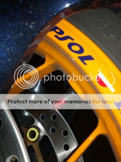

Repsol Honda wheel stickers just received and installed
Swingarm labels removed too and spools installed

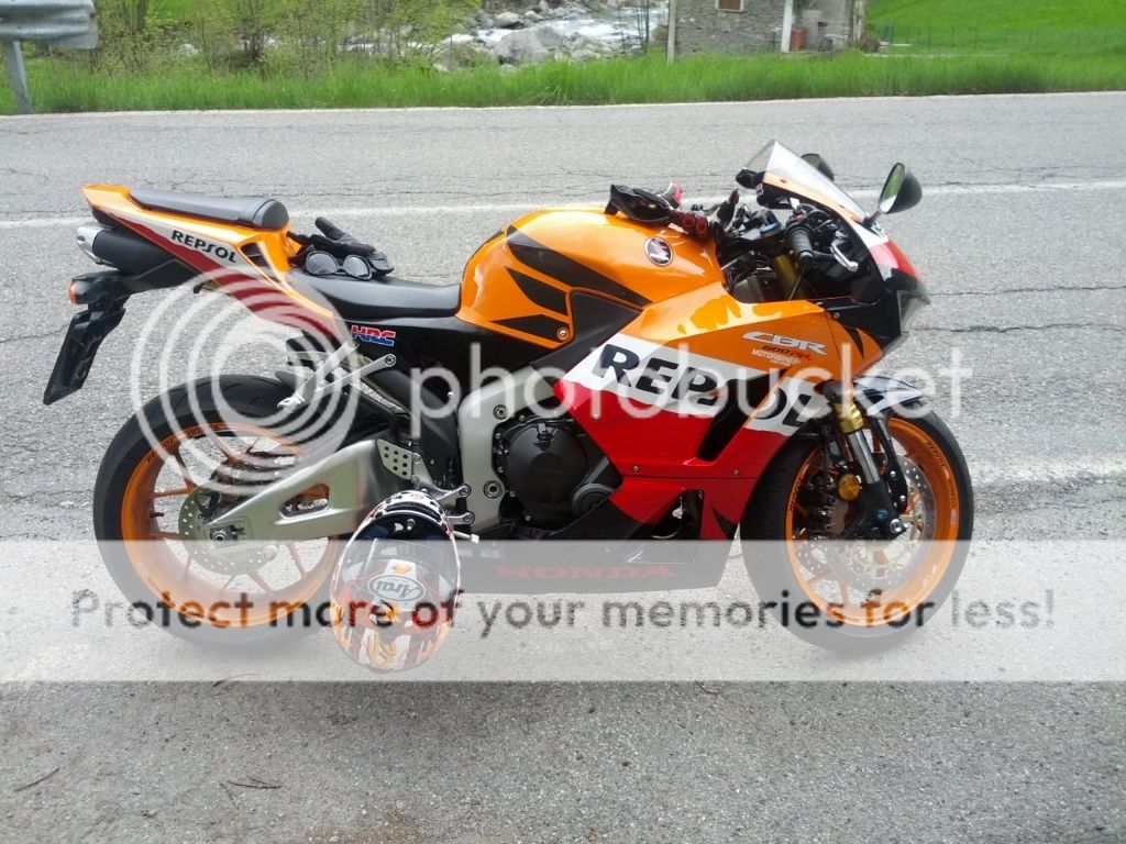

To test the spools and the socks I had to do a ride and yes... my helmet should be pretty like the baby
Sunglasses belong to my second love (or should be the first?)

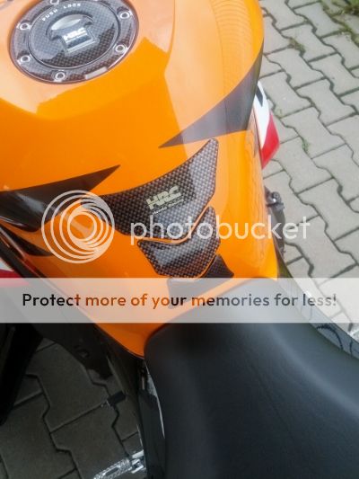

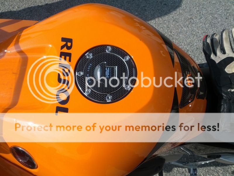

Tankpad Honda set installed (to not cover the design I removed one of the tank pad piece)
Another live test

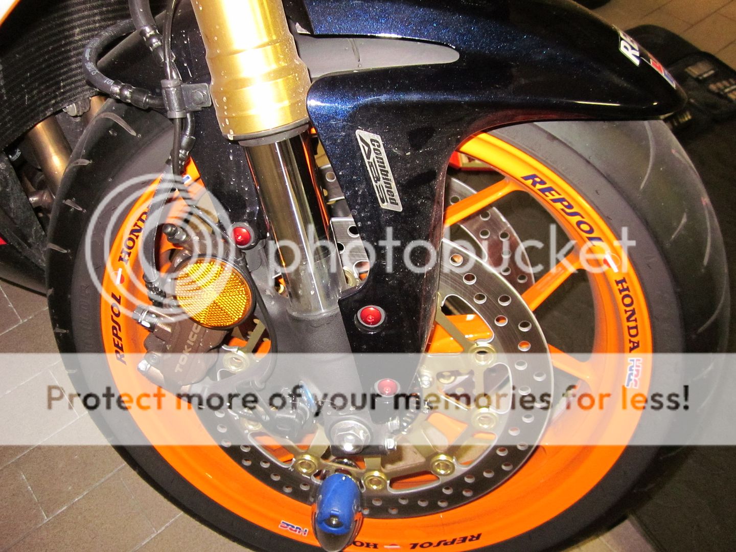

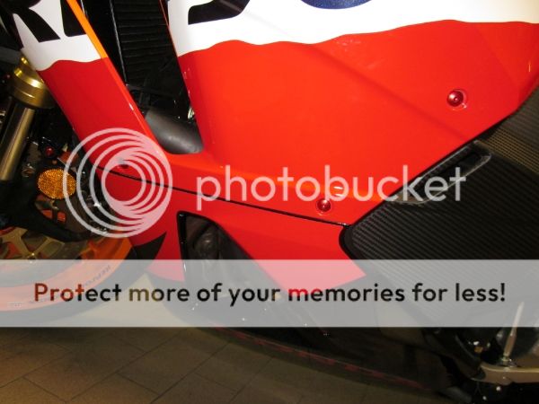

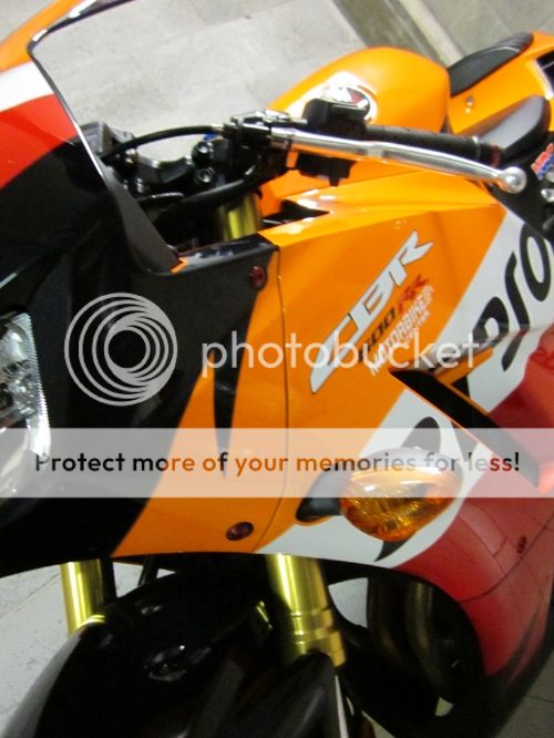

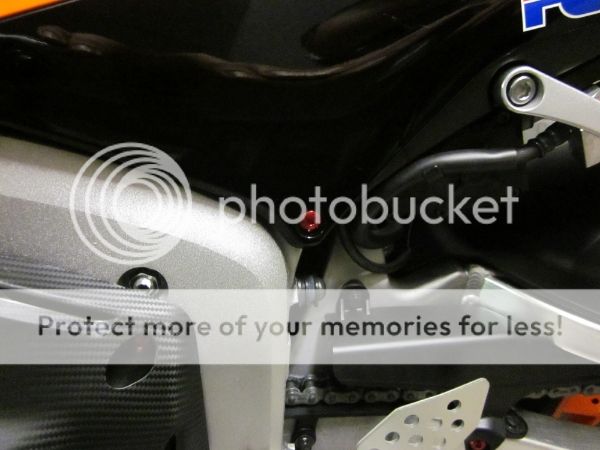

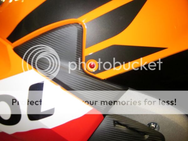

Ergal addicted shopping. As the kits are still not out I measures the size of all the screws, bolts and buy them alones (I will post all the codes of Honda original screws, bolts and the link with LighTech ones). These first ones are the windscreen ones.

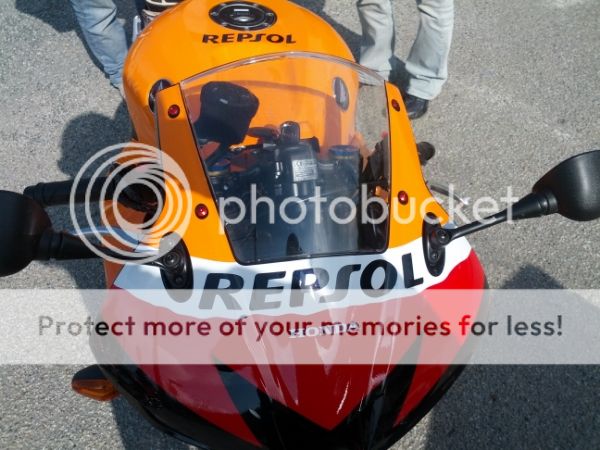

New windscreen view
New brake pump reservoir covers

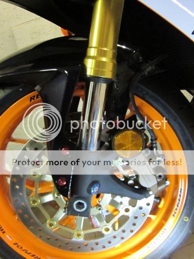

New wheel valve cup

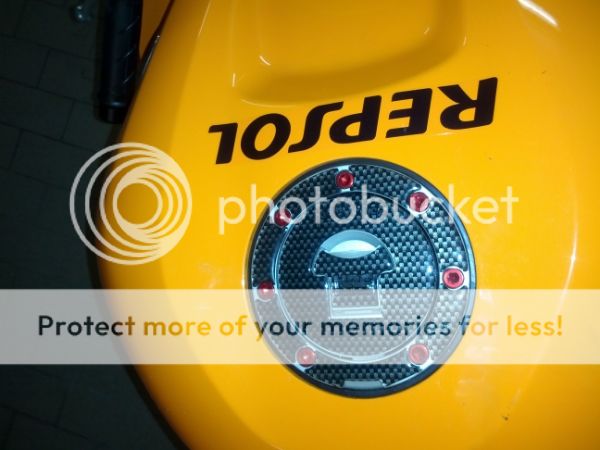

New fuel caps bolts (this is the unique kit I bought)

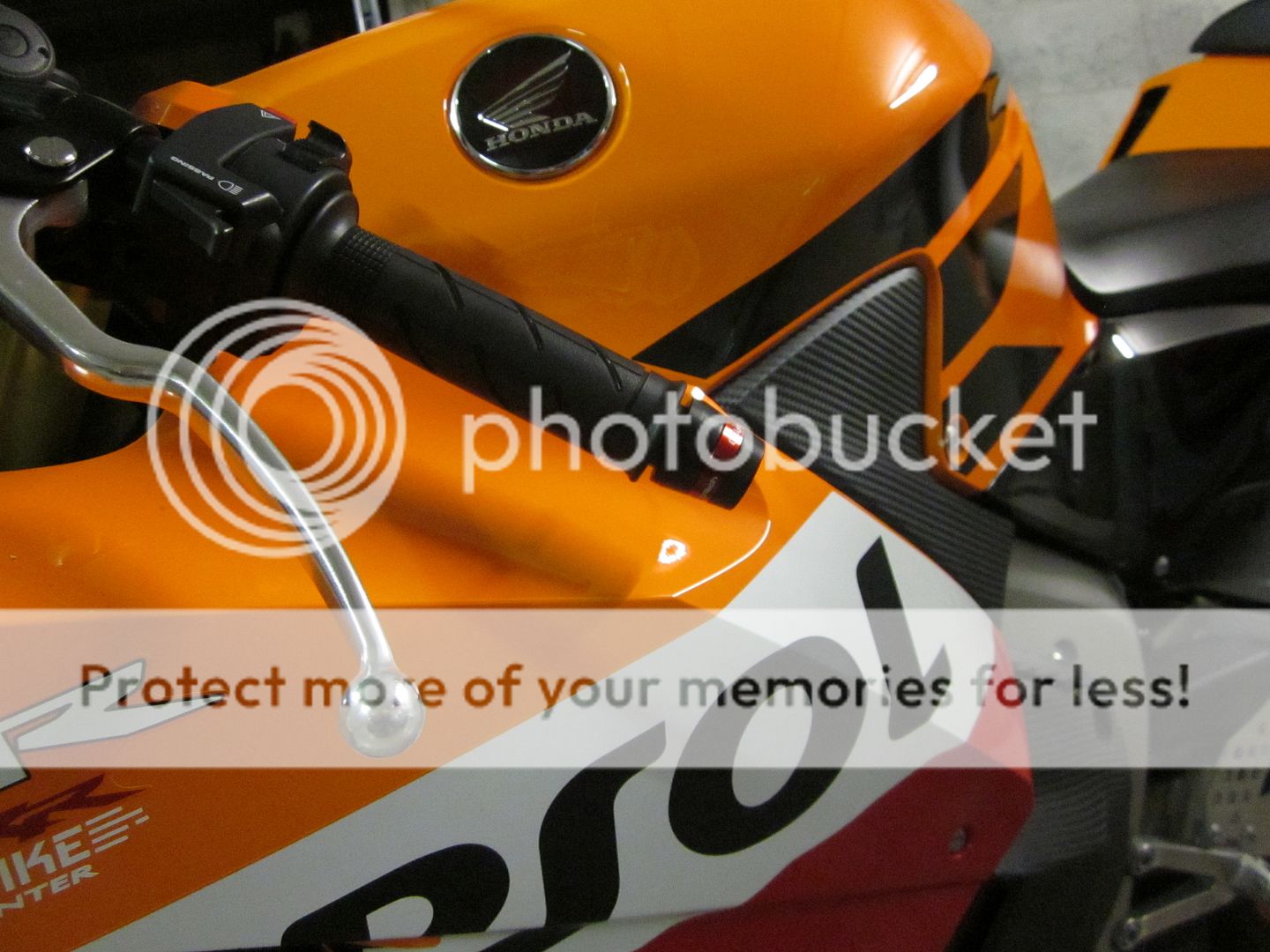

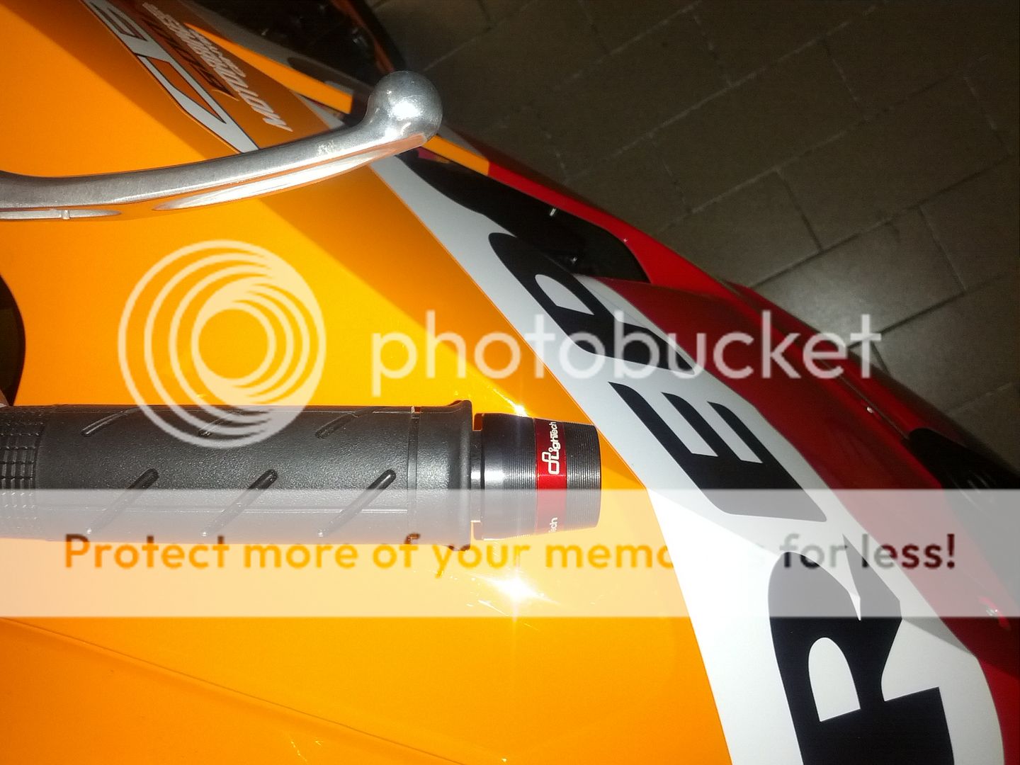

New LighTech Devil series Handlebar balancers

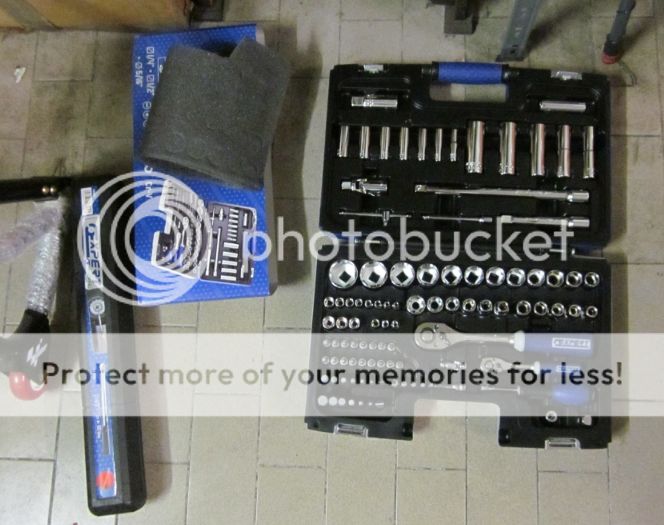

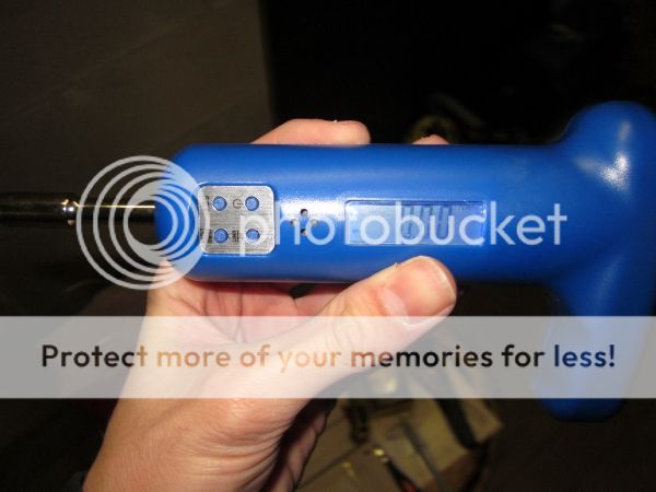

Some pics of tools used:
Torque wrenches 0-20
Torque wrenches 20-110 with multi-drive sets
Normal&generic tools

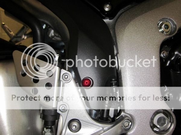

SWINGARM
Honda PN: 90113-MAS-E00 / Qty = 3
LighTech: 984

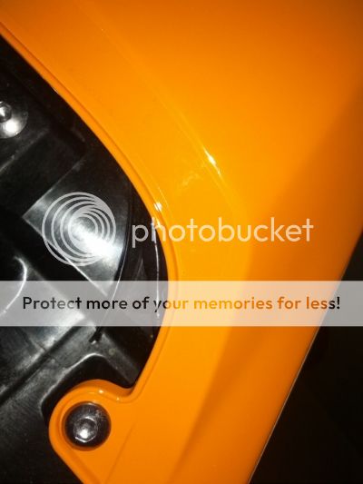

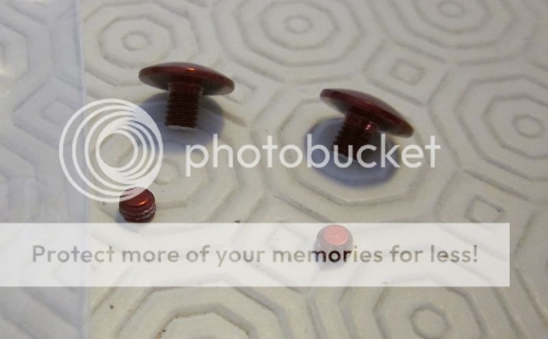

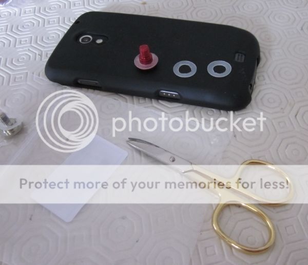

Manual adjustments are needed just on a set of screws, so here the procedure I made (with a Dremel could be more easy):
Out of the shelves
Cutting operation
Little adjustments
Use a nut to thread the screw
The end

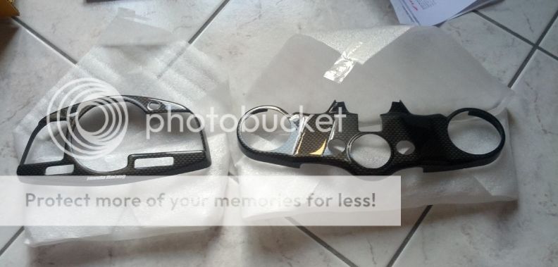

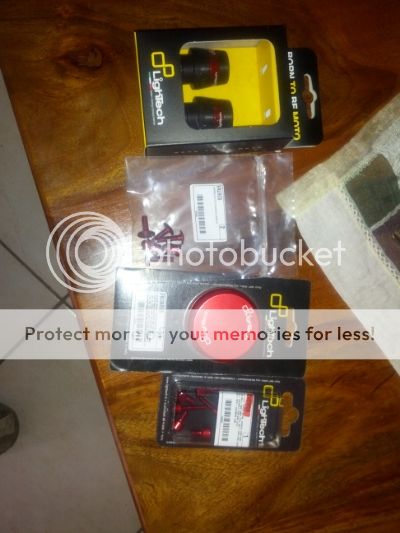

Other goodies arrived today...

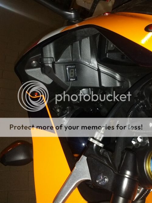

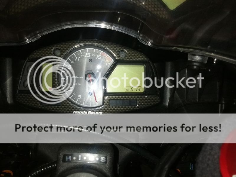

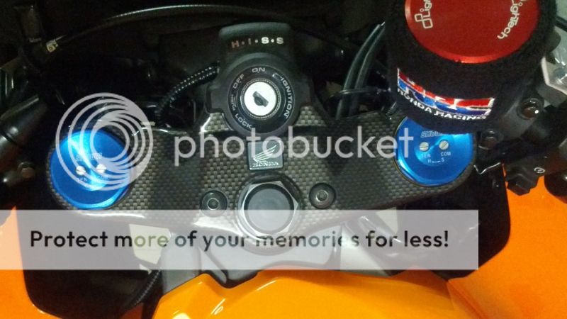

I will install the meter panel after the weekend, as instructions suggest to wait at least 48 hours before riding; the top cover maybe after I change the nut of the yoke (red Ergal of course :banger:).
Just to see how they will feat:
So the Honda PN: 08P54-MFJ-800 (Top Bridge Cover) and 08F86-MFJ-800 (meter panel) fit on 2013 version too.

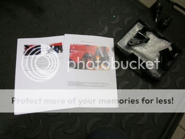

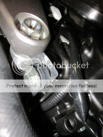

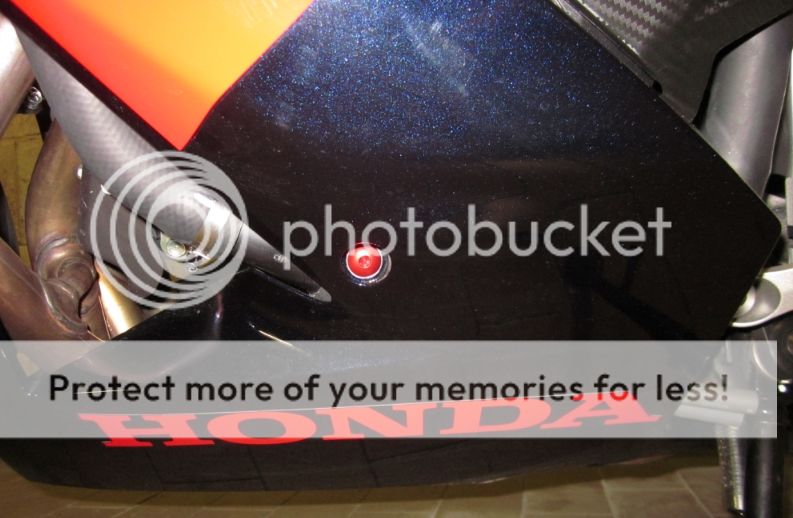

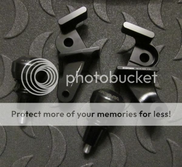

Frame sliders
To protect the bike I bought a set of frame sliders, I choose the Evotech Street defender ones. Unfortunately when you have a new bike not all the histories have an happy ending... let's see.
The package is very well done
And they appear also very good and well done:

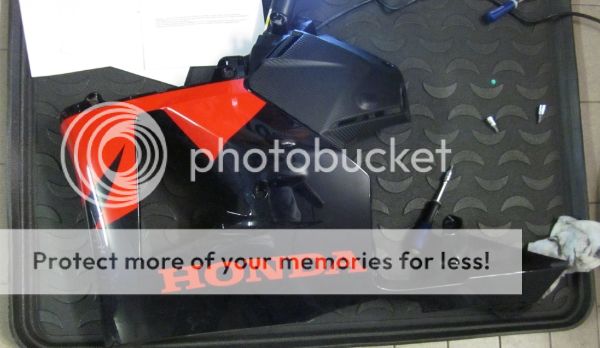

So following the instructions...

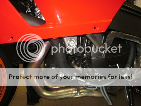

I removed the left fairing
and discovered that the ABS model has a collar different from the normal model.
  • Normal: 50194-MFJ-D00 (Honda Part Number) - COLLAR A, ENGINE HANGER
  • ABS: 50194-MFJ-A50 (Honda Part Number) - COLLAR A, FR. ENGINE MOUNT
So after many bad words, i re-installed the fairing :banghead:
Of course it happened during the weekend, so on Monday I wrote to Evotech customer service and they react very quickly and after some checks (within the same day) they just confirmed what I was expecting, their kit is just for the no-ABS model. So they updated the website and procedure to refund me via dealer has been started. They should pay me an extra as beta-tester :crackup:
Now I think i will order the R&G ones that are compatible with ABS model (I checked with them exchanging some emails)

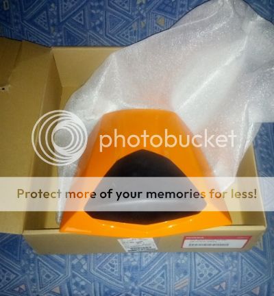

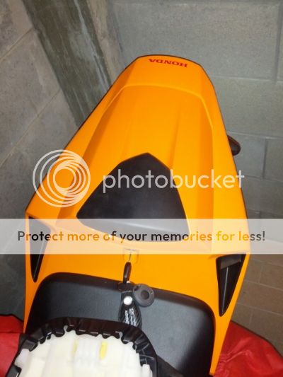

For the future mods: for sure the R&G sliders and rear seat cover (already ordered at local dealer) then other ergal goodies I think... I am trying also to find some Italian CF maker to change: heat shield, rear fender and chain guard; all at once so CF is the same.
