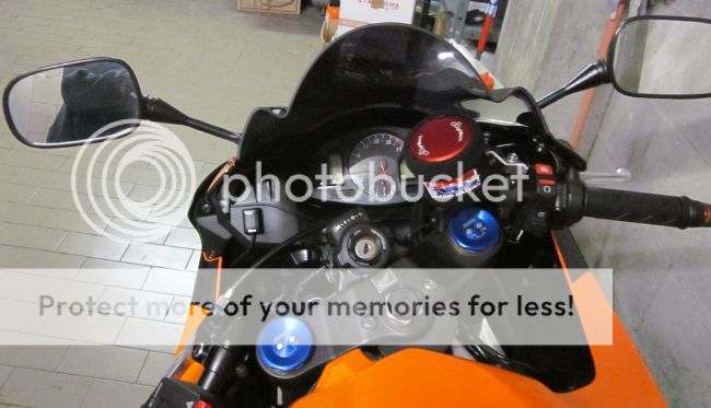

GiPro DS
Forgot to mention that in my previous CBR, I hade a GIPRO (code: GPDS-H01-RD / user guide: http://www.healtech-electronics.com/docs/GPDS-H01_Manual_en.pdf), I asked to the dealer to install on my new one.
I asked to install in a generic position so...
As soon as the Puig windscreen will arrive (Italian importer said that will be the end of the month) I will refit the GIpro; the ideas, depending on the new view of the windscreen vs the meter:
  • where it is
  • on the meter panel near the clock
  • on the meter panel above the tachometer
  • with a special bracket connected to the upper cowl.
Let's see...

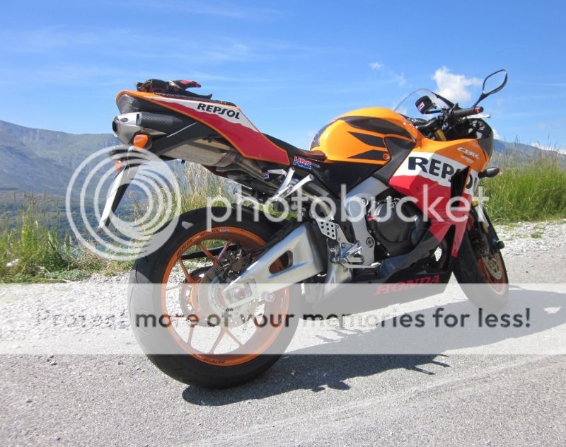

Passenger seat cowl
Some days ago the dealer called me advising that my box arrived...
Original passenger seat cowl, part number = 08F72-MJC-A00ZB (YR250)
Box opened on the sofa
Following the instructions I installed the rubber pads and the protective tape
Final result:
More photos will follow if it stops to rain!

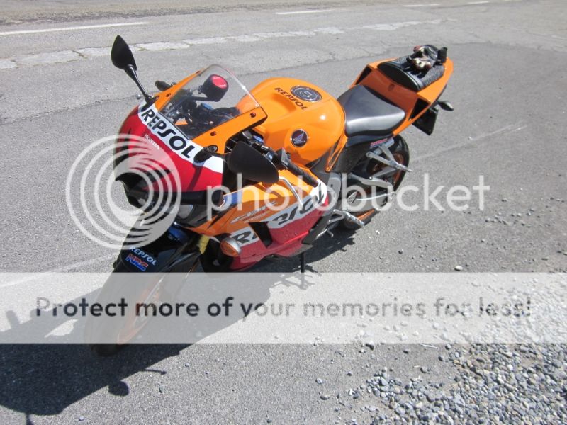

Some photos
Hi. I just posted many "garage" photos... time to post some nice pics made under the sun this weekend...
Right side
Left side
Front-right
A little bit cold but wonderful place
Coming back home with my girlfriend

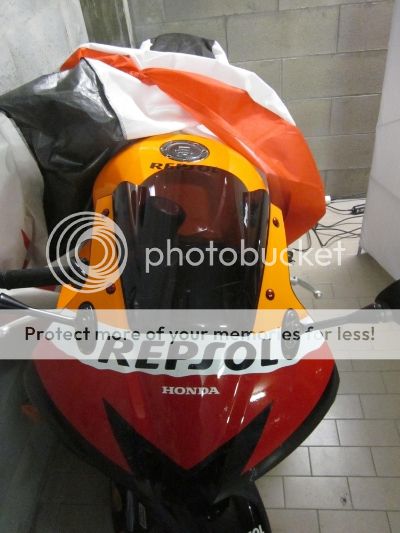

Puig Windscreen
Today I installed my new windscreen, I decided to go with a Puig Dark Smoke (Puig code: 6478F).
Installation was pretty easy: just removing the original windscreen screw and the rear-view mirror bolts.
Moving the upper nuts to the new windscreen and here we have the final effects.
Front:
Inside:
Torque values used are: 0,5 Nm for the windscreen screws and 7 Nm for the rear-view mirrors bolts.
I just had to change the two lower screws (original code: 90119-MJC-A00) because I had the LighTech ones (see some post above), but during installation I put the 003-M5-20 (the original screw was of 23 mm). So due to the difference (I suppose 2 mm of the new windscreen) I was forced to change both with LighTech 003-M5-25 (I will update my post with the LighTech vs. original resume).
I will post a product review asap.
