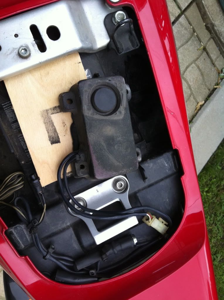

Hi Just bought a cbr600rr 03 and the seller told me I had to change the battery ! I changed it last week ! I never touch the bike since, and today I took it. It starts great..did a 15 minutes run and come back home... I wanted to change the clock but my buttons doesn't seem to work...so I had the idea to re-start the engine... and the battery was dead... battery is new and 15 minutes before everything was alright... can it be my anti-theft system that drain the battery ?
It has a Merlin 2000
help me... im sure it is not normal that the battery was draining like that ... :ponder:

charge it up.. disconnect the alarm, and let it sit over night then try to start it.
51,151 Posts
Alarms are pron to suck battery juice and for bike batteries it would not take much to kill the battery even a short test for new Hid lights or a new set of turn signals without the engine running will drain the battery dry i would follow crash's advice and see what happens

Ya I say you have a short somewhere... Likely caused by the alarm

what makes you say that?
and moeman .... I just remember something...when I change my battery... I never put a charger on it before like it was said on the sticker on the battery ! I put the battery in my bike just to make sure everything was alright and since I never put it on the charger...
109 Posts
I dont think so... because it was parked like 3 weeks and it starts like a charm... if I had a short somewhere my battery would be down....
13,137 Posts
Not likely to be caused by the alarm...
When you left the bike on for 10 mins, you can't forget that the headlights would have been on as well - this is what drained your battery, and there is nothing surprising or abnormal about that.
Your bike is fine, your alarm is fine, your battery is fine (once it has been charged). Just remember that the headlights come on when you turn the key on.
