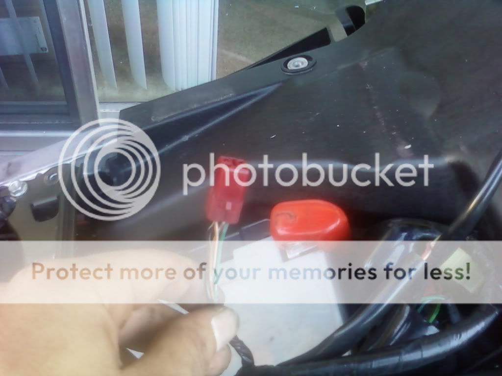

alright so ive recently wrecked my bike, im kind of a new rider so its whatev. totally bent the subframe and damaged the front end rather bad.

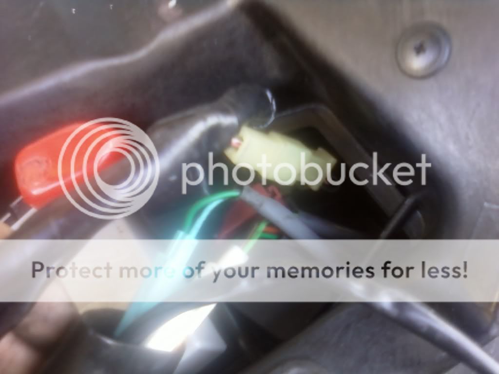

basically i waited like 2 weeks to install the new subframe and i cant remember where this plug goes. if anyone could help me out id be grateful. additionally the blinkers do not blink they stay a solid color. im thinking this could be due to my ghetto wiring job with my new led blinkers but somethin tells me im fine. anyways heres some pics to show u what im workin with
these are all the ones i found a home for

That is the DLC and is only used for diagnostics. It plugs into nothing.
