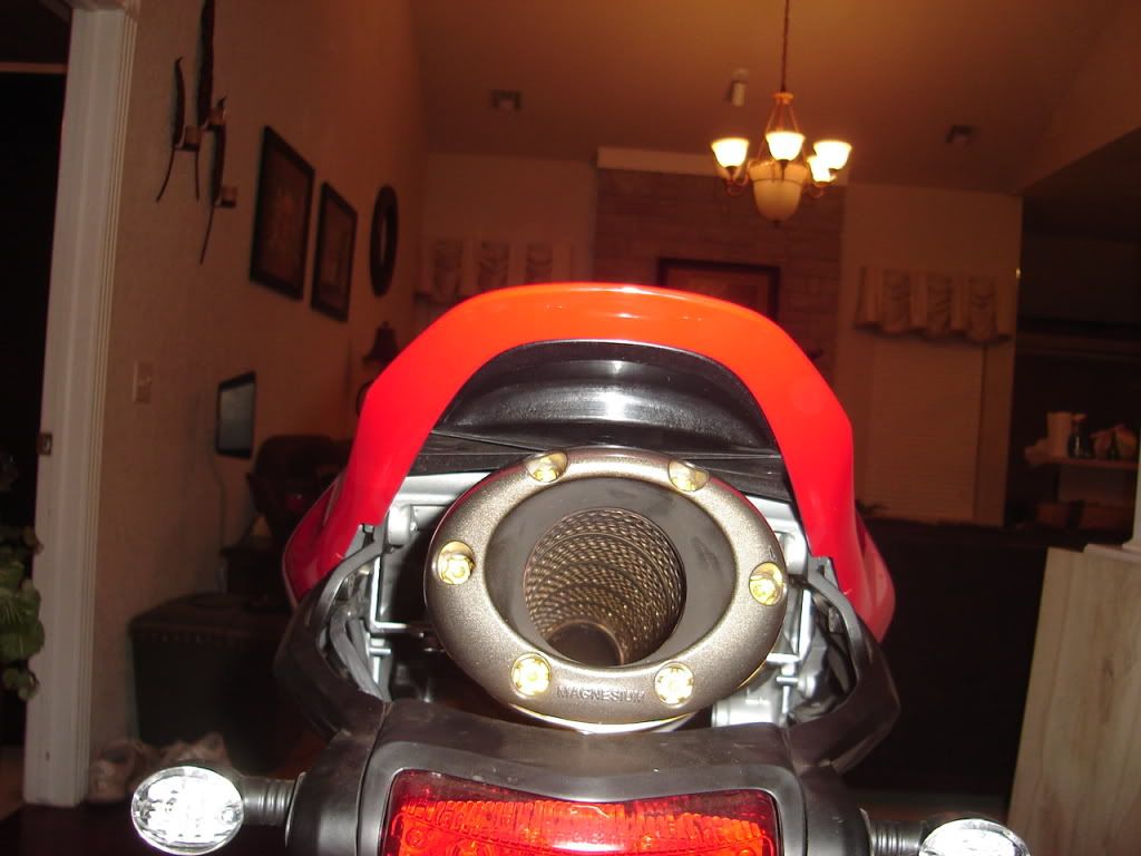

I have the Two Brothers Carbon Fiber slip on and I hate how much it sticks past the tail of the bike so this weekend I am going to cut the pipe down by about 2 inches
I am a carpenter and I have a extra miter saw I am going to put a brand new steel tooth blade on (sharp and one time use in this case) to cut the carbon fiber and steel core.
plan is to drill out the rivets, tape the entire pipe mark where to cut then also put the cut on a 1-2* so the tip will be centered, hoping that the tape and high speed of the saw will cut the carbon fiber nice and clean and not fray it also keep the cut strait on my line. then drill holes for the rivets, re rivet the back peice on and re install.
I will post up some pics of before, during and after. I might do this Friday because I am thinking I might take that day off.

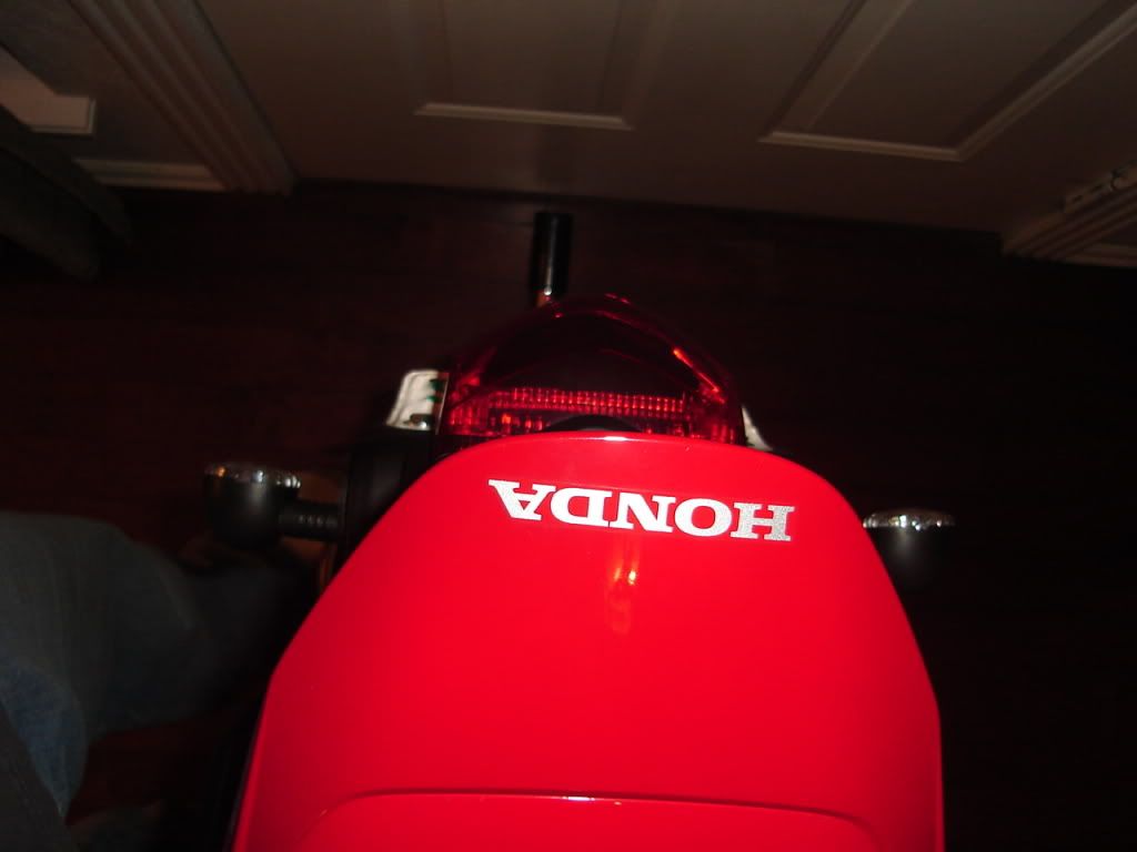

yea it sticks out that much too, but the main reason is when my put a tripage light in there and do not want the tip of the pipe blocking the light, I want if the same as the arka exhaust

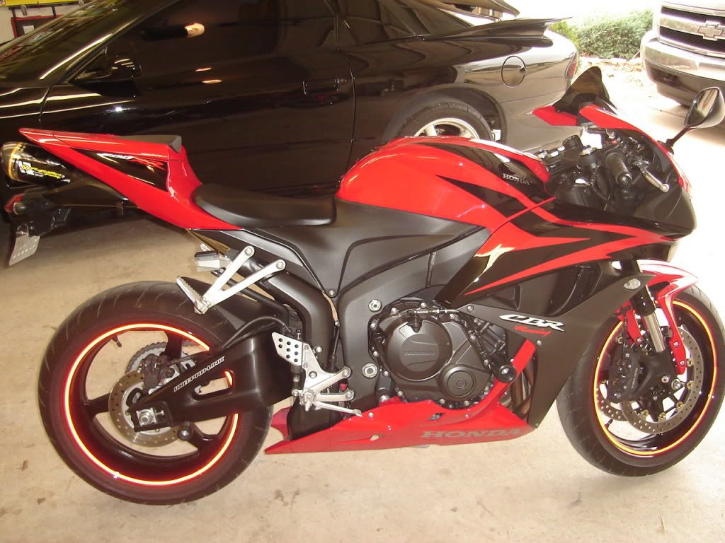

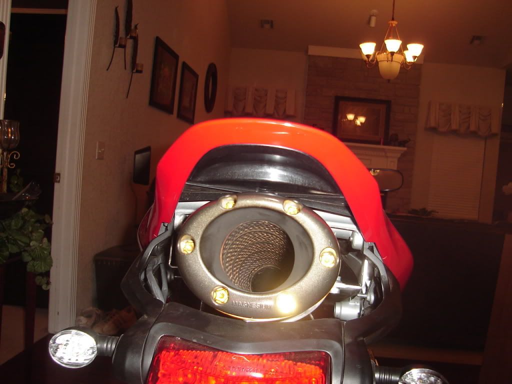

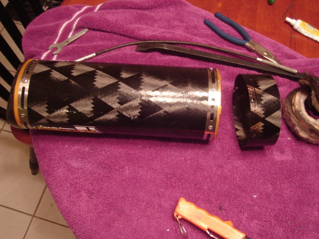

ok got it back together and it freaking looks 10X better
I am uploading pics will be up shortly
also this is was alot easier than I thought and than most make it sound
as long as you have the right tools.
it took me a total of 2 hours work time from start to finish

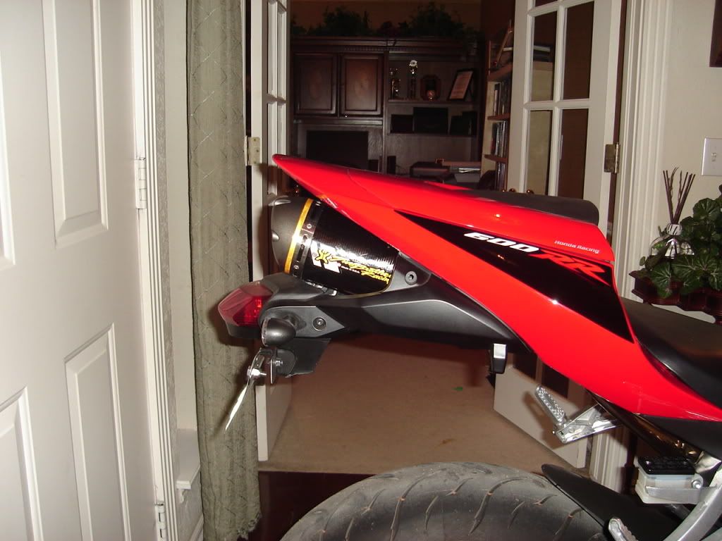

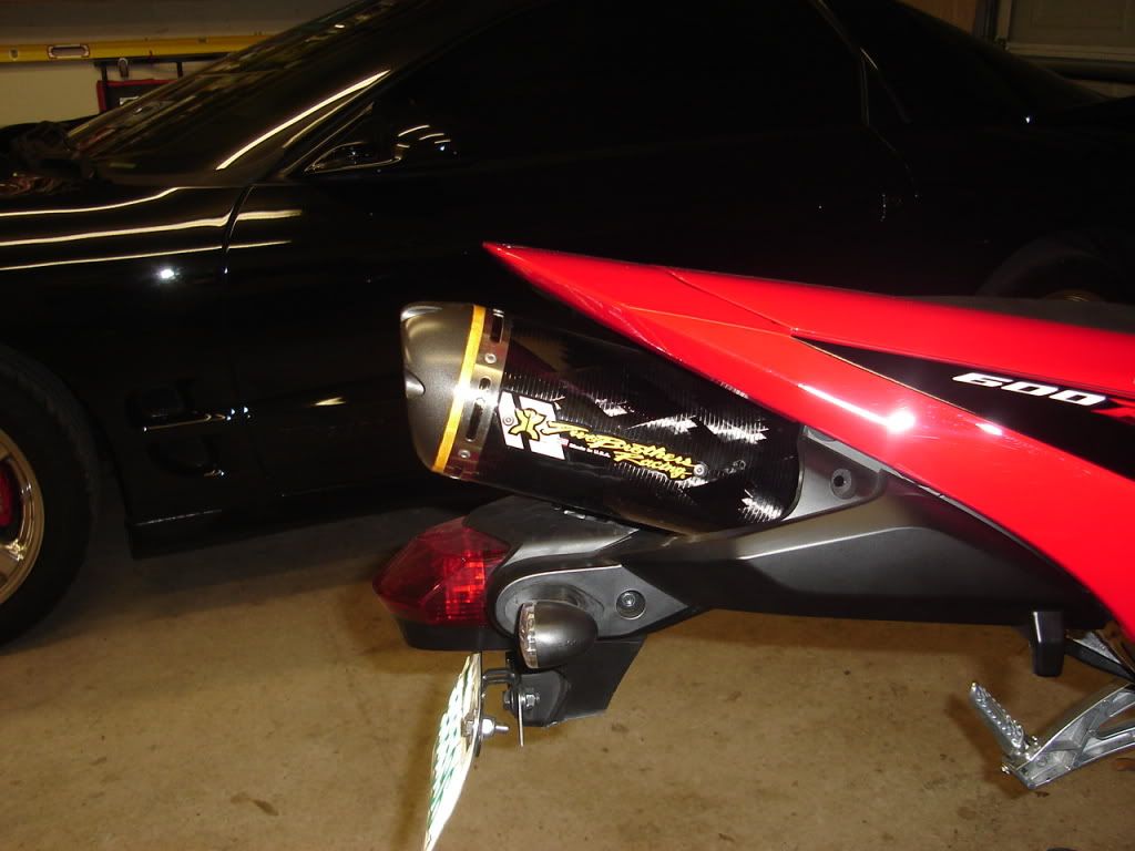

Discussion Starter #19

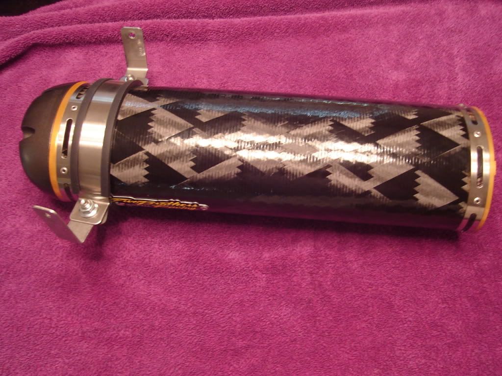

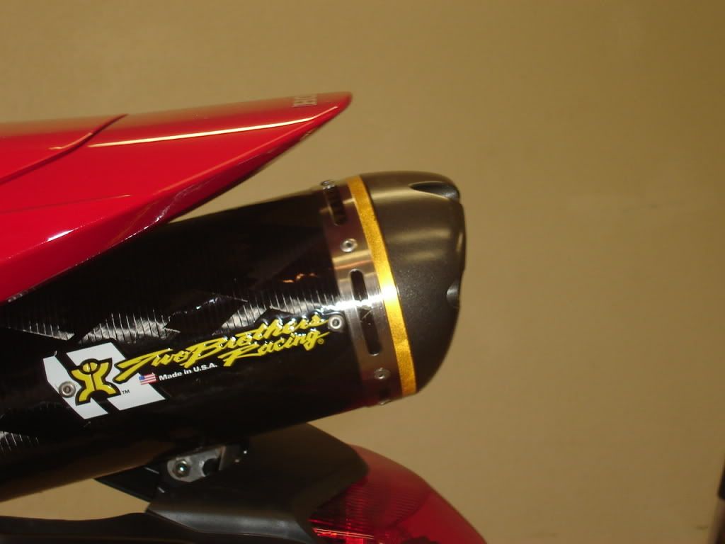

before pics
135 Posts

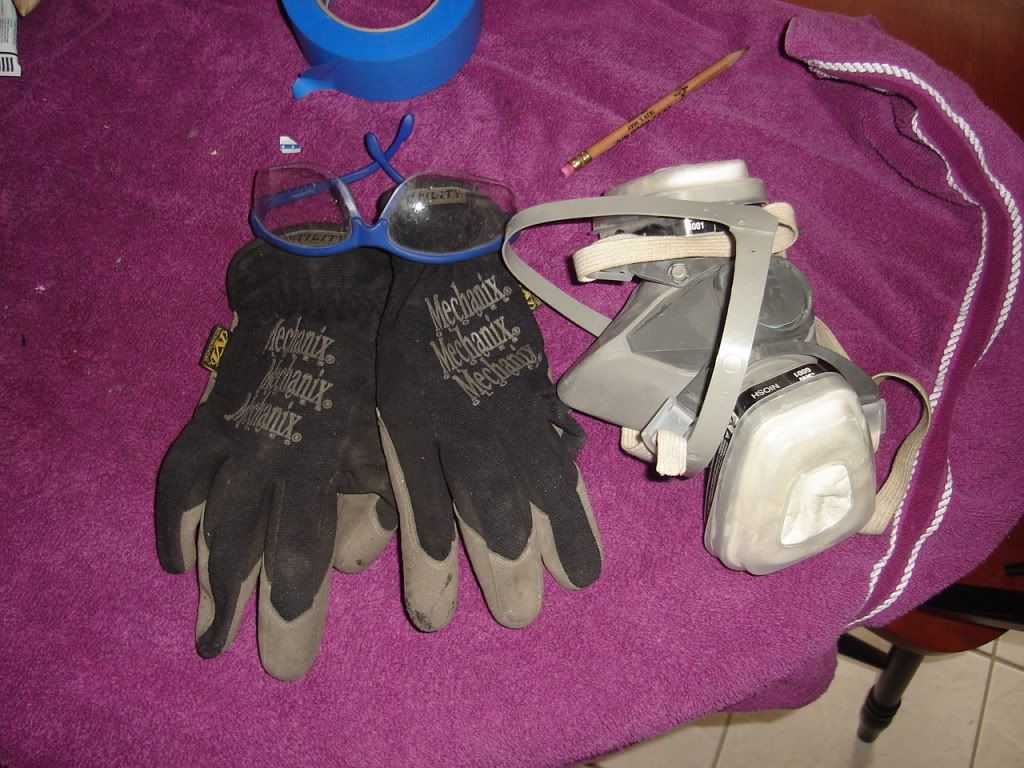

safety stuff
Protect you eyes, lungs and hands

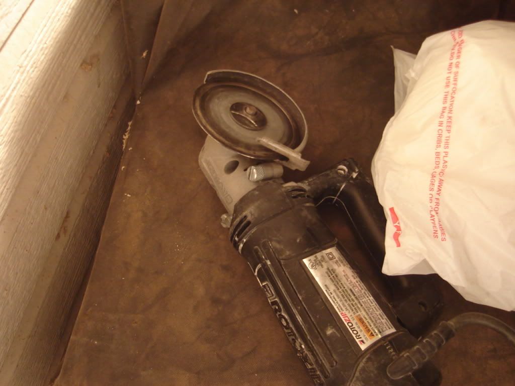

My cutting tool of choice is a diamond cutting blade on a roto-zip cutting tool (this is for the carbonfiber)

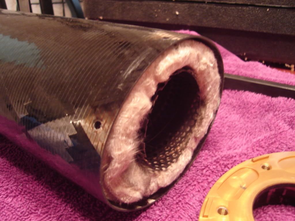

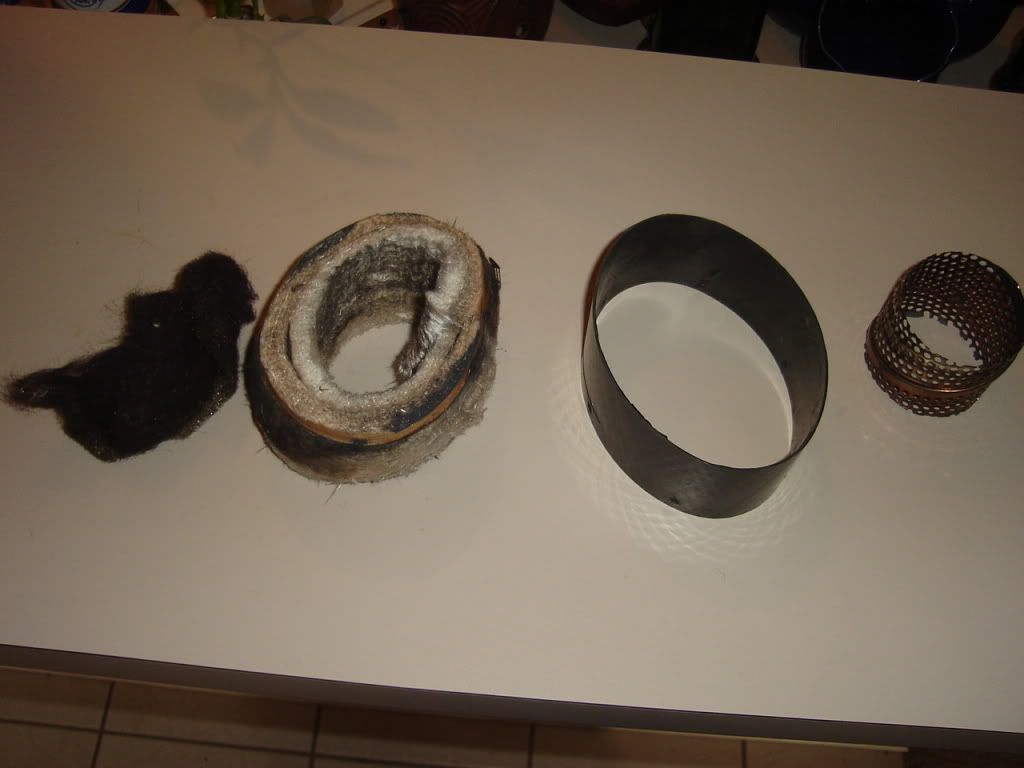

Pipe off
drill out rivets with 1/8th inch drill bit
pop back plate off using long prycar threw the pipe and tap with hammer, this might take a little bit
and of course what project would not be complete without blood!!

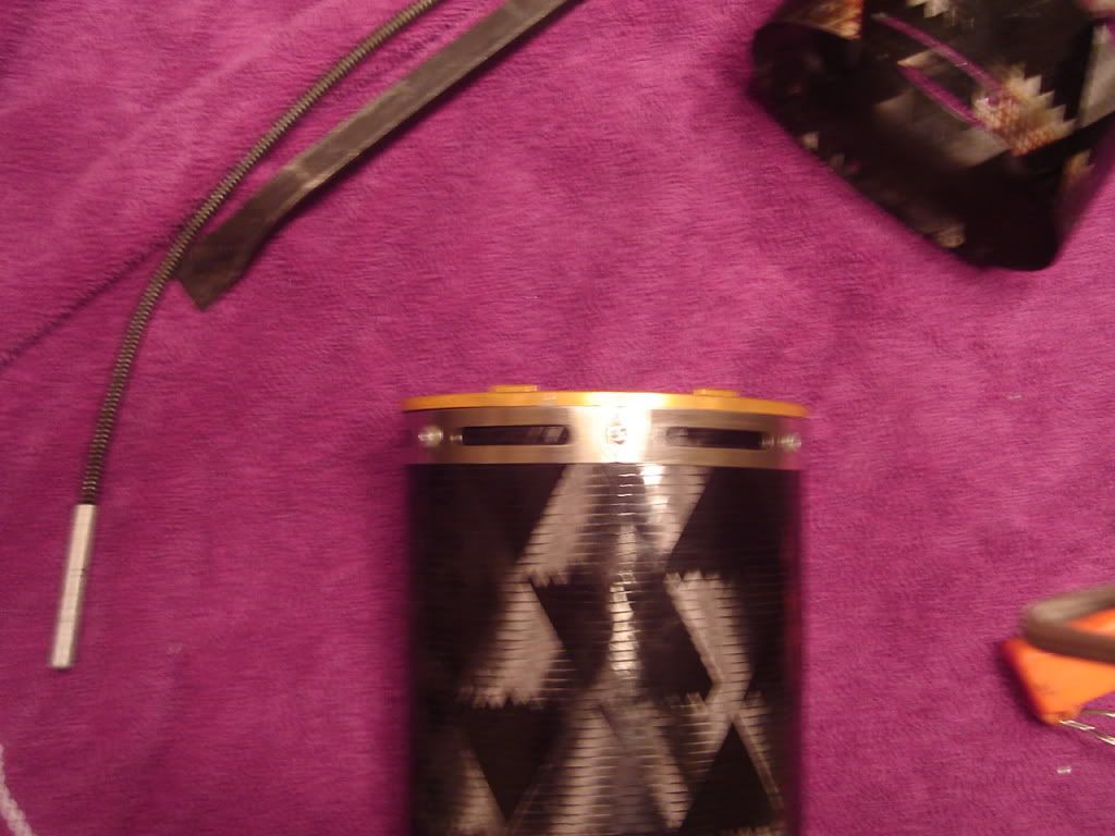

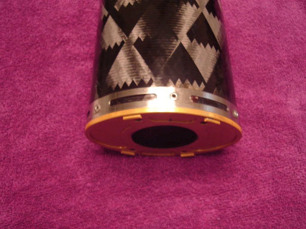

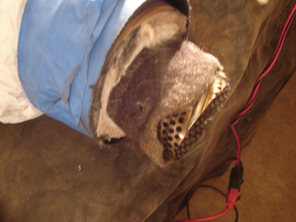

once the back is off this is what you have

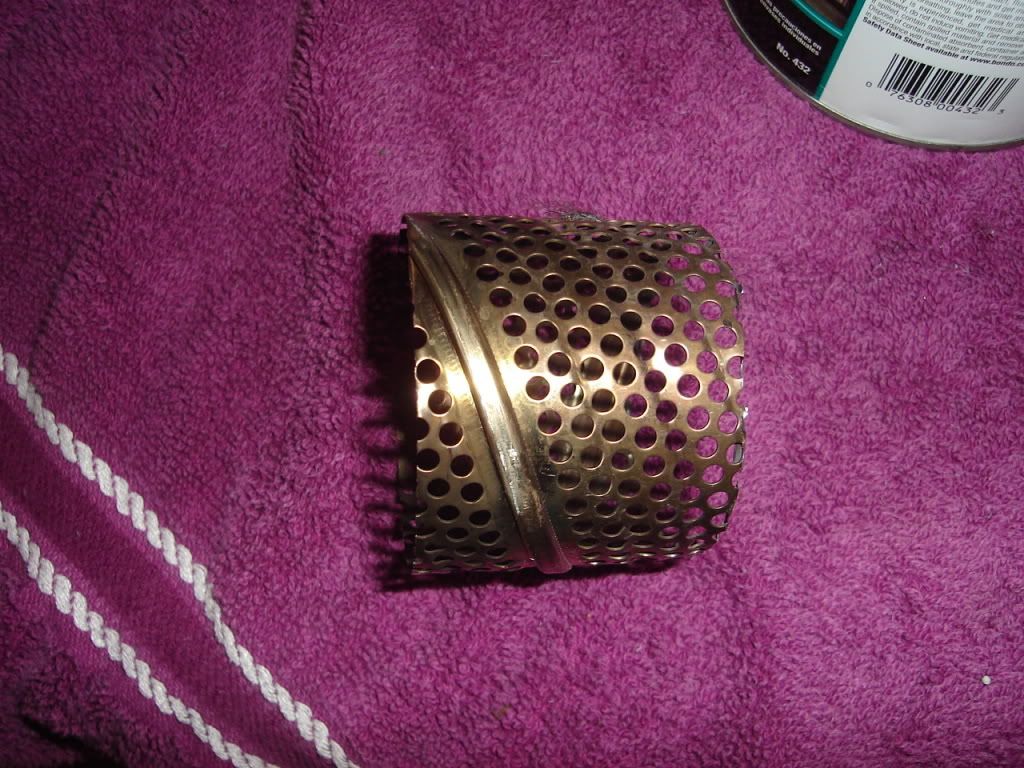

next cover the pipe well I used a T-shirt and plastic bag
this is the cutting tool and blade
