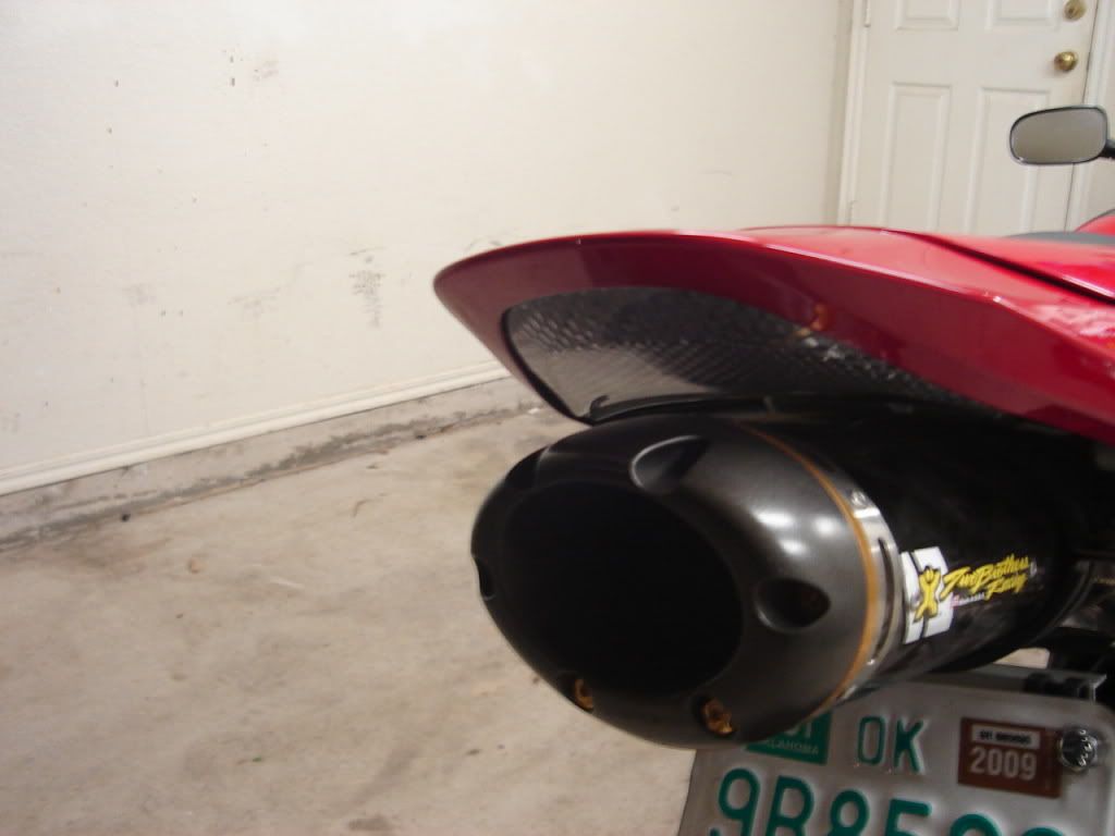

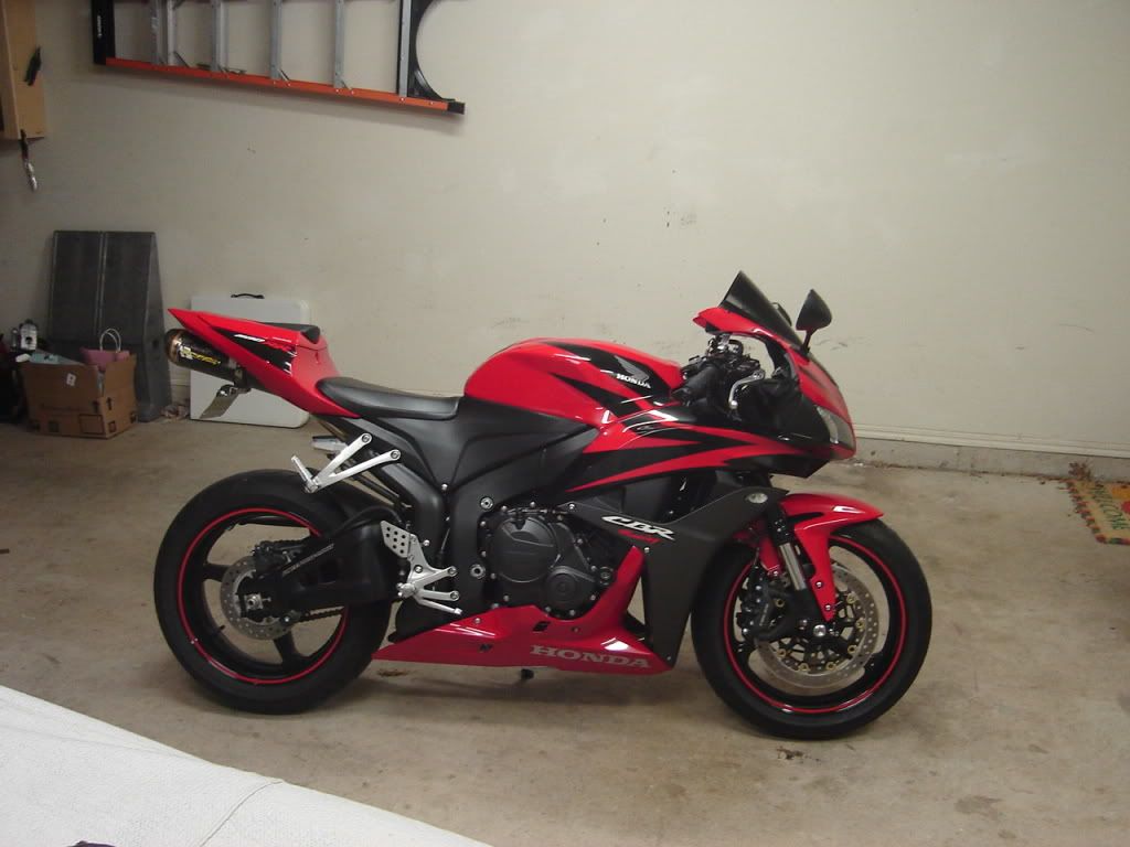

once the carbon fiber is cut then cut the packing and this is what you have
get the metal blade on the cutting tool and take you time cutting threw the core pipe
take hammer and a block and tap the back, back on
this is all the stuff that you should have cut off
then drill the holes out in the carbon fiber with 1/8th inch drill bit, make sure they line up with the back plate using 1/8th inch pop rivets and rivet the strap back on
and now re-install the slip on back on the bike and this is what you have
yes my bike is in my house and I have not had a chance to fire it up so I will do that tomorrow and might make a video of it and I also will get some better finished pictures
I cut 2 inches off the pipe but since it was off center from TBR I also took a 1/8" more off the left side (left when looking at the bike from the back) to center it on the tail
I could not be happier with this finished project, and it will be even better with the Tripage light on there
let me know what you think or if you have any other questions

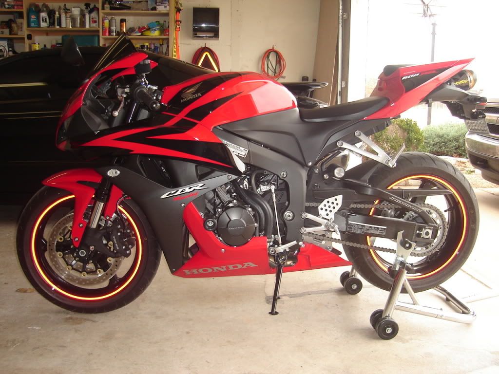

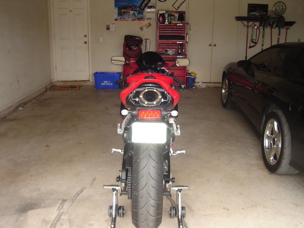

Comparison pics
1,066 Posts
That looks real good man! I'd done the same if I had an 07+ with 2bros!

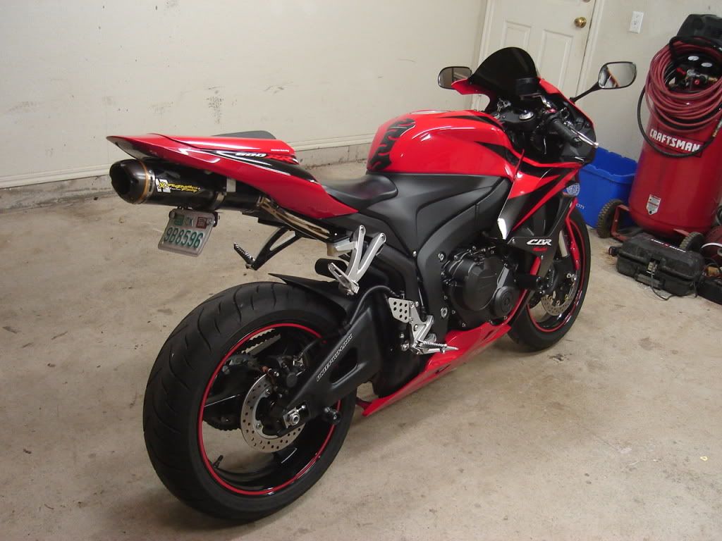

Just got up, I will get a little vid of the sound in a few hours
135 Posts
Discussion Starter #29
I can't decide whats hotter the CBR or that very sexy WS6 in the background. I like your style man!
Thanks, I love my car, I'll get a couple of pics of it up for you with the video

Ok I jsut got back from a nice ride and it is definately louder now, not alot but it is
I might get the insert to quiet it down a bit

it looks really good.. Alot better from stock. My question is why didnt you cut the mid pipe? or you cant? I have an 05...so i dont know what the 07 pipe looks like.
135 Posts
Discussion Starter #39
Thanks, the mid pipe is one peice and the way it bends it would have been alot harder to do it that way.

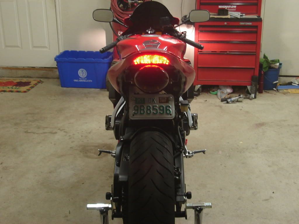

here's what it looks like now with a CA light
