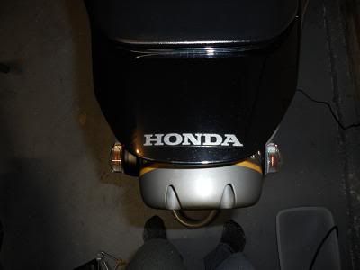

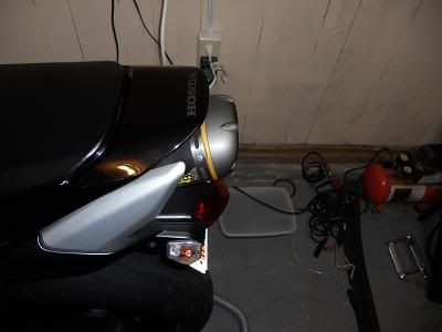

Your bike is an '08 but I have a '09 with the same setup and mine don't stick out nearly as much. It don't look too bad on my bike so I'm not going to chop it. Here are some pics.
