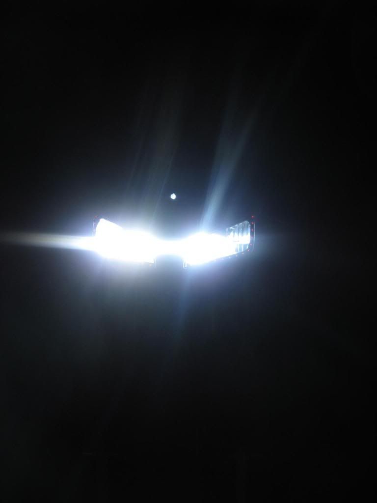

in the meanwhile, if you had have any experience with DDM'S service or warranty, go ahead an add on to his thread. Below are are pics of my first set; 55w, 5000k .bright white !!

update:
looking great so far, i will take the faulty ballast and go double check it again, then i'll ship it in.
