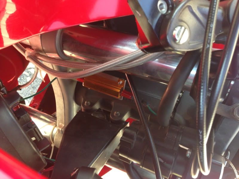

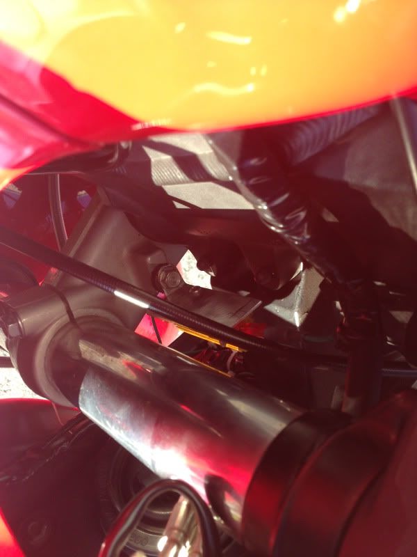

Update:

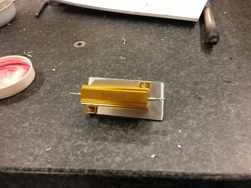

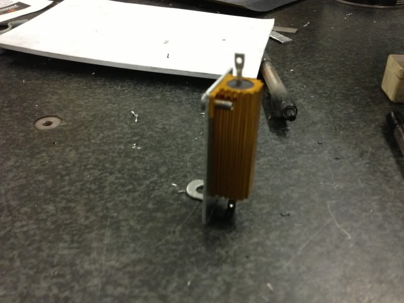

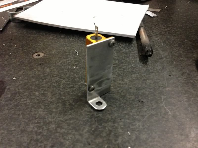

I am just getting around to doing this. I had a 1-Ohm 25 Watt resistor that I installed between the low and high beam positive leads. It works perfectly. I took an amp draw through the resistor and I get about 3 Amps when the switch is to low beam, and 0 Amps when switch is to high beam(of course since current takes the path of least resistance). Now that I have the number of Amps, I calculated that I really need a 40 Watt or greater resistor for this application. I left the 25 Watt resistor in the circuit for testing and it works but it's getting waaaay too hot. If I did leave it like this, the resistor would eventually burn up and fail.
I just ordered a 50 Watt resistor. I'll post up an update when I get that installed.

You don't need a relay. You just need to run a wire from the positive lead on the low beam bulb, through a resistor, to the positive lead on the high beam bulb. That's it.
:poke: How long have you been running this setup? Where did you get that mounting plate? How would you rate the Low beam, in terms of blinding on coming traffic? Would using diode be a good idea on that line?
