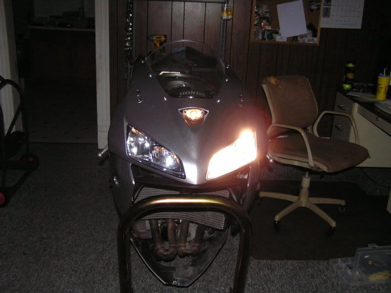

I use the pitbull front stand too- here's a pic of it while I was doing my fork seal, which is turning into a bunch more(racetech springs and revalve, and one of my fork tubes was bent a little)

had my forks done @ a shop but when i removed my forks before...
a stable rearstand and a car jack will do, as long as you dont move or bump into it.
what is the jacking point? i cant tell, it looks like your jacking it up on the exhaust, but im pretty sure that cant be it.
I used to jack up under the header on my r6, its strong enough.
