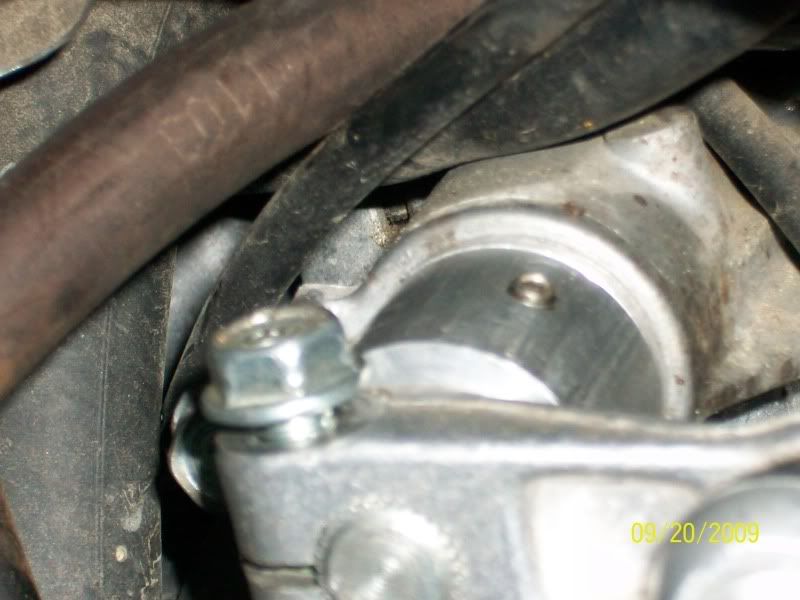

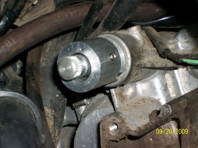

I replaced my rearsets and had to replace the gearshift arm and pedal. I took the old arm off of the gearshift spindle and tried to put the new one on. As I was pushing it into place the spindle itself actually moved. It slid about 1/2" into the bike. I can grab it with my hand and pull it back out where it should be but it sure doesn't seem like this should happen. Is something horribly wrong? I should note that I recently replaced the clutch cover as well. It went smoothly and I didn't actually touch the clutch so I dont think there should be any problems from that but I suppose it's possible.
11 Posts
I can shift when I pull it outward where it's supposed to be. If I push on it, I can no longer shift. I figure it's possible that it's supposed to do that, it just seems pretty easy to take away the bike's ability to shift.
11,156 Posts
eek! that happened on my friends 2006. it's not supposed to be able to slide in. there is a tab on the opposite side of the engine that keeps it from sliding into the clutch on the other side.
11,156 Posts
i had to take off the engine case cover from the other side. take out the clutch basket and i just bent the tab back into place. check out the schematics to see what im talking about. with his bike it was cause by a light tap with a hammer to try to get the linkage back on. wasn't going smooth so he gave it a few taps. that was enough to mess it up though. after the hammer it could slide back and forth. once he started the bike and the shaft moved towards the clutch side, you could hear a horrible clicking, knocking, pinging sound.
936 Posts
11 Posts
Sounds like that's it. Thanks a lot.
