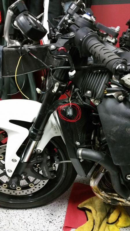

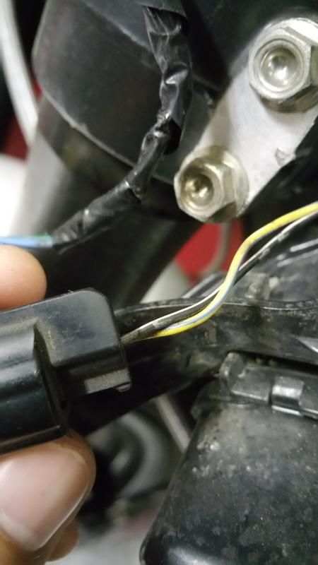

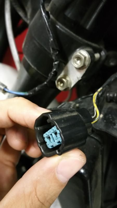

Hey! New to the forums and just picked up a 2007 600rr coming from a kawi.
I was wondering if someone could help me pinpoint what this plug is for. I have a FI code for the MAP and Knock sensor if it matters (currently fixing). The bike has a Bazzaz FI and AFM installed too. Bike runs fine, but I have it apart just to give it a thorough look. From the wire colors it looks like it may have something to do with the fuel injectors. I circled its location in the first pic.
BOTY 2014 Winner
4,825 Posts
pretty sure that's the pair solenoid. based on location. it's likely the previous owner deleted it
being unplugged won't trip the fault indicator.
6 Posts
Thanks! I just checked the wiring diagram and it looks like its the correct wire colors for the pair valve! Case closed. Thanks again.
