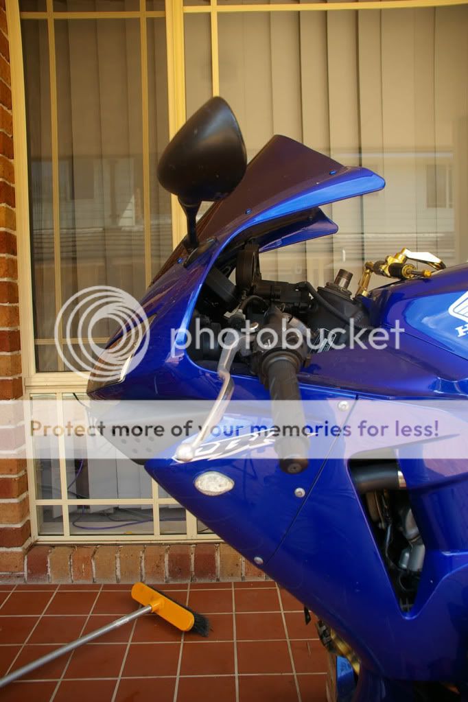

I couldn't find a how to for this particular job so I thought I might put one together for you...
Well first question to answer is "How do I tell if I need to replace them?"
This is an easy thing to check, put your stand down and rock the weight of the bike onto it so that the front wheel comes off the ground, then move the bars from left to right. It should move smoothly through the full range, if you feel a notch anywhere (usually in the centre) then it's time for new bearings.
If you need to replace them, read on... and yes I know my bike needed a wash, I did that as soon as I had finished doing the bearings...

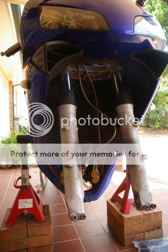

Getting the front off the ground:
First thing is to put the rear on a stand, then get a piece of wood to go under the headers and use a jack to lift the front end up, if you have frame sliders it would be a good idea to support the bike from those, exactly as I have done below.

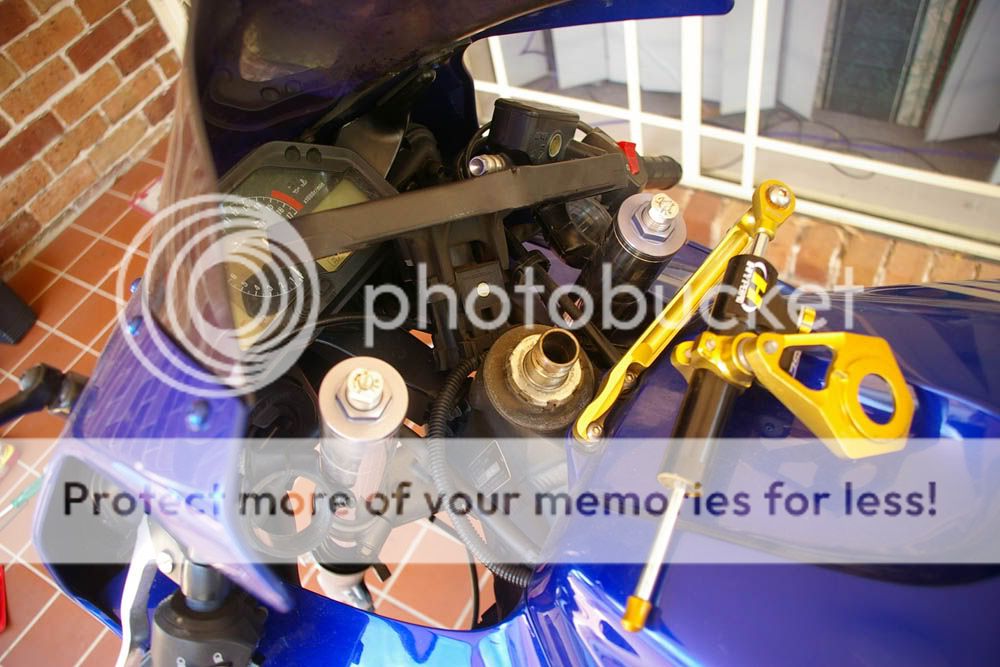

Remove the top triple and clipons:
Next, undo the top triple clamp and clipons and remove them, you don't need to remove anything from the clipons as there should be enough play to allow you to remove them.

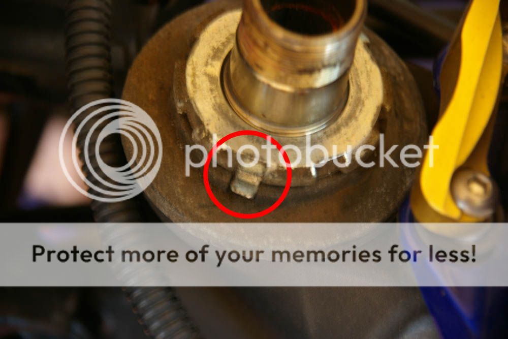

If you look at the top of your head stem tube you will see two nuts, and between them is a washer with some tabs on it, you will need to bend the tabs off the top nut like this:
Once you have done that just use a c spanner or a hammer and screwdriver to spin the locknut off completely.

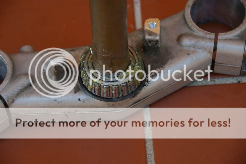

Remove and set aside the top dust seal, you will need this when you put it all back together. remove the top bearing race and bearings. These can go in the bin.

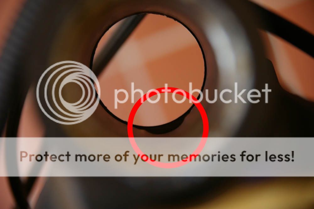

If you look down the stem you will see the bottom race and an indent that has been provided to make life easier, just use something like a screwdriver or a piece of round bar to knock out the top and bottom races. Don't hit it to hard, lots of small hits are better than one big one because you are hitting the side of the race it will try and twist in its housing possibly causing damage. Here is where to hit it:

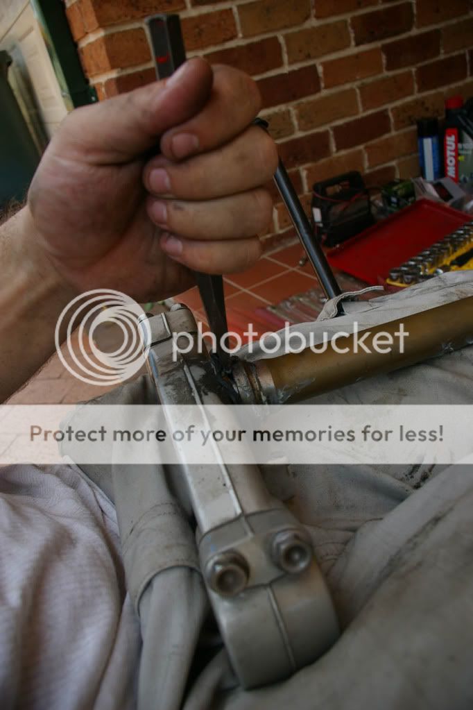

Removing the bottom race from the stem tube:
This will require a little patience and care, what you need to do is hit a cold chisel down between the dust seal and race, being careful not to damage the stem tube. It will take a while but it will come off. After the race is off, remove and discard the dust seal as well.
If you do damage the stem tube with the cold chisel, don't worry it's not the end of the world, just take a smooth file and de-bur it.

Well, your now ready to start putting it all back together, first thing is to grease the new bearings up, here is a video of how to do it properly (just a random bloke on youtube who is doing it right)
Next thing is to put the new dust seal (with the lip facing away from the triple and race onto the stem tube, there are a few ways to seat the new race but the two best ones are to use a piece of pipe to go over the stem tube and sit on the race and either a press or hammer to seat it all the way down.
