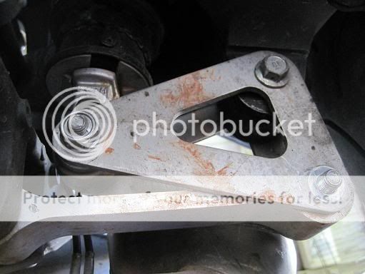

Hey guys. I always seem to come here if I have bike issues; sorry about that. Anyway, I've been trying to install my lowering link all day; however, taking the stock link out is difficult. Although you should be able to just remove the rear bolt then the front bolt, there is an obstacle for the rear bolt. I unscrewed the nut for the rear and the bolt is sliding out. Unfortunately, the bolt will not come out the right side of the bike because of the exhaust pipe being in the way. You can see in the photos below. Anyway, I noticed a triangle link attached to the "dog-bone style" stock link. This sounds stupid but is that triangle link a stock part that is supposed to be attached there? I know lowering links come in triangle and dog-bone shape; but I see both. I was thinking of unscrewing the triangle as well to allow me to move the links down so I would have room to remove the rear bolt. Or should I be leaving the triangle alone? Any advice would be much appreciated!

I think whoever did the exhaust work on the bike was retarded. I think the hex screw for the rear link is in the opposite way; so, it comes out where the exhaust pipe is in the way. I can't take the bottom part of the exhaust out since it's pretty big and attached at a lot of points. I'm going to get a bolt cutter and cut through the hex screw and buy a replacement hex screw at Home Depot. Now the tough part is finding a damn hand saw or some tool to cut it... the expenses and problems are slowly getting to the point where I'm getting sick of this bike...

Home Depot will not have the correct bolt to replace that if you cut it. I strongly suggest you do not. Undo the mounting points for the headers and remove it. Trying to save time and money by taking "shortcuts" is only going to cost you a lot more money in the long run. Either do it right, or take it to someone who can do it right. Also, the bolt is in the correct way. It may seem like it's a stupid thing for a bolt to be in the path of an object preventing it from coming out, but the engineers do that for a reason. What if the nut falls off? If it were in the other way, there would be nothing in the way that could possibly prevent it from completely coming out leading to a major failure before the rider has a chance to slow, pull over and stop.

When I replaced mine I had the same problem! Its easier if you have two people to do this. What I did to get that bolt out is take the nut off the bolt that goes to the swingarm. Then have someone lean the bike over on the kickstand till the rear tire comes off the ground. Then pull the bolt out that goes through the link on the bike side then the one that goes through the swingarm and that whole triangle thing drops down enough to pull the bolt out. But with the setup you have ( bike stands and jack) you should be able to do it your self.

Don't cut anything, remove the exhaust or compress anything either. Remove the other 2 bolts in the triangle and drop the third "backwards" bolt down and remove. it.

I looked everywhere at Home Depot (just in case) for a hex bolt the same size as the one in the link. They don't have one for some reason. Anyway, I lifted the bike and the exhaust pipes are won't budge and are firmly in place. I'd literally have to take a big part of the bike apart from the looks of where everything is attached.
I tried to unscrew the top hex bolt from the triangle with the ratchet but there is barely enough clearance to move more than an inch; and when it is in there TIGHT. I can't move it and have no room to give it impact with my foot. I am going to try to get a hold of a power drill and to unscrew it.
