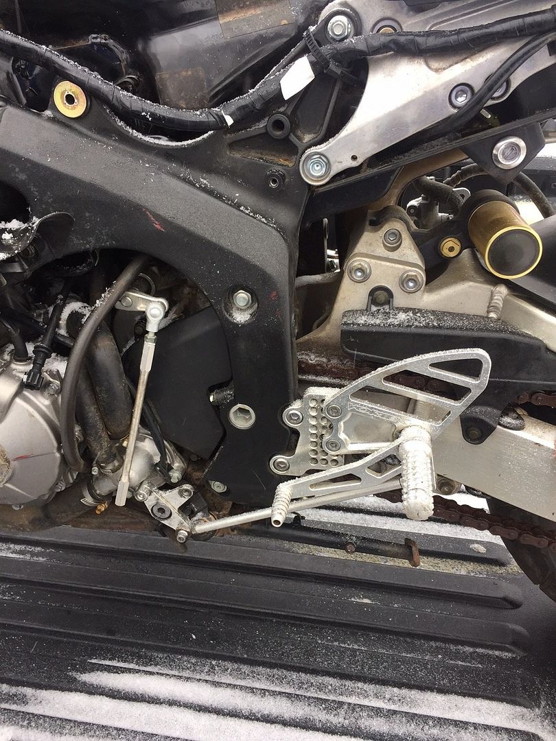

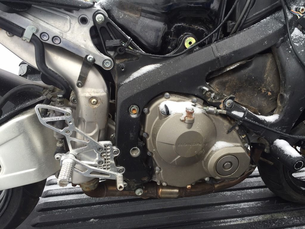

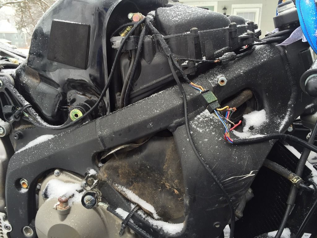

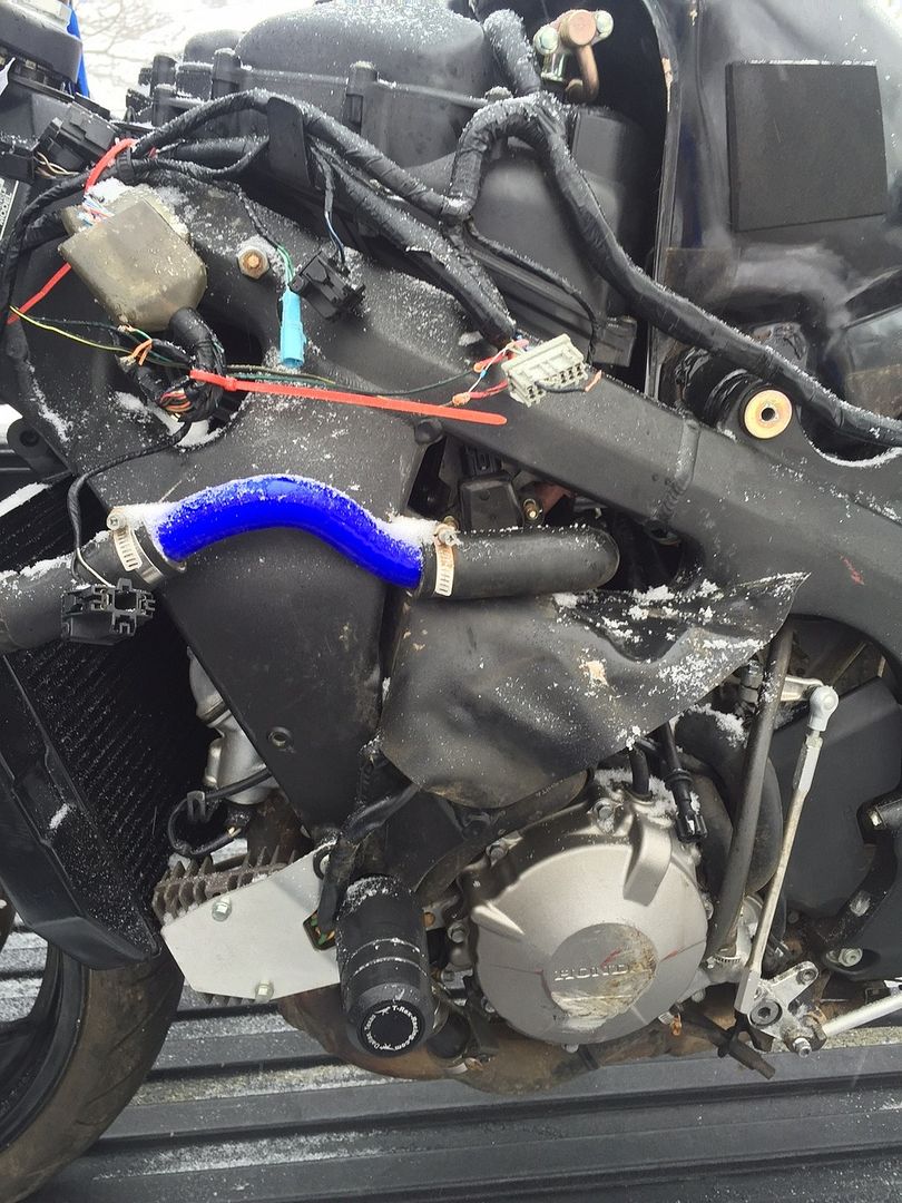

Anyway, I sold the silver '05 and picked up this basket case '03 last night. I got it super cheap. The wire harness has been hacked on so bad, I'm just going to completely replace it. I have an uncut used harness already ordered. It needs a lot more, but I want to hear the engine run before I do anything else. I figured I'd change all the fluids and sort the electrical and go from there. I need to clean the shop today and get it inside, it's freakin winter time here.

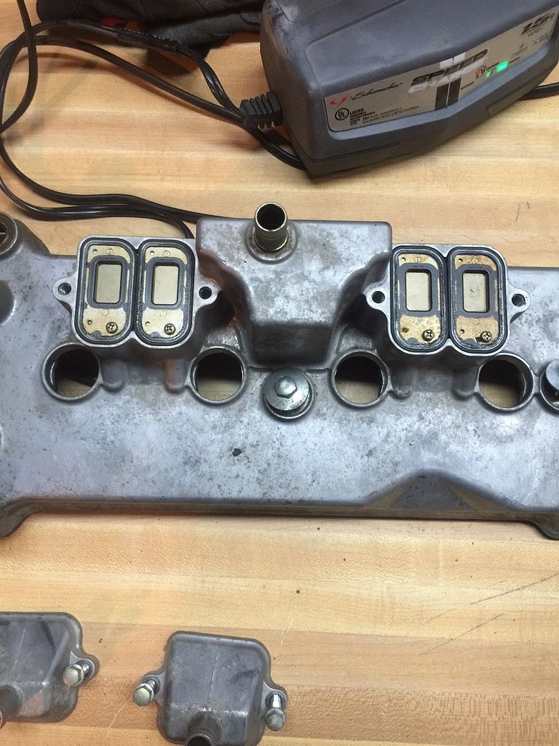

I figured pair valves and velocity stacks. I need to study up on that again. It's been a while since I've been this far into an RR.

I removed the PAIR valves and ordered a set of block off plates so I'm leaving the air box off until those arrive. The PAIR solenoid and hoses were also removed.
I got the bulk of the new harness on the bike. I ordered a kill switch from an 04 1K RR, which I thought I read in other threads, was a plug and play switch other than two brake switch wires. That was incorrect. The 1000RR switch has a completely different plug. So I removed the pins from the 1000RR plug and swapped the original 600rr plug onto the switch. I'm not happy with the fitment but it makes a good enough connection for testing purposes until I find the right kill switch. Then I installed the woodcraft keyless ignition harness. When the kill switch is turned on, gauges light, needle sweeps, no fuel pump. Press starter button, engine turns over. I'm getting battery voltage at the harness side of the fuel pump connection so the manual says I need a fuel pump.
I'd like to hear from someone with an 03-04 who has the woodcraft keyless ignition harness, before I spend cash on a fuel pump.
