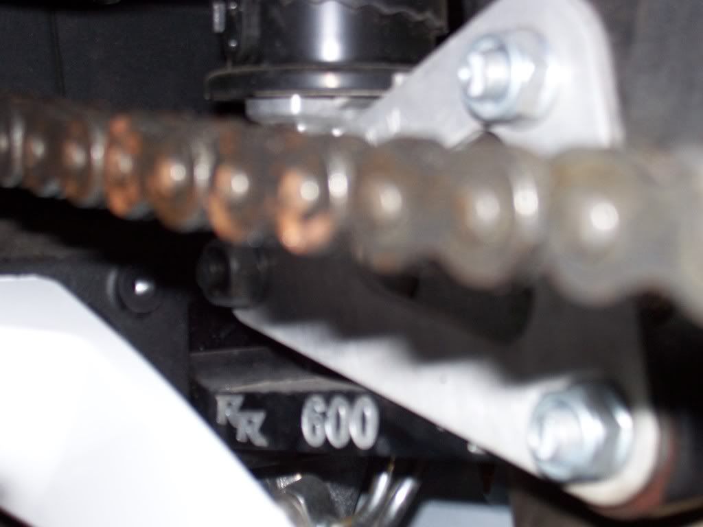

MikeB, thanks for the tips on how to correct the blink rate. This will probably be my first project. Here is a pic of the rear suspension, maybe you guys can tell me what I am looking at and what I need to purchase to bring it back to stock height. Note chain is not rusty, flash just makes it look like that :)
3,752 Posts
see the black dog bone with the 600rr logo engraved, thats the link. or dog bone. get a jack and a piece of wood, jack the bike up high enough to get jack stands under the rear sets. then sit the bike on the rear sets. that will be easier for you to do by yourself. taking that link is kind tuff if its your first time.
