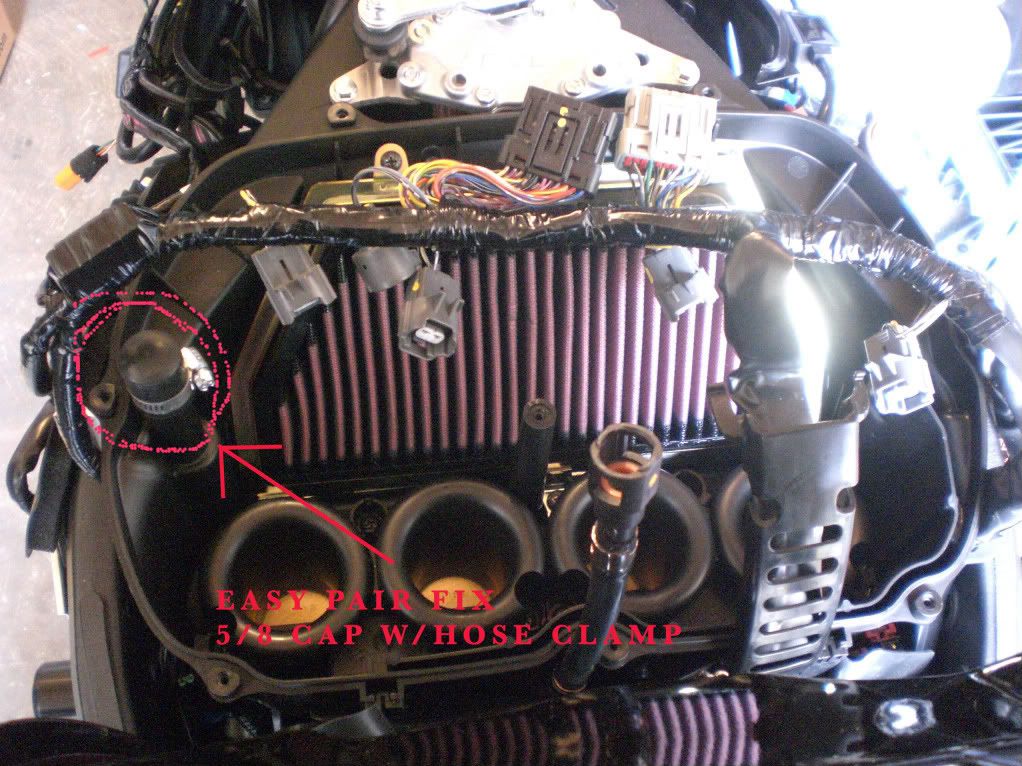

Kind of an old thread but I'm just now getting around to doing this mod really soon. I want to have everything I need on hand before I get started on it. Do you, or does anyone else know the exact size of cap I'll need to cap off the airbox where the PAIR hose was removed?

Well, I just did the mod on both our race bikes. I removed the airboxs so while I was in there I could install the HRC throttle on the "B" bike ( now I have a brand new in the box MP Revolver kit that I am not going to use) and remove the thermostats and bypass hoses. The end plug size you will need for the airbox is 5/8" (same for the bypass hose spigots) and can be had at just about any auto parts store. I wanted to replace the airfilters while I was in there, but the new K&N race filters are on back-order from PU. Thanks for the writeup! Tdub

None other than a very slight weight degrease. Does not change anything that would harm your motor. Tdub

i did this mod last year. if you don't care about the 1lb weight savings just put a cap on this tube and save yourself the trouble.

Wait, if you want to go the easy route, don't you need THREE plugs?
From the PAIR solenoid, there are three pipes coming from it. At least, that's how it was on the 03...

I'm half way through this. Good writeup. Had a little trouble removing the lower tub; you really do have to pull out only the front part, so the tub rotates about 70 degrees upwards. There are two small plastic clips that hold the tub in place at the back; make sure these are not hung up. For the sensor/thermostat hose, I undid it by pulling the tub up just far enough to squeeze my hand through the opening, then using a stubby flat head screwdriver as a wedge to pry the hose off. (That will be fun to put back on.)
For the breather hoses on either side, I found a flathead screwdriver worked well to push those metal wires down the hose far enough to pull the hose free.
7,045 Posts
Wow, what a pain. For non-mechanics like me who are doing this first time, figure for 2 six hour blocks as you wrestle with everything without breaking something.
Trying to put this bicth back together now, just busted the map sensor clean off. Getting that lower tub back into place is a nightmare. Hard enough to get the rubber air guide to fit into the holes on the frame. You're gonna have to bend the plastic quite a bit to get it to squeeze into place.

I just crossed 12k miles and am going to be swapping the air filter out as soon as it gets here (I know, I wasn't paying attention to my mileage, otherwise I would have ordered earlier and done this on/before 12k miles). Since I have to pull the upper part of the airbox out for the air filter, I figured I'd go the extra mile for the PAIR removal.
Anyhow, first off, thanks for the write up guys; I read through the whole thread and there is a lot of great information on what is needed/recommended (block-off plates, 5/8" vacuum cap, etc). I do have a few questions though:
