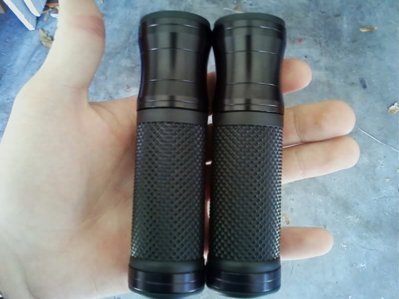

As my curse continues...i have run into another problem.:banghead:
While putting my grips on i decided to use the hairspray method, clutch side was super easy. Throttle side is another problem because i couldn't get the grip all the way on before the hairspray dried. I tired to go about taking it off and redoing it but i cant get my flat head under the large collar.
How can i take it off without damaging anything?
With these grips my bar ends don't match...what kind of bar ends do you guys recommend?

the problem is they wont go on? are they anodized aluminum or what type of material? If it were me i would just take a rubber mallet and just see if you can tap it on a little farther if it hasn't been too long and see if it sticks.

You should be able to just twist and pull and get it off man.
I have the real Driven D3 Grips and if I wanted to I could def
get them off. I would take it off and do it the right way.
You also may want to file down the little lip on the throttle sleeve
or your grip is going to sit 1/2 away from the end of the clip-on...
It looks alot cleaner and finished if the grip slides allll the way on over
that 1/2 lip... IMO
Driven D3 Install : http://www.youtube.com/user/303Cycle#p/u/4/AhIc0sguQOo
This is an "How to" on Driven D3 Drips done by www.303cycle.com one of our vendors here. this will prob help you...
Also what do you mean your bar ends don't match? Picture?!?! My OEM Bar ends line up perfectly with the Driven D3's...
