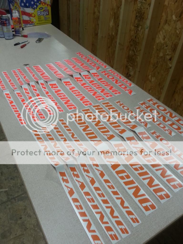

So packaging was alright. Here are the decals when I got them and what they looked like all laid out on a table.

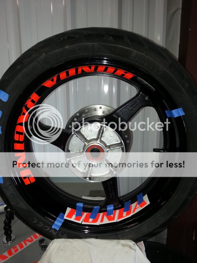

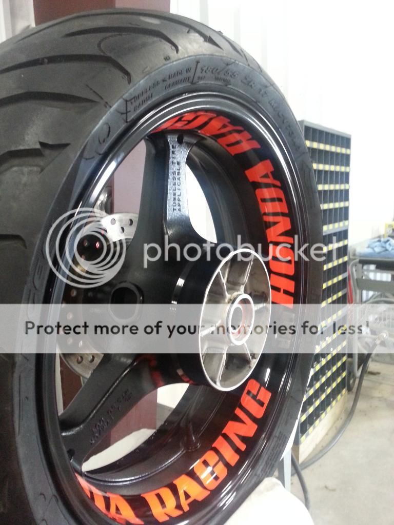

I started with the rear rim because the rim is larger and the decals are larger as well. I started by doing half of the rim and spaced them out so the total HONDA RACING took up less than half of the rim. I cut the letters out individually so they were easier to manipulate and I could move them around for spacing with ease. I lined the decals up on the inside rib of the rim. I actually left a little gap between the top of each letter and the rib. NOTE: This is one thing I would do differently. I would rub the letter right up next to the rib for 1 reason. After install and the wheel goes around, the letters have a wave effect to them because my spacing varied slightly between the letters and rib which caused the letters to not all be in the same line. Hope that makes sense. Ask questions if I need to make that clearer.
As you can see I did half of the rim. When I did half of the rim I measured across from one end to the other to see the total length it took to place the decals. I then used this same measurement to do a reflection on the other side. That is when the two masking tape marks are for on each end. Since I could see the total area I had to play with I put the decals on to get my spacing down. I finished applying the decals on that side and this is what I got:

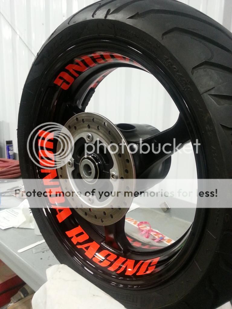

With one side done I did the exact same thing on the following side. I also did the same length so the large gaps were in the same location on the opposite side.

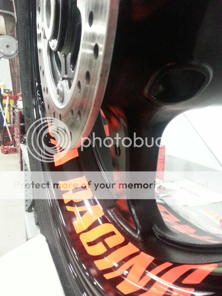

Here is a better pic of the spacing issue I had. As you can see the R or C are bumped right next to the rib and the G has a little gap. Nothing huge but it will result in a wavy look when the decals go around at low speeds when moving.

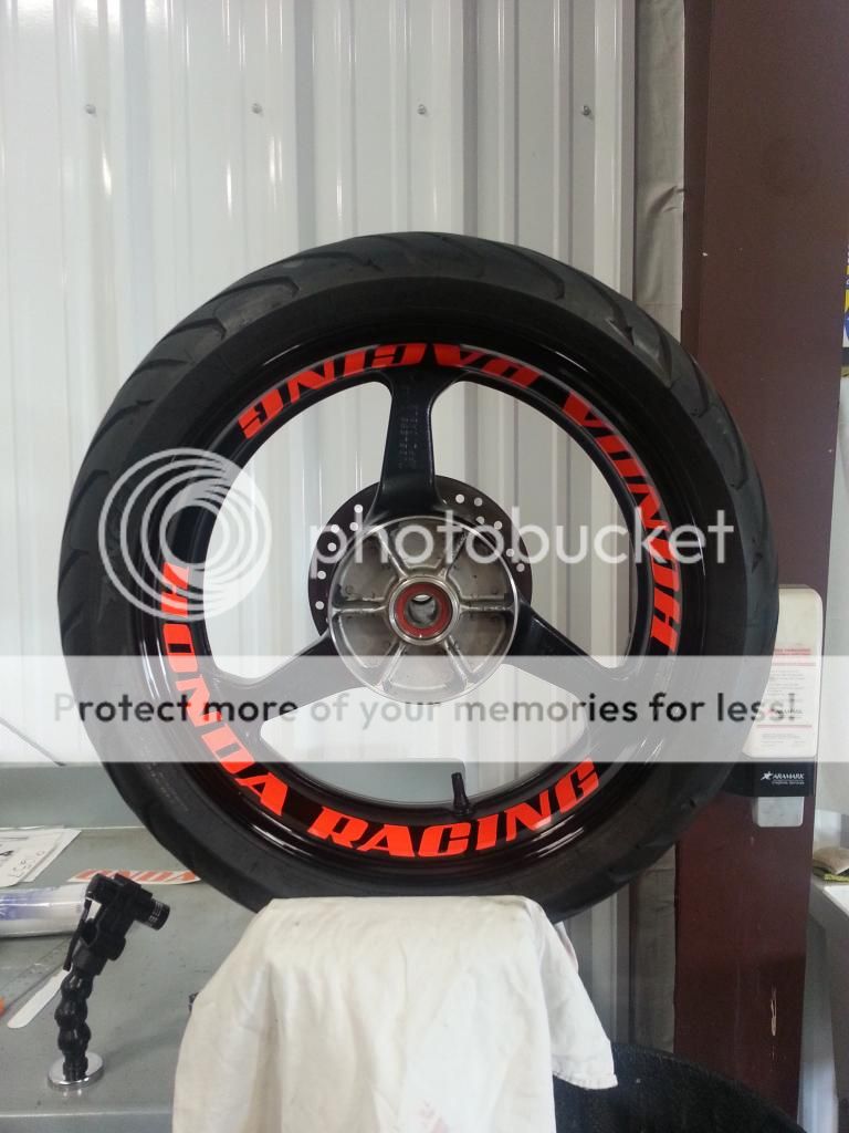

End result on my bike. Pics are outdated from other bike mods but the wheels have stayed the same.
I'm really happy with how they turned out. Really sweet how it's a solid orange stripe when going down the road as well. Don't get in a hurry when doing this. It took me a whole day to do this as there are 88 letters that need to be applied. I'm sure there are easier ways especially time wise but that is how I did it. I'm willing to answer any questions, especially over anything I missed, and I also have a few more pictures if you need them. Good luck!
