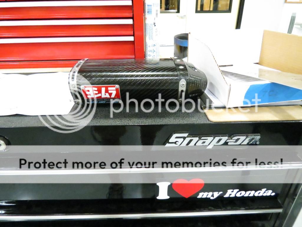

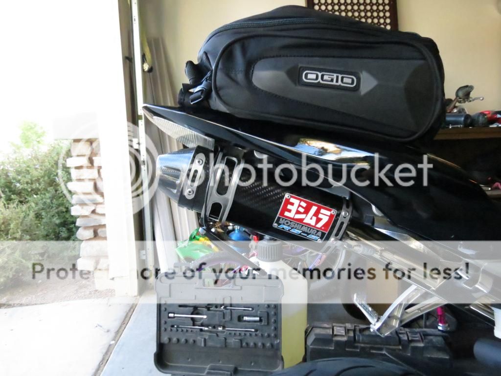

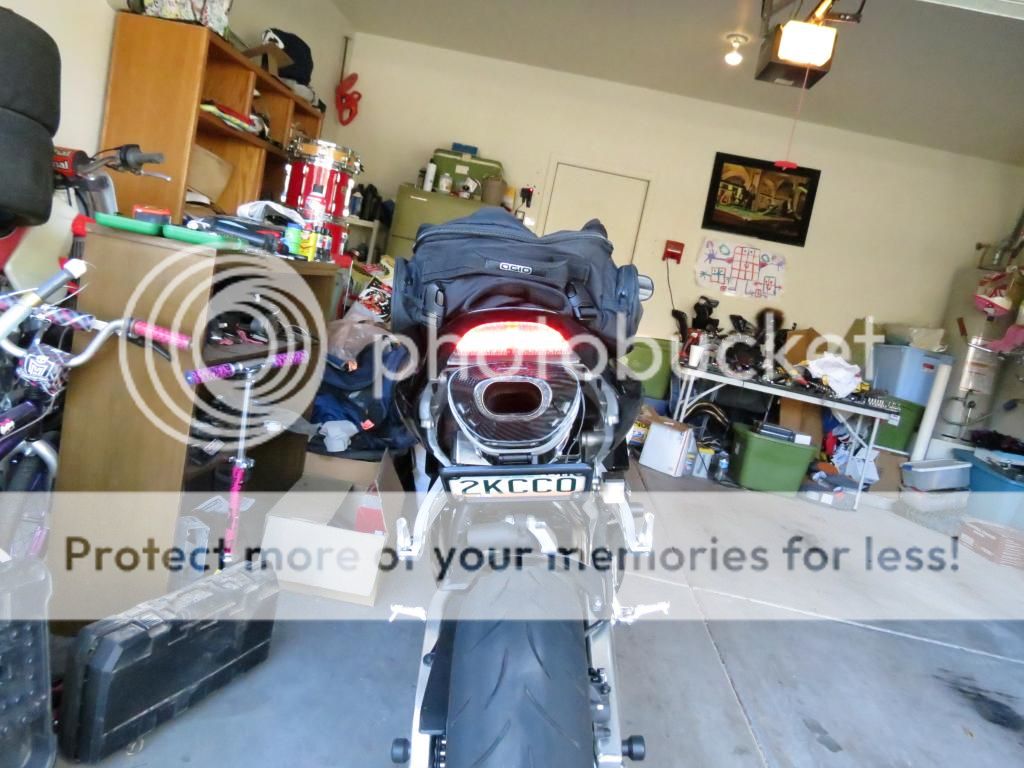

So, first thing I did was mount the can on my bike stock so I could decide how much I wanted to take out. I have heard people do about 2 inches, but my main reason for cutting this was to make my Tripage IT as visible as possible, so I measured to where the LED's and diffuser start, which turns out where I need to cut about 3" out of it.

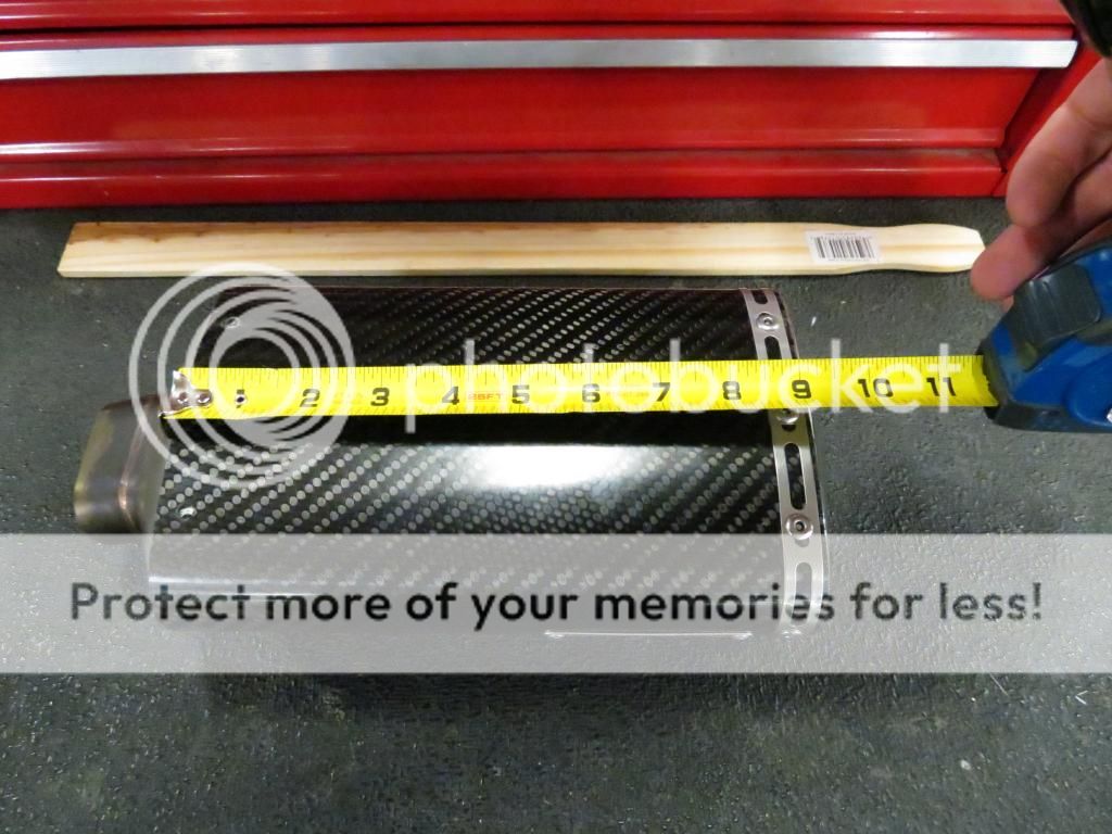

As you can see, the can is right at 12" long stock, so we'll be down to about 9" when all is said and done.

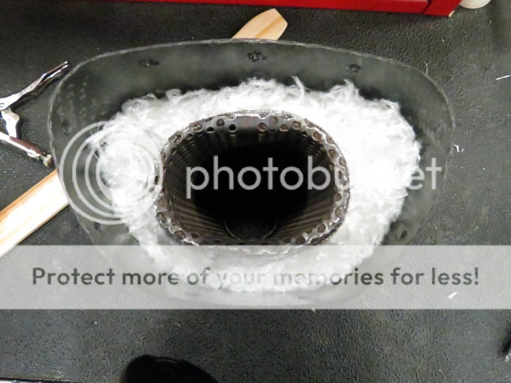

Punch out the rivet stems and drill off the heads per Yoshi instructions. Remove end cap and end of can, again per their instruction. Next, drill off rivets at forward end of can (where the midpipe comes in) the same way and remove inside piece and attached baffle tube. Discard old packing (unless you want to reuse it, but to me this is the perfect time for a repack) being careful not to cut yourself on the wire mesh wrapped around the tube.

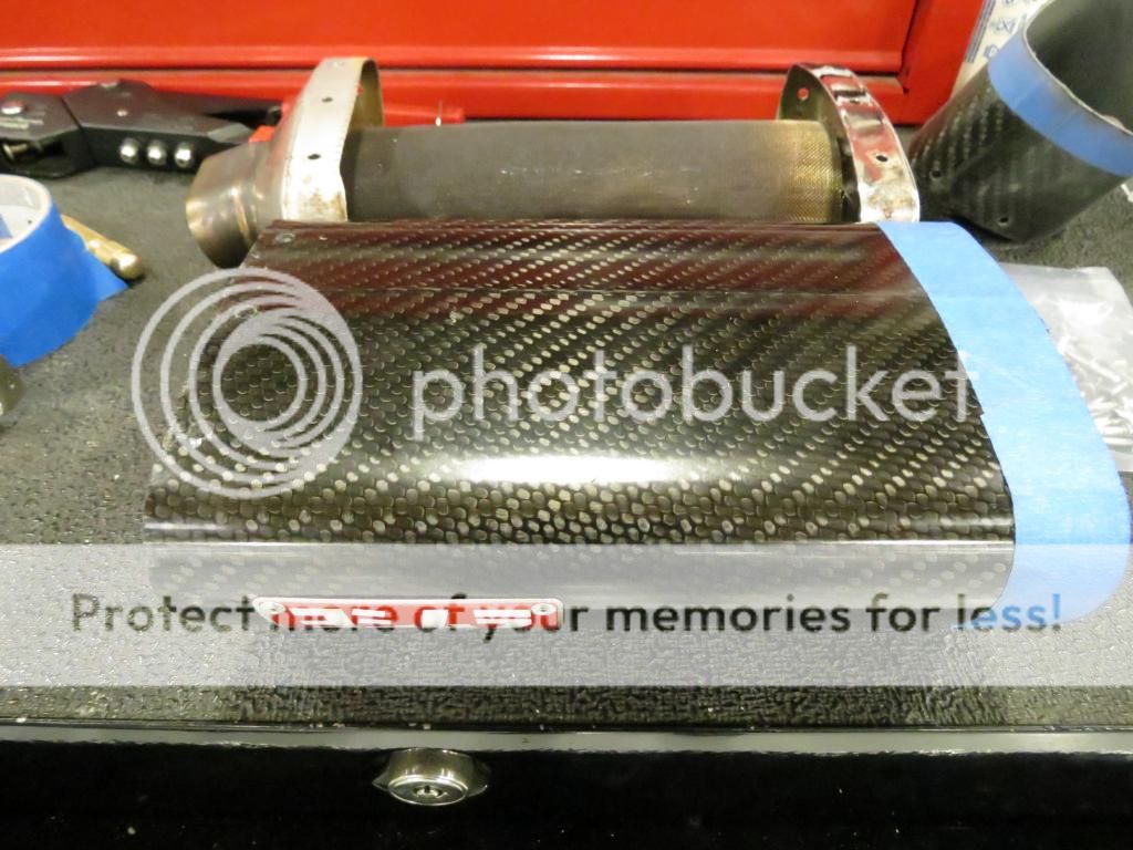

Here you can see about how much shorter the guts are now than they were/the can still is.

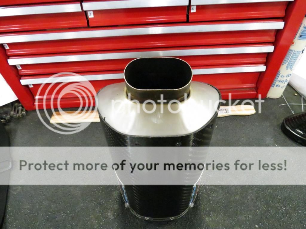

Next mark the outer sleeve at the same place, making sure to cut the forward end of it (otherwise you'll cut into the name plate obviously).
40 Posts
Now cut that just like you did the inside tube, being EXTREMELY careful not to slip and damage the carbon fiber. Also, I forgot it in the tools picture, but I recommend a dust mask of some sort, as carbon fiber and resin dust can't be good for you.
Double check your lengths, and clean up/smooth out all freshly cut edges.

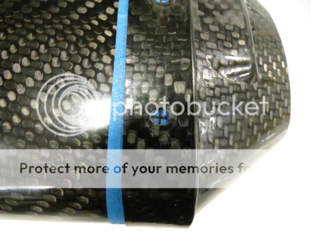

Now slip the tip cover over the freshly cut end of the outer sleeve and mark all hole locations. This end of the outer sleeve will now be your aft end. This is done so that the Yoshi name plate will not end up underneath the can clamp. Drill holes as marked. I recommend buying a drill bit made for carbon fiber. They're not cheap, but you can very easily go through 4 or 5 regular 100 degree bits trying to drill through carbon fiber. No joke, that **** does not **** around.

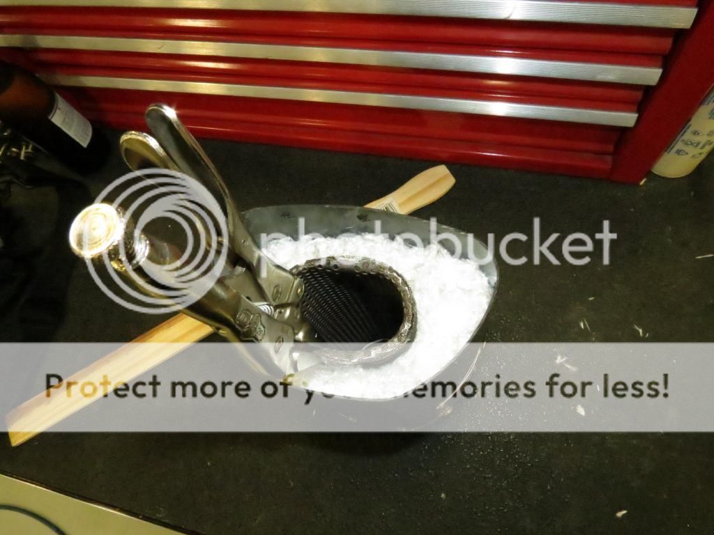

Slip the forward end cap and baffle tube into the outer sleeve noting correct end orientation. Install stainless steel band and rivets, then rivet forward end cap and outer sleeve together, then pack new packing material into can per instructions from Yoshi. I ASSUMED that I would have some left over because the repack kit has enough for a full sized can, but I must have packed it super tight because it turned out to be exactly enough. Just as a tip, I used a pair of needle nose vise grips to hold the wire mesh from unwrapping while I packed it since I had cut the tack welds off of the mesh. Also visible here, I took a pair of duck bills and rolled the freshly cut end of the baffle tube out just a bit to facilitate getting the inner end cap (aft end) installed as it slips inside of the baffle tube.

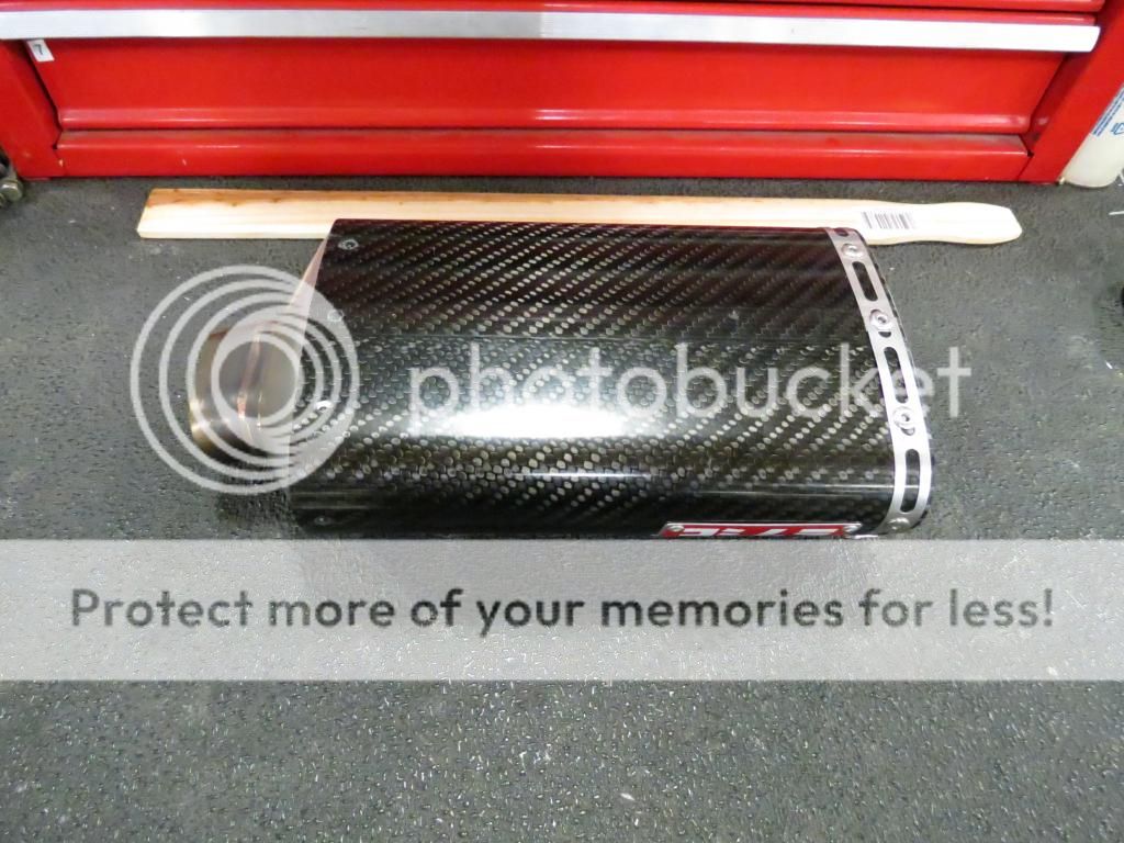

Install the aft end cap and verify hole alignment with outer can. You may need to elongate the holes in the outer sleeve a bit for proper alignment, just make sure that if you do, you're ONLY taking material out of the outer sleeve and not the cap. The cap and outer tip cover should be aligned just fine being that they were together initially. And same as before, use a bit made for carbon fiber or else be ready to replace your 3/16" bit.

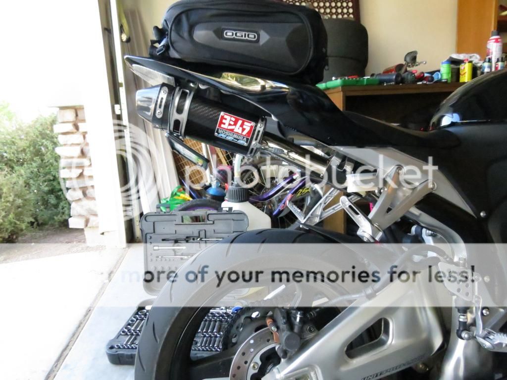

You can see now that our overall length is right at 9".

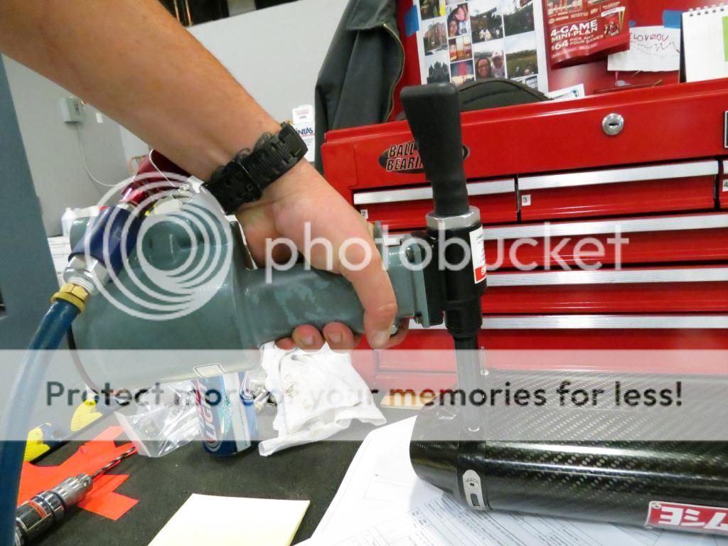

Now rivet the end cap on. I know I showed a pair of manual rivet pullers in the tools photo, but that was because I assume most people don't have access to a pneumatic puller. If you DO, I would highly recommend using it because those stainless steel rivets are a BITCH to pull by hand!
