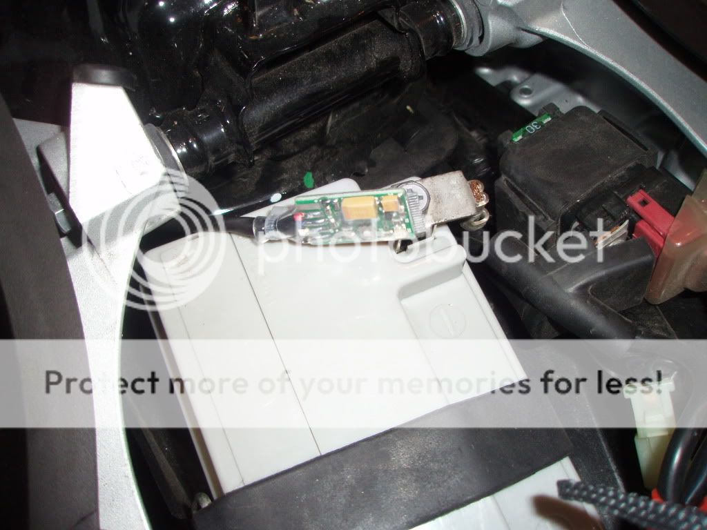

wat do u all got done to ur gearing? is it stock or did u change it? after that go to the link i posted in the first post and calibrate it from there... i did the maximum percentage from stock i think it was 4 or 5 % but mine was 17.5% off and it is dead accurate to the gps any other ?'s lmk

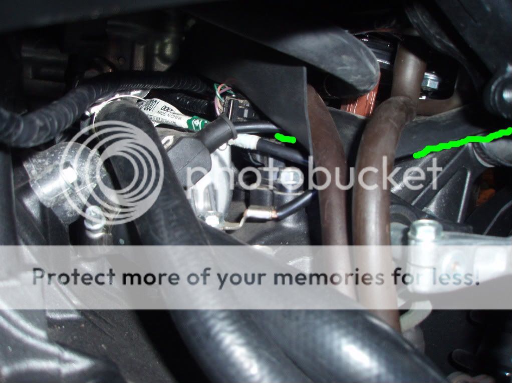

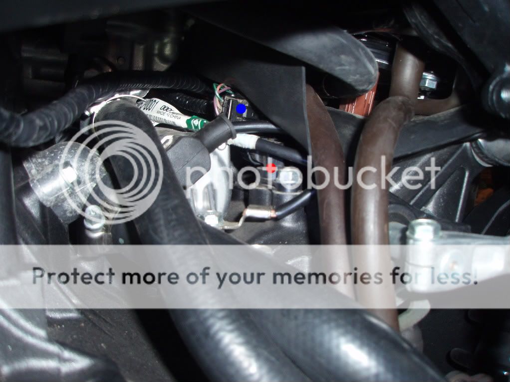

Thanks, followed this for an easy setup. On the 08 the most obvious connector is the fuel pump. You have to feel around a little for the speed sensor. Used the on line calculator with the 5% correction and speedo is dead on with GPS up to 80MPH.

thanks for the post, it really helped me out... just installed mine, whattabitch! also there's like no cord left... if you're reading this 12 o'clock labs, make it longer!

+1. The 07s up you don't need to remove the fairings. I did my 06 and lifted the tank to do it, in hindsight i MIGHT of not had to do it. But on my GFs 07 it was a piece of cake.
FWIW these are super accurate. I got a ram mount and stuck my phone on it with a GPS app and calibrated both bikes. The speed is VERY accurate considering your taking out all speedo error as well.

space was pretty tight to be honest. doable without fairings, but took quite a bit of two finger manipulation of the connectors. All good tho.
