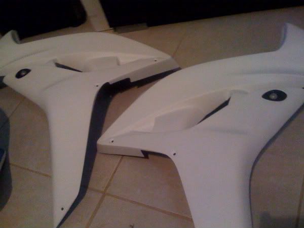

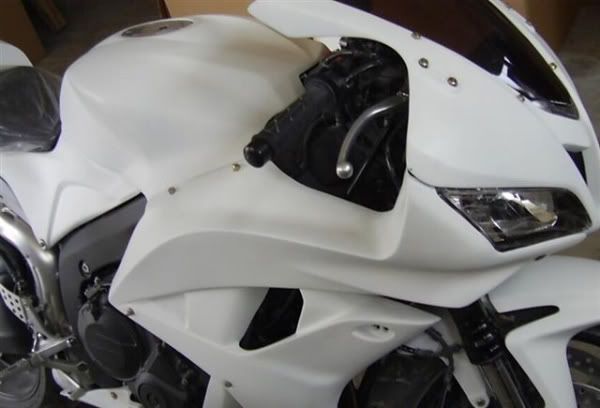

Right Side Fiberglass Street Fairings w/ Uretane Primer
Left Side Fiberglass Street Fairings w/ Uretane Primer
Flush Mount LED Turn Signals on Fiberglass Street Fairings

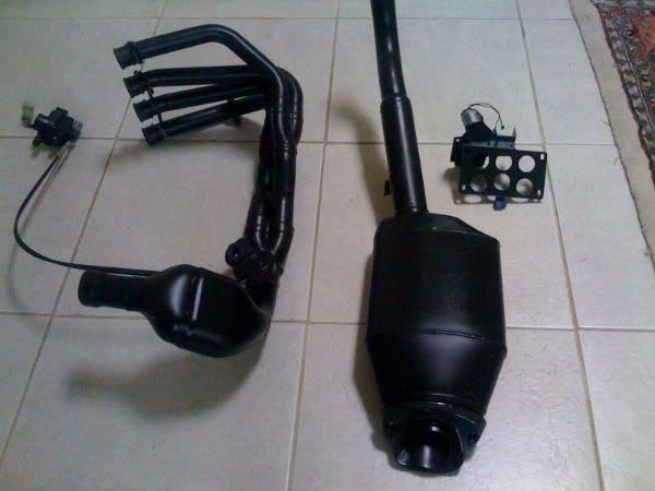

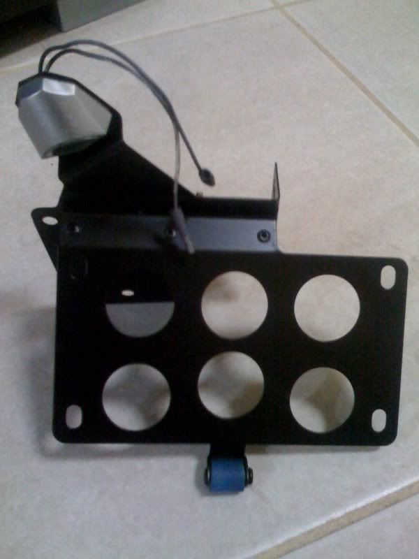

Headers, Exhaust Pipe and Competition Werkes Fender Eliminator painted with Black High Heat Paint

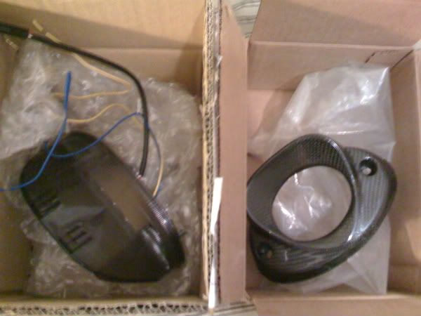

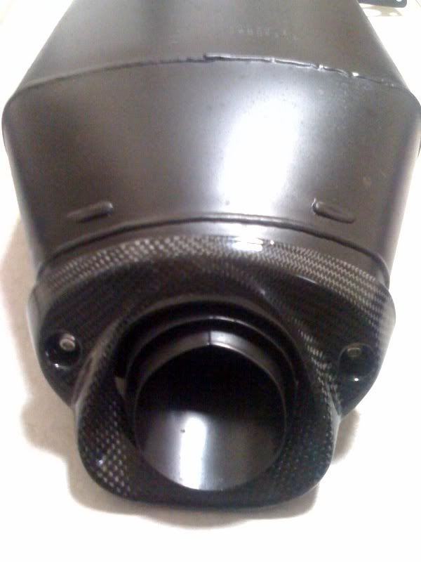

Smoked LED Integrated Taillight & Carbon Fiber Rear Muffler Cover
Exhaust Pipe painted with High Heat Paint & Carbon Fiber Rear Muffler Cover Installed

where did you get that CF pipe tip? and how much was it? any and all info wolud be greatly appreciated, thanks. btw, the build is looking good.

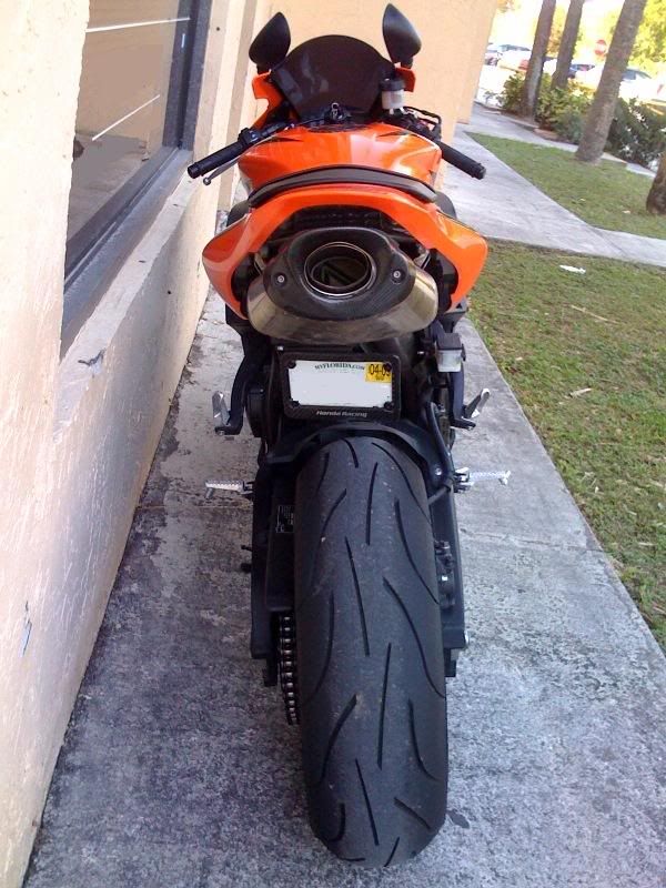

alright well heres an update:
DO NOT use high temp header paint on your headers or exhaust. i tried it many different ways and the headers just get way too hot for it. first i tried sanding the pipe and cleaning it with water and alcohol. bad idea. second time around yielded better results put still cracking and bubbling occured. that time i soaked the parts in degreaser as suggested and still no luck. too much work. just go buy a full system or slip-on. save yourself the trouble.

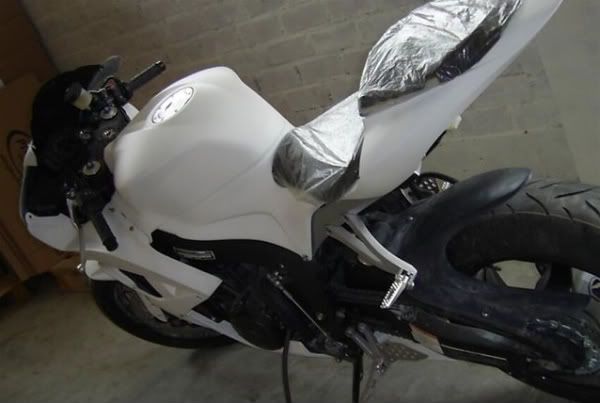

DO NOT buy pit-eck fiberglass parts if you want a nice fit. on the plus side he did happily return my money but it took a few weeks of waiting. i recommend their parts for track bikes. very cheap, as stated throughout this forum.... u get what u pay for.

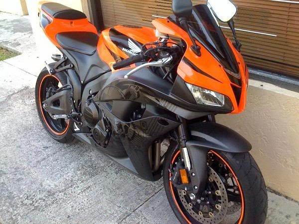

Heres what she looks like now. it was a cloudy day but its now part pearl orange and part graffitti. i found some colored graffitti decals on this forum to match the new pearl orange parts. those are next on my list.

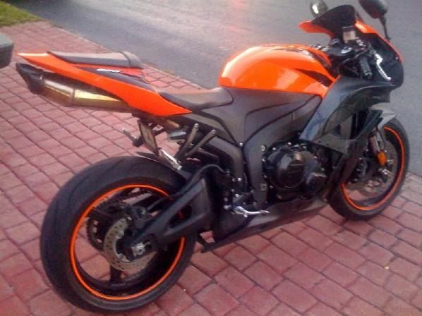

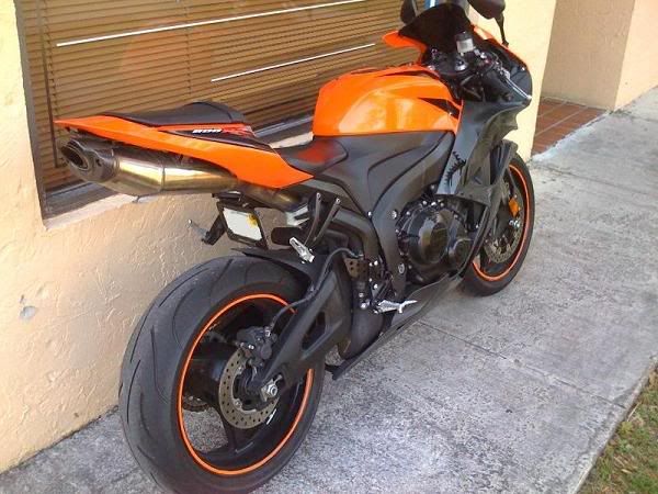

here are some moe pics. i'll be adding on the orange graffiti graphics and pearl orange front fender these next couple weeks. let me know what u think. probably will get rid of those mirrors too and throw on some block off plates.
