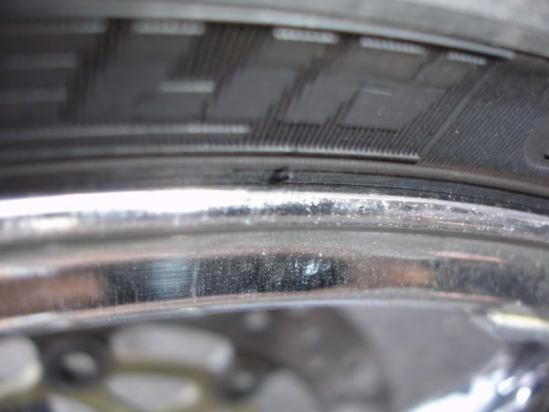

The valve stems are fine. Pictures below. . .
Front
Rear
Where they chrome when you got them? cause the front looks like it was bent. could have been repaired and then chromed to hide the fix?? Never know.
Yes they were chrome when I bought the bike.
it looks like the front does, don't really see it in the rear

You probably have a torn bead or some trouble down there.
The valve stems do NOT appear to be leaking (I checked with water and didn't see anything). I know the chain is rusted; I'll eventually replace it assuming no major financial problems with my car. I'm not riding at any crazy high speeds, not that I see how that has to do with anything?
I'm hesitant to believe it's a torn bead as both tires are leaking pretty consistently. I'm certainly not ruling it out, but it seems considering the condition the wheels are in (chromed, possibly bent up), it's possible the wheels are to blame. I'll be having them checked out this week though. Thanks for the input so far.
