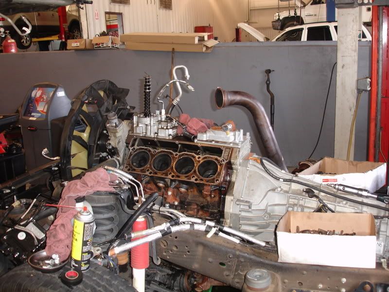

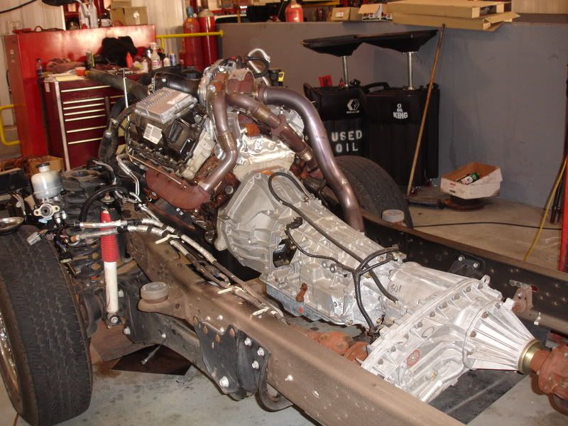

Not for bikes, but I am an auto mechanic.... Dealer tech for Ford for about 10 years now. I do mostly diesels but still do a little of everything else too
My typical day.... lol

Stupid cab forward design! haha
My buddy just had his 08 6.4 take a poop at 60k miles
Injectors went originally took it to ford on warranty, a month later he got it back and the parts + labor total was almost $22,000....but im sure you know allll about that haha
