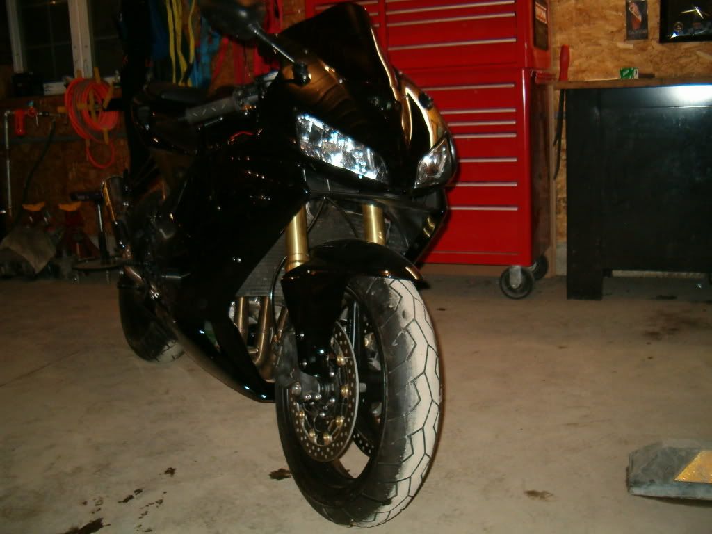

Got the hotbodies undertail mounted and the 06 front end. Next is posting pics, sorry I havn't got around to it yet. I'll be ordering all my parts tomorrow that i need to get it back together and will start the exhaust soon, I got an 06 r6 silencer and we'll see if i can rig it up to my hindle header and build a tip for it.

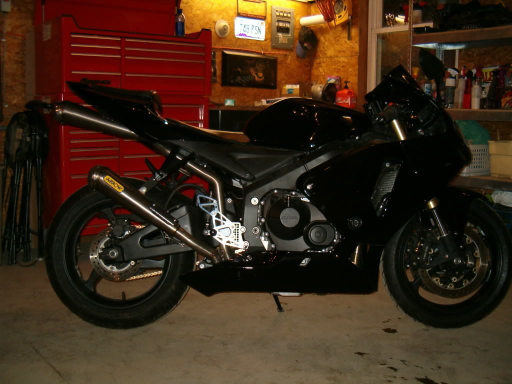

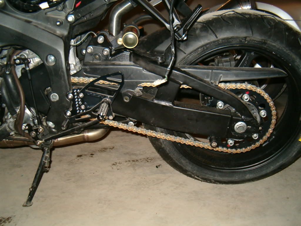

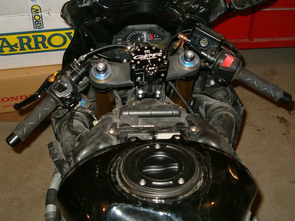

alright, so my plans have changed slightly on my bike. 1st in building my exhaust ran into a problem, the only silencer that i could think to work was from a z1000 which was hard as hell to find and too much money. So, my full arrow moto gp replica will be here in like a week or two. I went with pirelli tires. All of my parts that aren't black are sandblasted, just waiting on my brother to powdercoat the items. I went with the g-craft res. in black from super bike supply. It looks great with my vortex rearsets, a perfect match. Got my vortex sliders installed, my GPR stablizer is on, the 06 front end is done, along with th 06 subframe. I'm rolling a fabbri double bubble windscreen, my pc3 is installed along with my speedhealer. I'm going to do the bodywork in a nice jet black. I'm going to run the new watsen turn signals, and tint my taillight transparent black. Everything on this bike will be black with the exception of the arrow exhaust, gotta leave the ti. alone. I'll have some pics up when i get the swingarm back on after powdercoat.

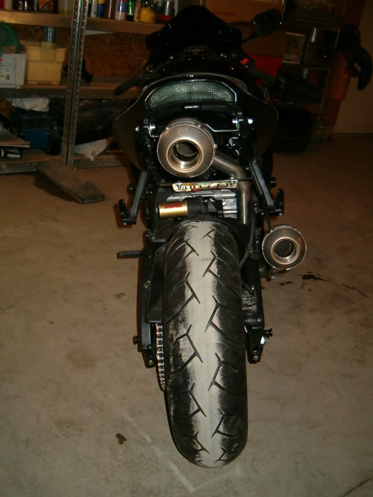

Here's where I'm at now, the plastics just need to be cut and buffed, a need a new left mirror(compliments of a drunk friend that thought it was a good place to lean), put on my galfer brake line on the rear, adjust my tail exhaust to center it up, add my stomp grips, add my tank protector, get my map done as soon as it gets alittle warmer, new seat covers, put on my new black watsen turn signals with running light module, and put on my air duct covers, and then the bike is good to go. I'll try to get a mod list going soon.

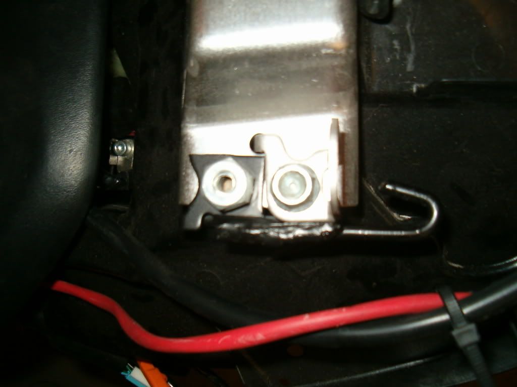

Thanks for the compliment. So, here's some info on it. The bike is an 04 that's been updated to a 2006. The front and rear brake calipers, upper, air ducts, front end, subframe and tail fairing are all 06 models. I modded an 04 rear seat hook to work as a helmet hook, have g-craft brake res with vortex rearsets, galfter braided lines on the front and soon on the back, vortex frame and swingarm sliders, vortex gas cap, Power commander, speedhealer, 520 conversion, Fabbri doublebubble windscreen, tinted integrated taillight, tinted 3rd eye, GPR steering dampner, Prellia Tires, Tripage l.e.d. hugger and tag bracket, many powdercoated pieces, Arrow full TI Moto GP replica exhaust system, mesh on tail fairing, du pont jet black base/clear paint job, metal plates behind tank cover for a magnetic tank bag, pro grips, and a few more things to come.
