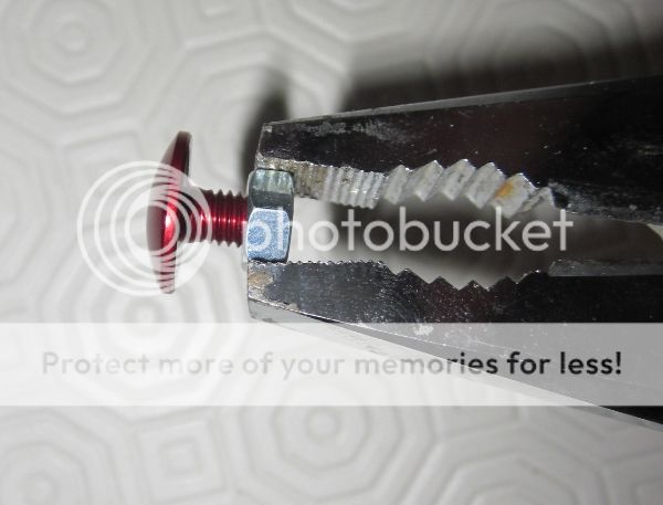

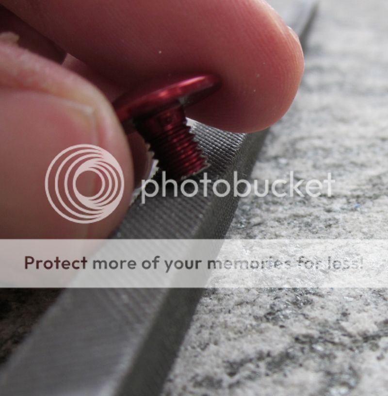

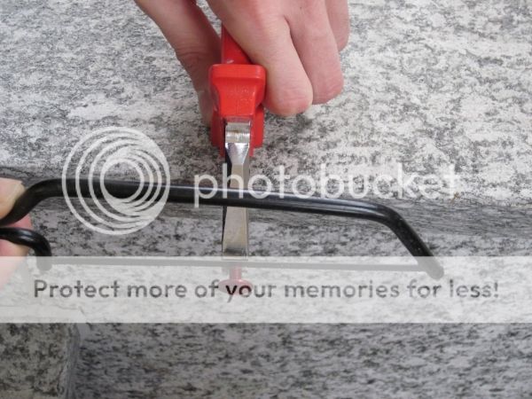

Manual adjustments are needed just on a set of screws, so here the procedure I made (with a Dremel could be more easy):

Cutting operation
Little adjustments
Use a nut to thread the screw
The end
