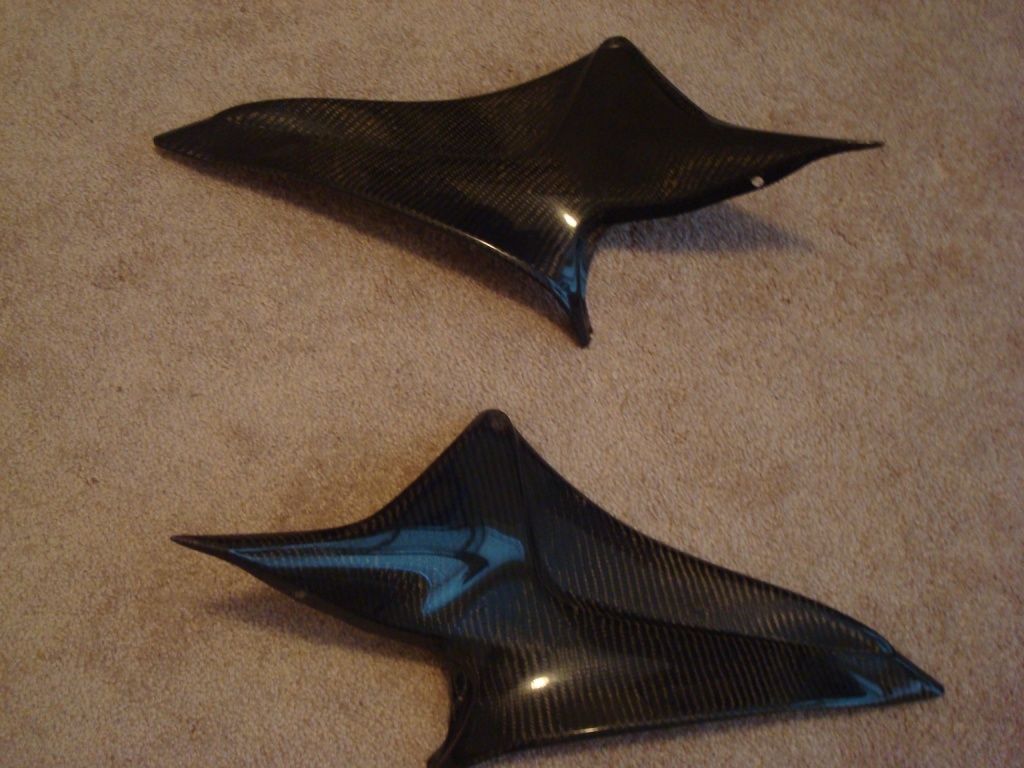

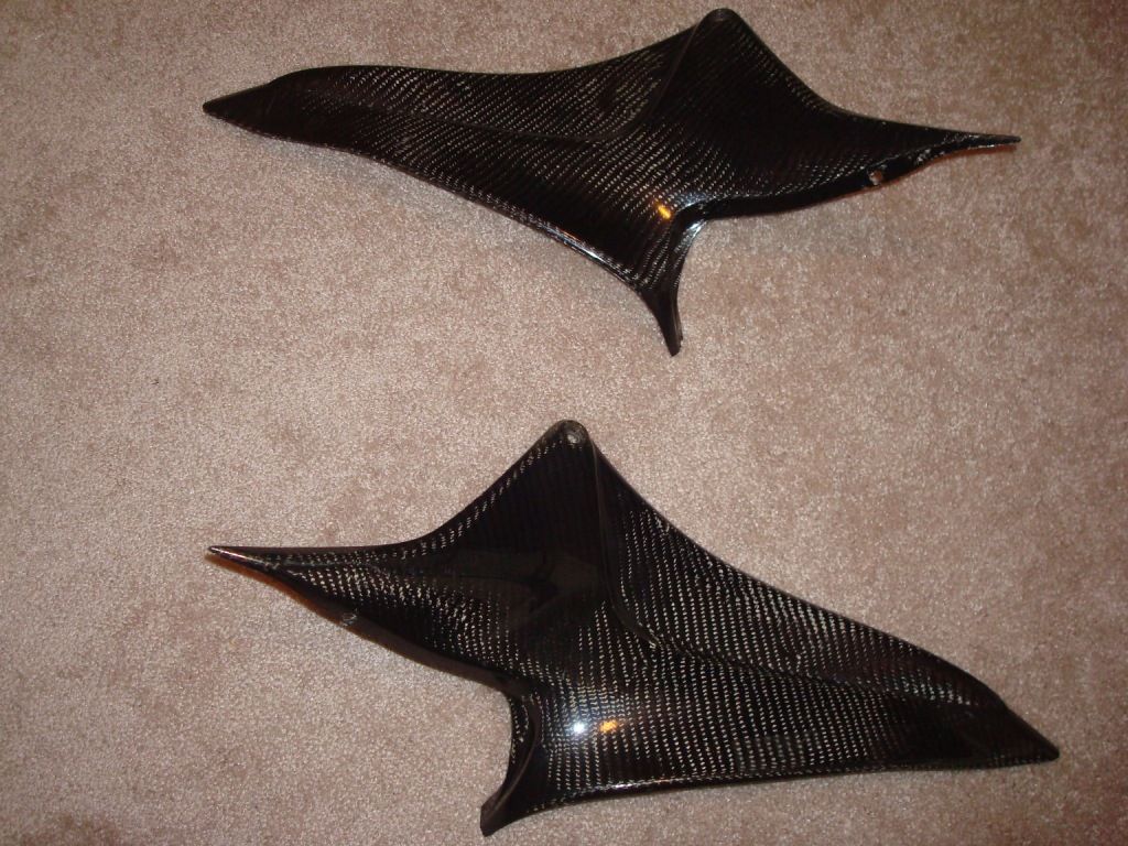

I got the CF tank panels in today. I'm going to need to clean up a few light scuff marks and finish painting my fairings before I can install them. If you are looking to get some CF tank panels I probably wouldn't recommend this brand (Carbon Dynamics). There is some bubbling around the one corner by the bolt and the weave has some gaps in a few spots. The other downside is it doesn't have any tabs to go into the tank which will make it easier to install but i'm worried about how well it will stay attached and not vibrate. Anyway here are pics of the parts
