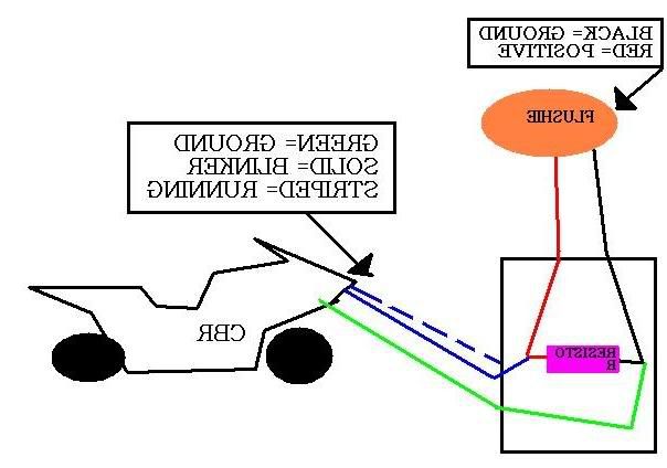

I Don't know why this is such a big question by so many people
but here it is .If anyone wants to disagree lets open it up now
I have been trained by the US NAVY to fix radars and gun weapon systems , i know electronics let see what you guys think
P.S. Don't make fun of my picture

my question is where does the striped blue wire go? it looks like it stops, and goes to nothing. do you just hook both the blues to the positive lead on the resistor/ flushie? (basically you hook up the running light wire, and the turn signal wire together, and wire the resistor in parallel? also, what is the rating on this resistor? how many ohms, tolerance, etc.

#18 ·
slab 42
as the picture shows the striped wire is for the runing light. so if you would like to use your flushmounts as running lights then hook that up to the red wire (which by the way looks cool). but if you are using your flushmount as a signal than connect the solid wire to the red wire and CAP off the striped wire as to not ground it out. do not try to use it for both as it will not work(tried that sorry looking for a solution) and for the rating on the resistor try a 20 ohm resistor from radio shack. if it is still a solid light or flashing too fast for your taste then go to a 25ohm and so on. and try to get one that is allready sealed from the elements so that way you don't have to shrink wrap it your self.

lilguns said:
If your asking if installing resistors will make you signals slow down than yes. If you intalled LED's in place of your stock incandesant light bulb and they won't blink at all(stuck on when activated) then this will also fix that (as long as you don't have a blown flasher relay).
Cool thanks..So basicly what i am seeing here (GREAT picture by the way) is you connect the resistors between the possitive and negitive wires?
