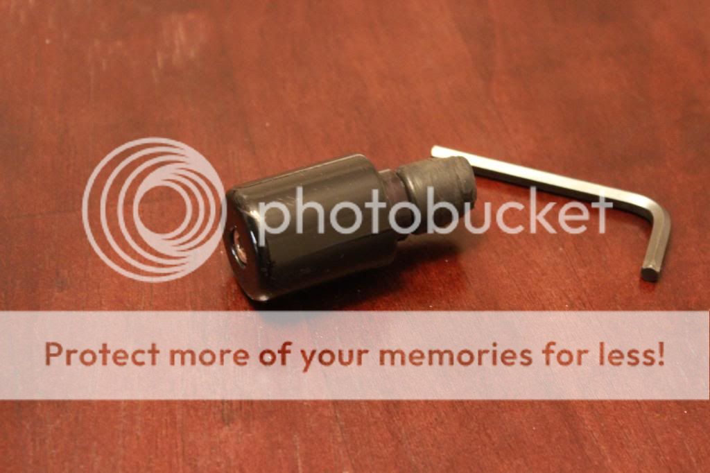

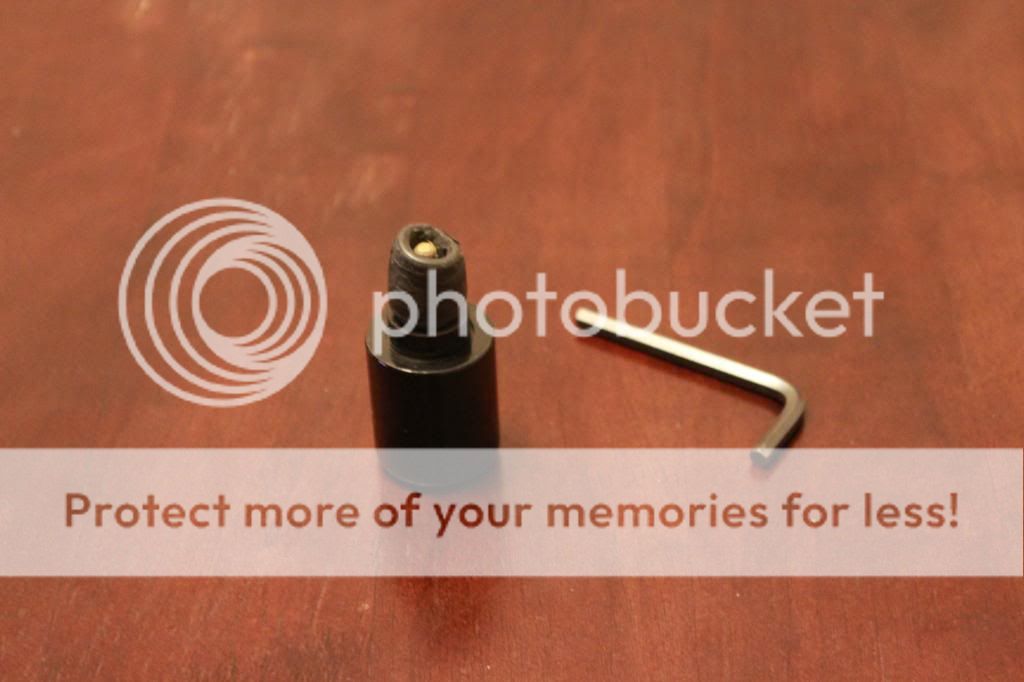

My RR that I just purchased, I can twist the black part that sticks out back and forth, is that normal? My 250r doesn't do that. They are rock solid.
Sent from Motorcycle.com App

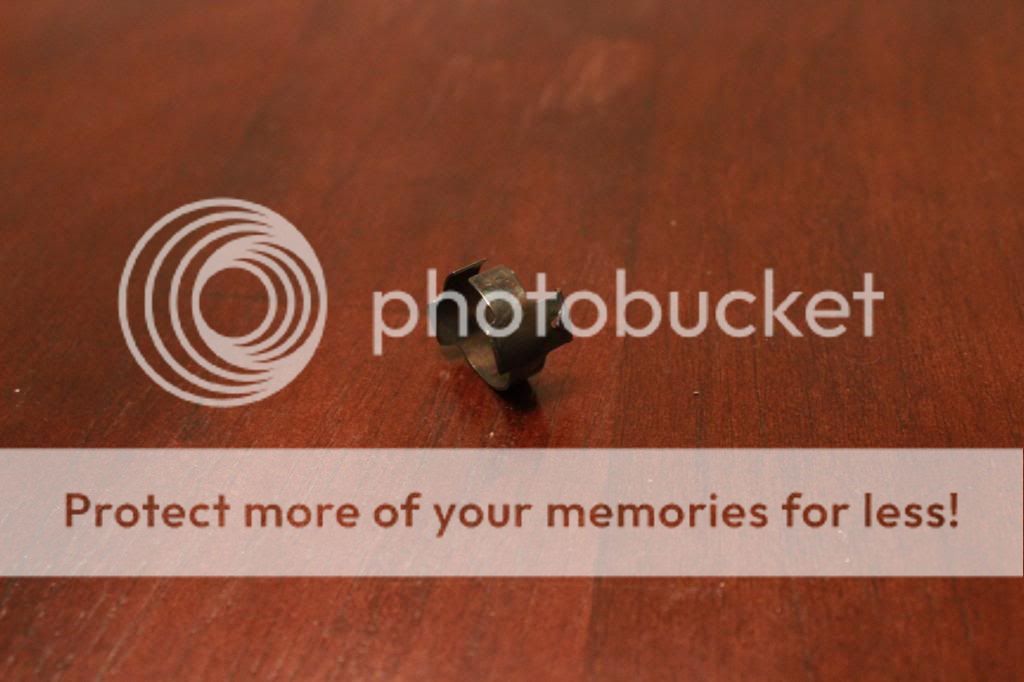

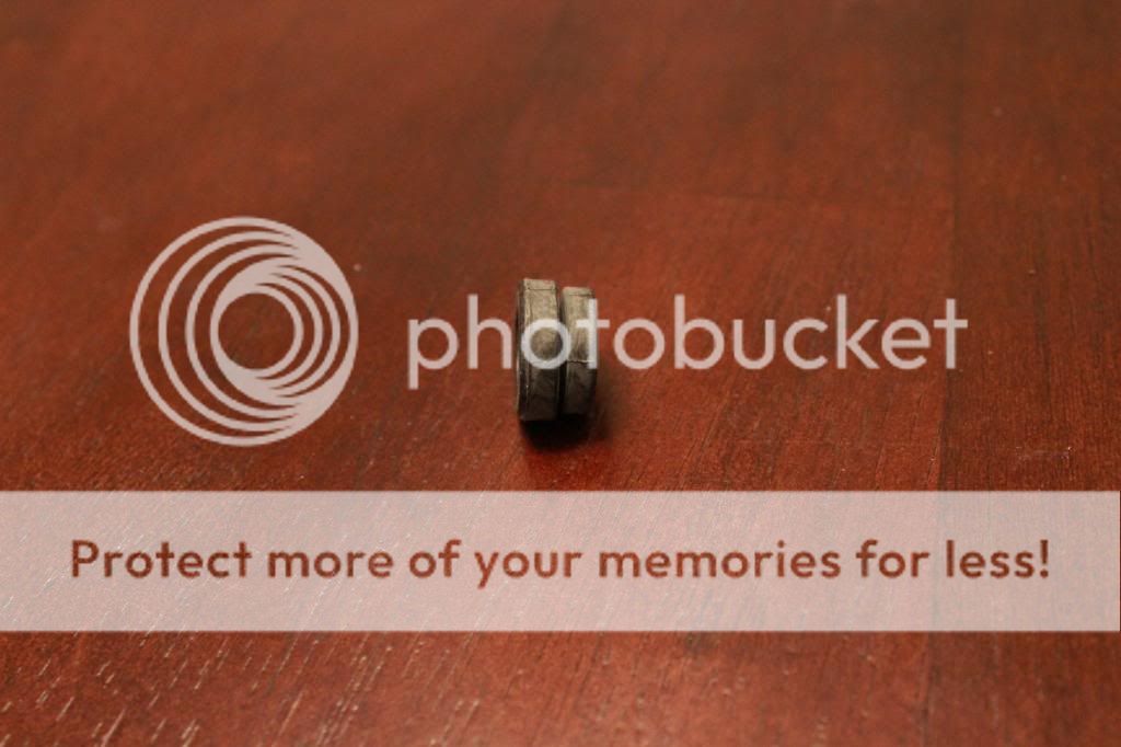

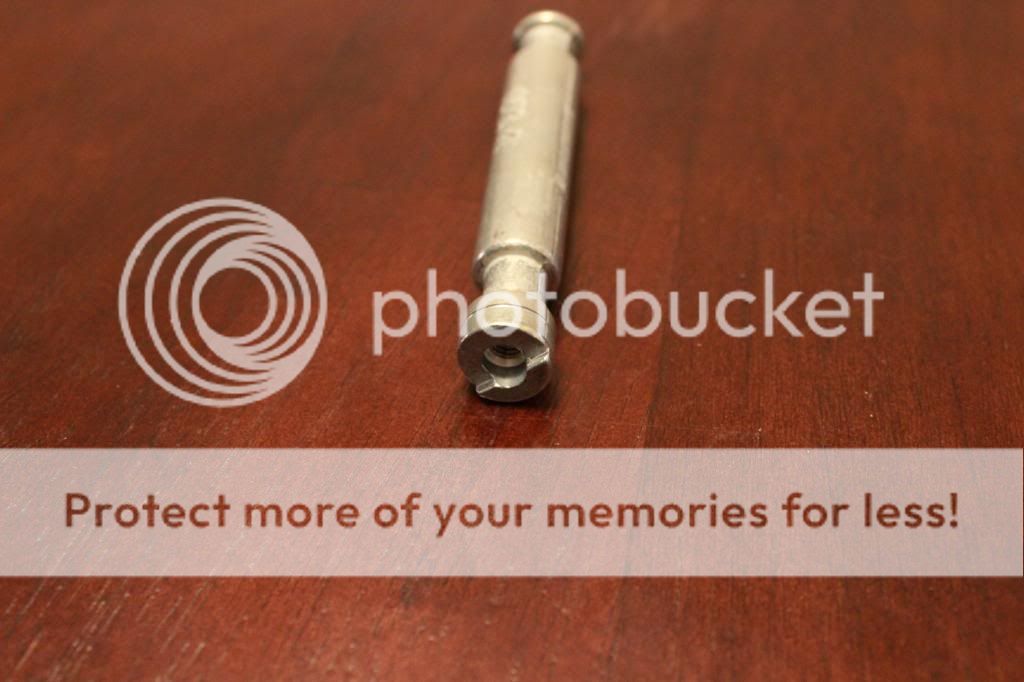

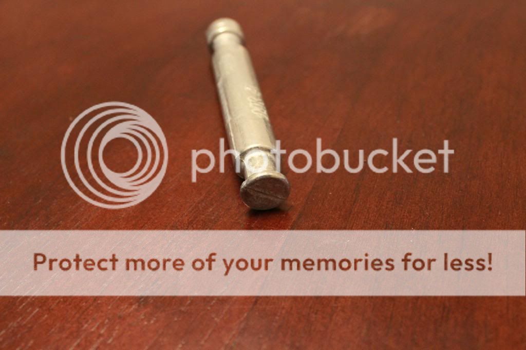

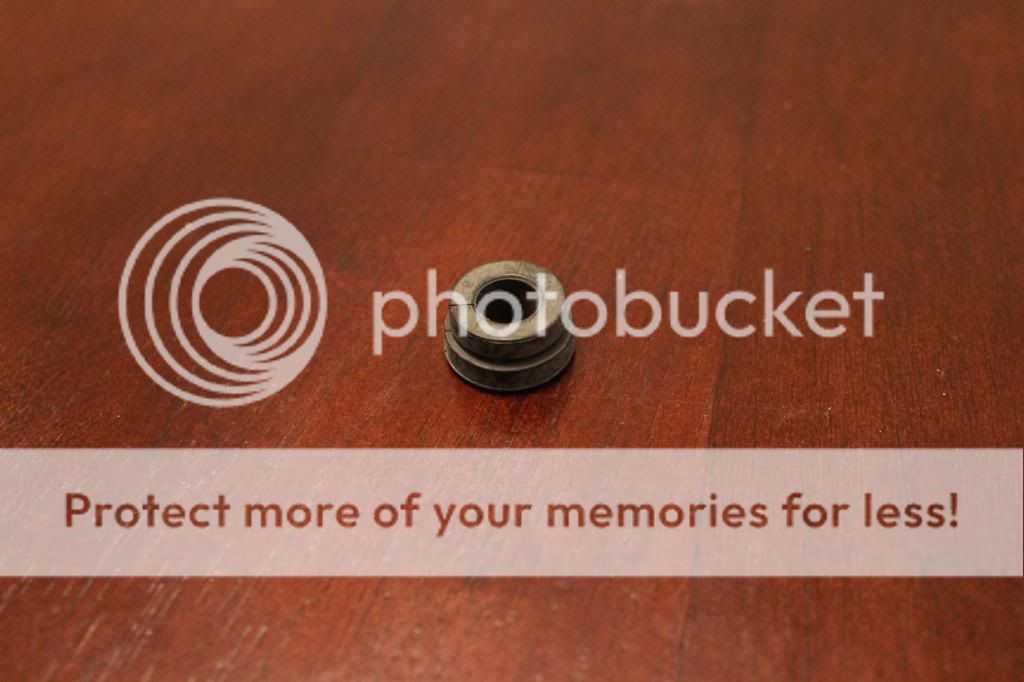

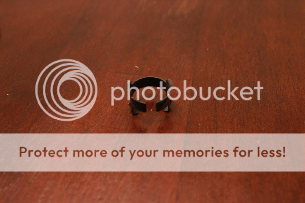

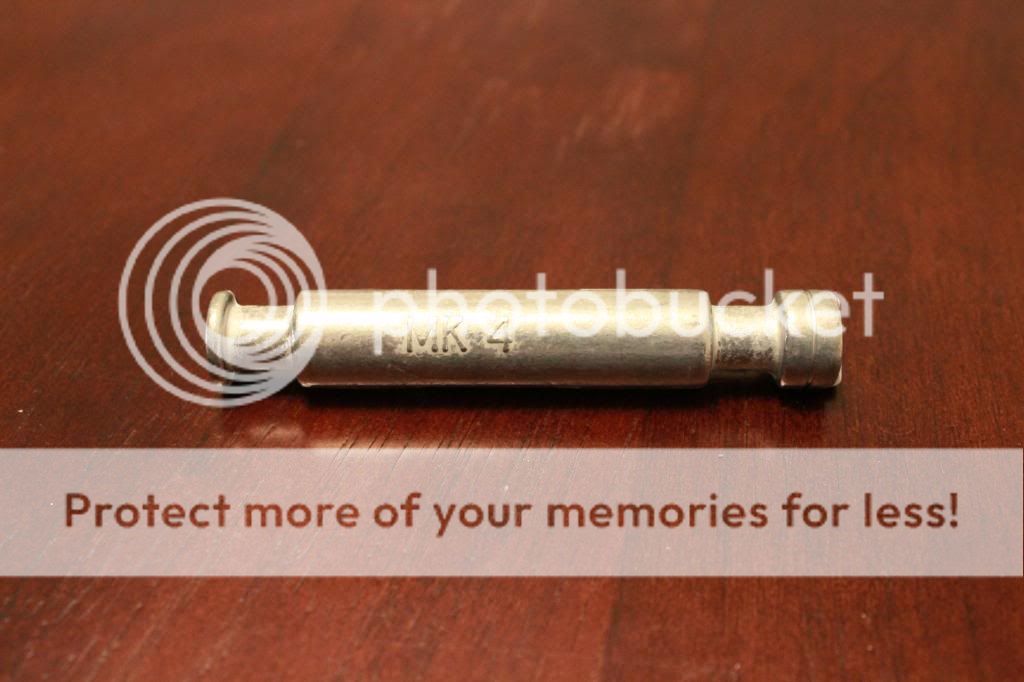

Yes, you can "spin" the bar ends. Actually, you are spinning the weight inside the bar as well. As long as the screw spins as well, you are fine because the entire thing is spinning as a whole. I wouldn't do it too much though because the clip (Part #11) might cut into the rubber bushing (Part #10). Most likely not but you never know.

I like how you took a picture of every detail. Well done. I guess you just got a new camera.
Thanks. This lens isn't that great for close ups...with 1 hand.... lol. We've had it for about a year. One of my summer classes this year is a camera class so hopefully I can learn a few more things other than what I've self-taught myself.

I just wanted to update that these are still going strong. I really like these over the cheesy aftermarket ones. Less vibration and the bar end is solid. I can still spin the bar end, but it never comes off.

I've seen a few posts popping up lately with questions on the bar weights inside our bar ends. Hope this helps a few of these people.

Thanks. I used to hate looking down all the time to see if the bar ends were still there. Haven't thought about it once since I installed the OEM bar weights. They are the perfect anchor for bar ends.

Thanks! The internal bar weights really adds some rigidness to the bar ends. They don't bend at all, just spin.
